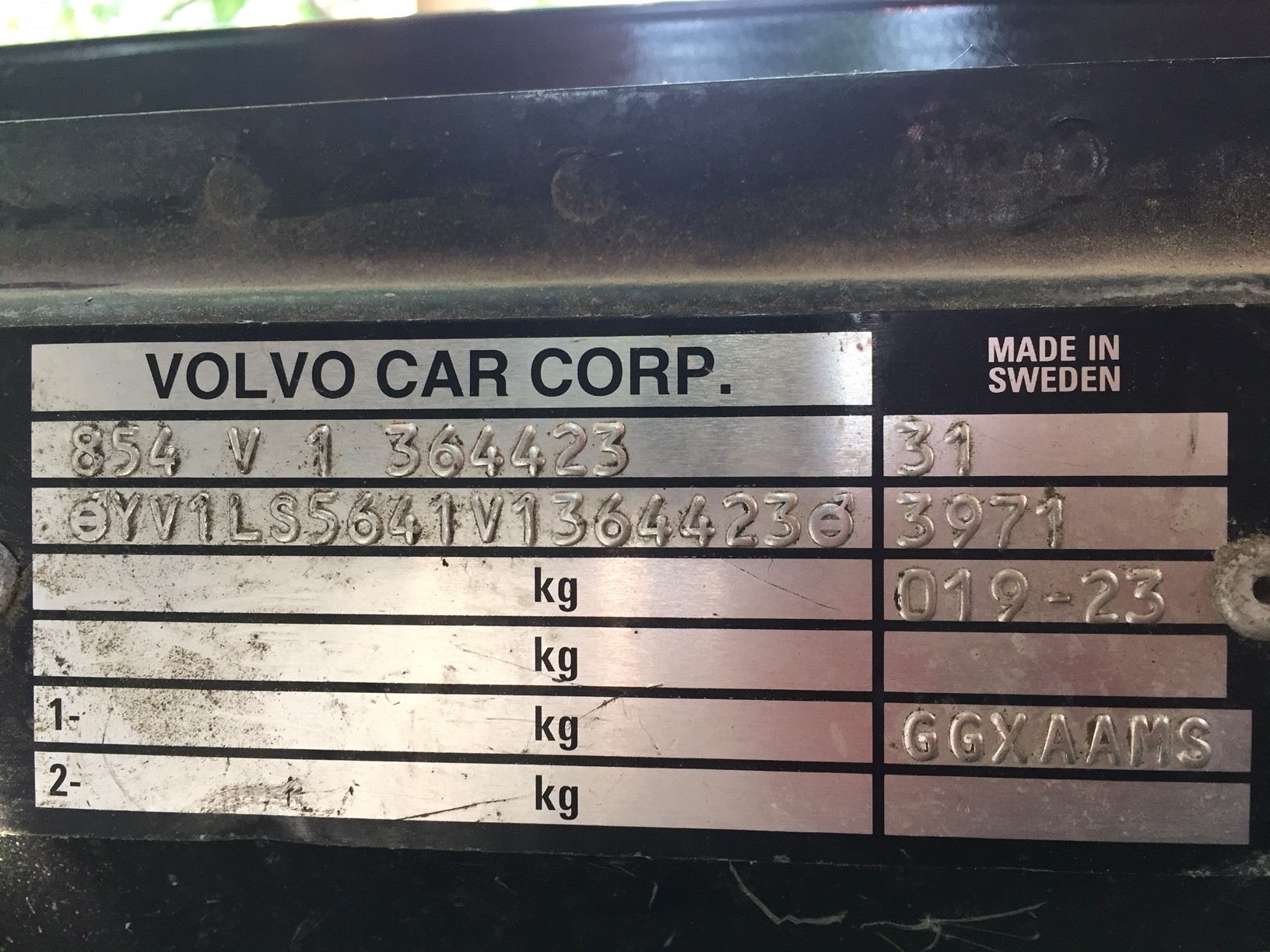

About using the product pate code: (e.g. see https://www.ipdusa.com/products/5800/11 ... 8-2004-c70)
If that section of the product ID has 7 digits, then the car came with a TRW rack.
If that section of the product ID has 8 digits, then the car came with a TRW rack UNLESS in position 8 there is a 5, which would mean SMI.
Keep in mind that even if a car came with a certain rack, there is no guarantee of what is in there now. Best way is to just look at the rack.

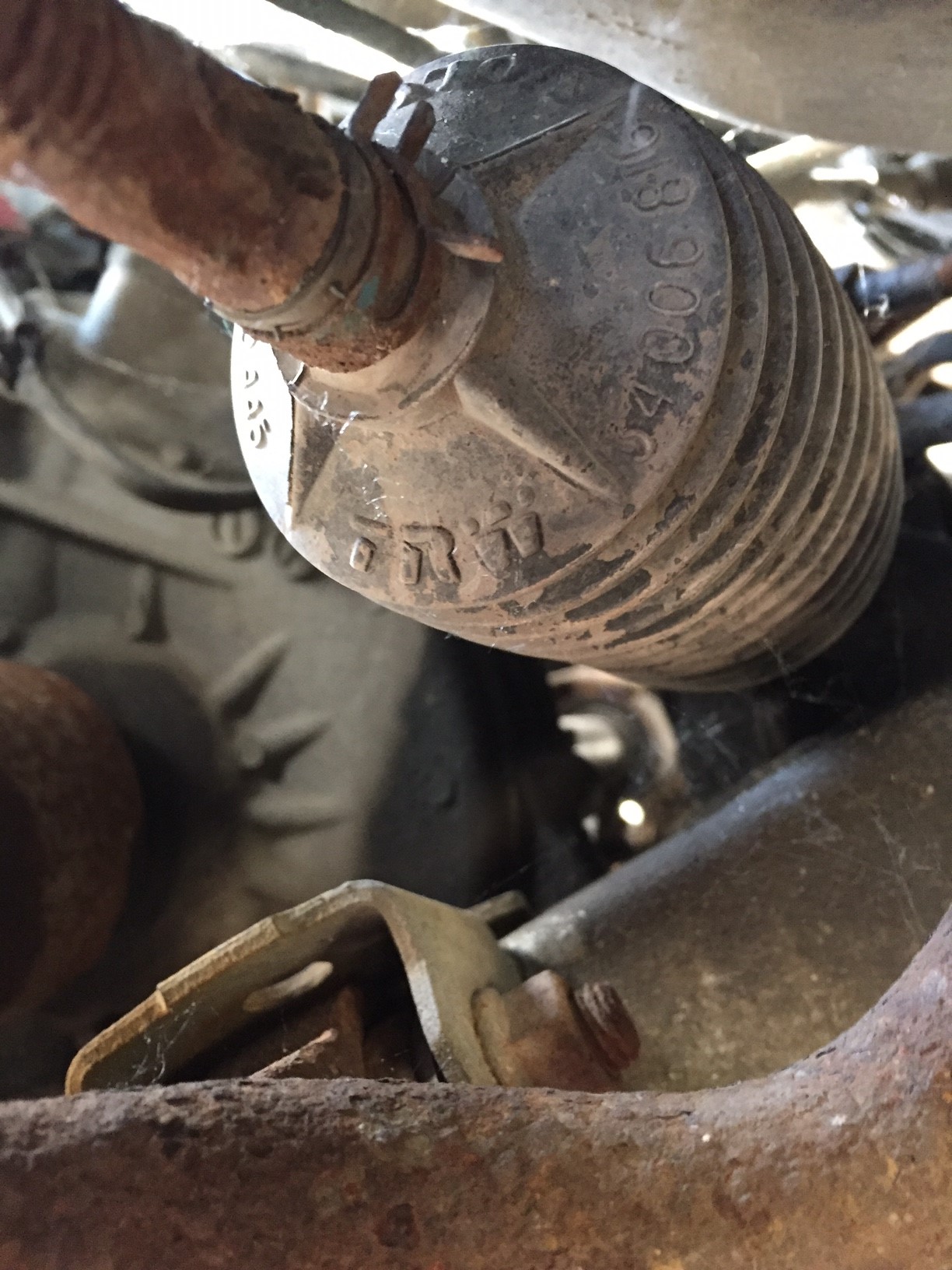

- TRW racks say "TRW" on the boots (see pic).

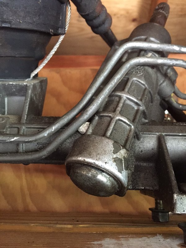

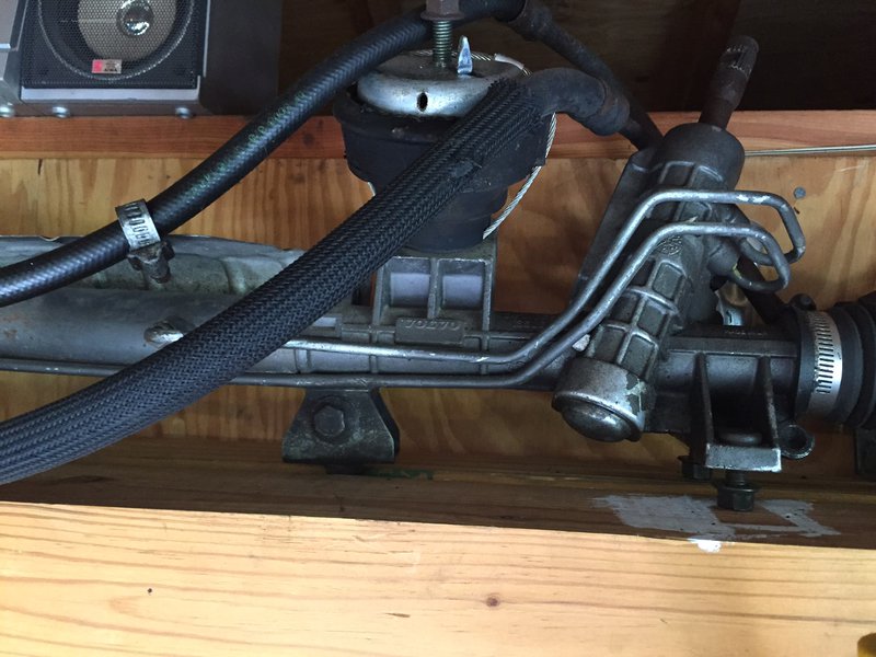

- SMI racks have a hex nut on the cap under the steering gear, TRW racks have a rounded cap (see pics). I learned this from Jorgen automotive, the tech on the phone instantly knew to ask me the shape of the cap, I recommend them highly for rack rebuilding.
I don't have images of SMI racks, only TRW ones, because all of my 850s have had TRW racks. If someone could snap a pic of a the hex cap on an SMI rack and add it to this thread, that would help a lot.

The chassis plate should show an eight digit long alphanumeric string at the lower right side of the plate. You can't miss it. The last number will be a 4 or a 5. If the string is only seven digits long, it's a TRW rack. I just did my outer tie rods and boots on my SMI (read code-5) rack. By the way, the Volvo Genuine parts that came out of the Volvo bag for my SMI rack were manufactured by and marked TRW. Don't let that confuse you.

It is difficult to read my data plate so I just did a rubbing with a piece of paper and a lead pencil. I clearly have a 7 digit number. Its either 4F2PEV5 or 4F2PEVS. I rubbed it twice and the last digit is almost certainly an S as in SAM. What I understand is seven digits means TRW and the value of the last digit is irrelevant so it doesn't matter that it might be a 5.
So, I conclude from what's posted here that its a TRW rack. Correct?
However, from what I can see the boot does not say TRW on it. I guess I'll just wait to order my tie-rod parts until I can get a close look at it with the wheel off this weekend. I bought the car used and have no idea what the maintenance history has been before I got it 6 years ago.

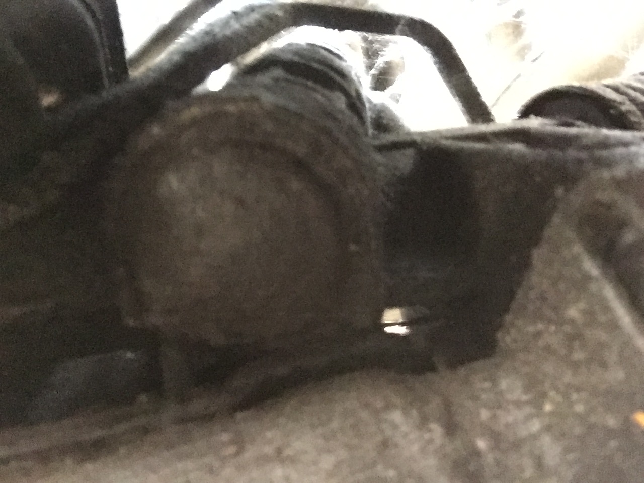

Here is the image you requested. This is an SMI rack on a '99 S70 produced August 1998. I took this six hours ago while installing poly iPd subframe inserts. A most excellent bang for the buck upgrade, by the way.

v-45magna wrote:Here is the image you requested. This is an SMI rack on a '99 S70 produced August 1998. I took this six hours ago while installing poly iPd subframe inserts. A most excellent bang for the buck upgrade, by the way.
I wouldn't let that be a factor. These cars are all getting really old. Isn't it possible the boots have been replaced before? You have done more than the due diligence to make sure what parts to order. So order 'em.98v70dad wrote:... from what I can see the boot does not say TRW on it.
Thanks. I appreciate the picture. Now I will be able to positively ID what rack I have when I look at it.
