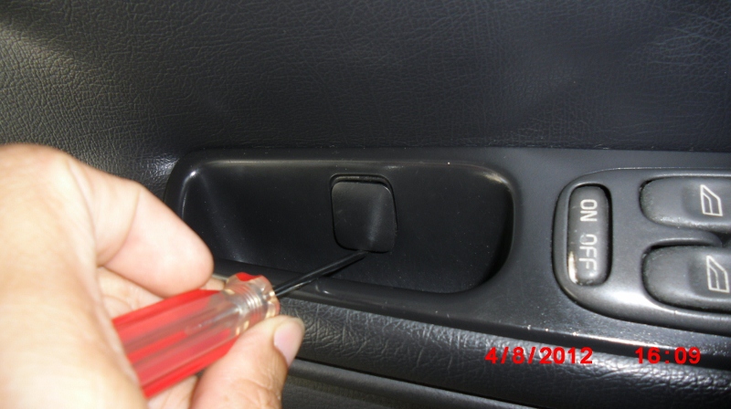

Use a small flat-blade screwdriver to pop off the screw cover of the interior door trim of a 1998 V70 XC.
CIMG1925 (800x448).jpg (209.43 KiB) Viewed 1955 times

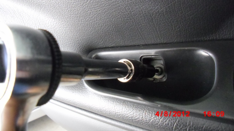

Removing T20 screw off the interior door trim of a 1998 V70 XC. Now is a good time to pop off the master window switch.
CIMG1926 (800x448).jpg (223.21 KiB) Viewed 1955 times

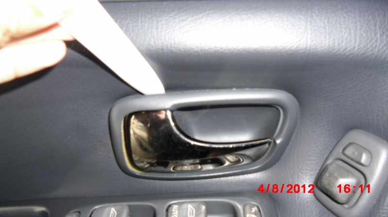

Popping off door handle trim of a 1998 V70 XC using a bone tool. Follow the order in the factory instruction.
CIMG1927 (800x448).jpg (187.52 KiB) Viewed 1955 times

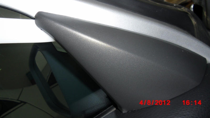

Popping off side view mirror interior trim of a 1998 V70 XC using a bone tool.
CIMG1928 (800x448).jpg (181.68 KiB) Viewed 1955 times

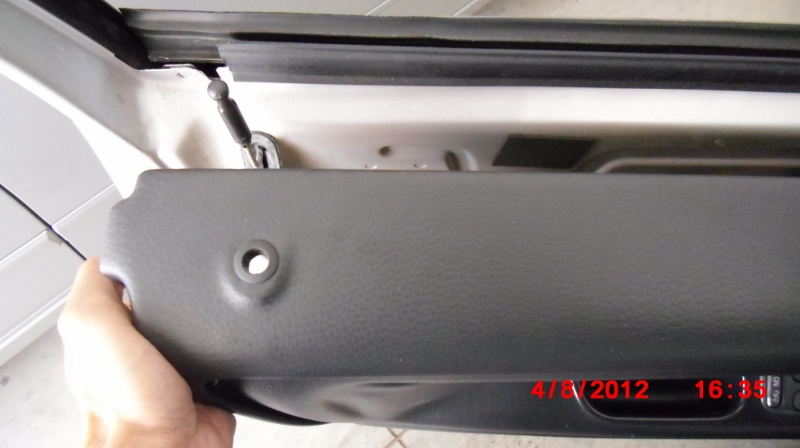

Lifting interior door trim of a 1998 V70 XC over lock pin. Took a bit of force to pull trim off the edge of the window gap.
CIMG1931 (800x448).jpg (193.35 KiB) Viewed 1955 times

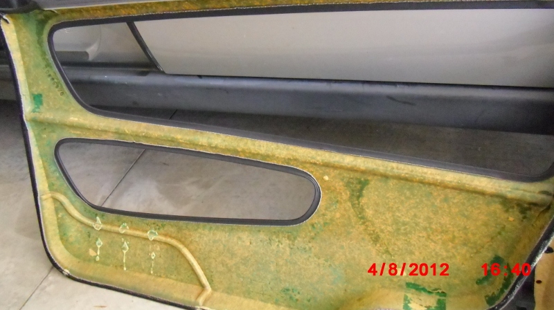

First half of 1998 V70 XC interior door trim. Plastic pieces that held some trip clips broke off years ago.
CIMG1934 (800x448).jpg (257.54 KiB) Viewed 1955 times

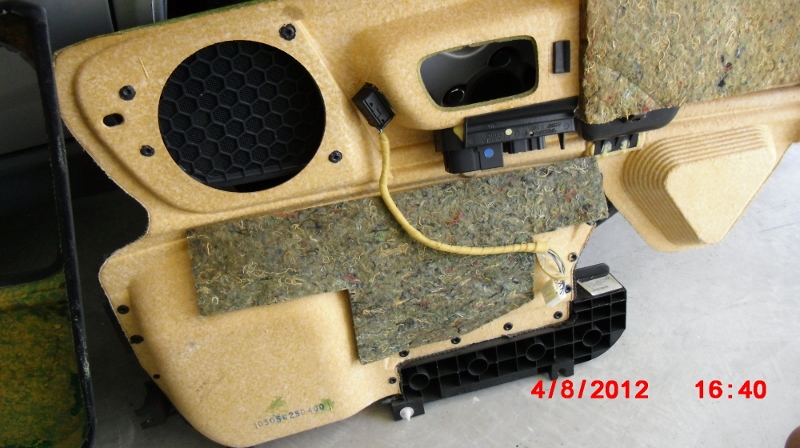

Second half of a 1998 V70 XC driver's door interior trim. Factory glue failed.
CIMG1935 (800x448).jpg (221.91 KiB) Viewed 1955 times

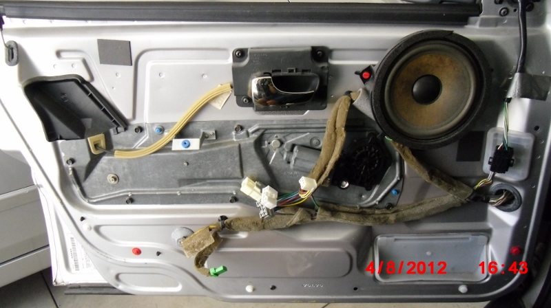

1998 V70 XC driver's door without interior trim. Look at the lousy OEM foam cable coverings!
CIMG1936 (800x448).jpg (225.82 KiB) Viewed 1955 times

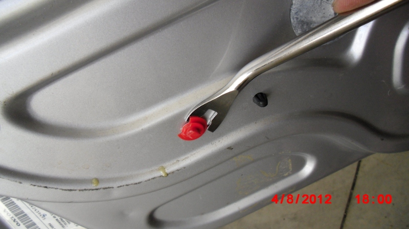

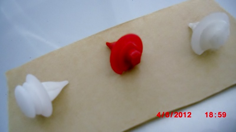

Removing broken interior door trim clips. Some were already broken, some broke while removing the trim.
CIMG1941 (800x448).jpg (200.9 KiB) Viewed 1955 times
1998 V70 XC interior door trim clips. New one on left, old broken ones on right. Have a bagful handy.
CIMG1943 (800x448).jpg (77.26 KiB) Viewed 1955 times

"1998 V70 XC interior door trim clips. New one on left, old broken ones on right. Have a bagful handy."
I could use a bagful of these. Any advice on where to buy?
FCP wants $2.99...EACH!
I searched a bit here and on Google and haven't found these in bulk yet.
