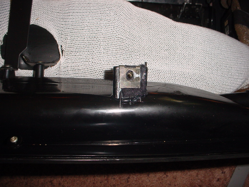

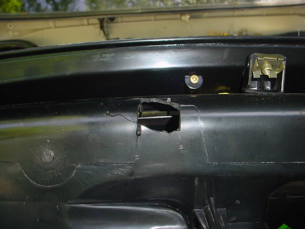

After getting the dashboard out of the car the problems were obvious. Here are pictures of the broken mounts.
Fortunately all of the pieces were there so I set off to the local Lowes to pick up some epoxy and some fiberglass and resin thinking that the joints would need more than just the epoxy glue job. The epoxy I used was a Loctite 5 minute epoxy that said it worked with plastics. After 24 hours it felt very strong but I still wasn't convinced it would hold up.
Here is a mount after it was glued back on.

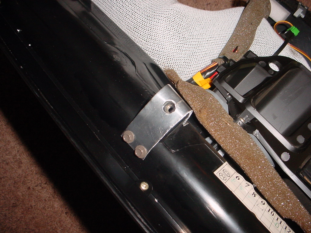

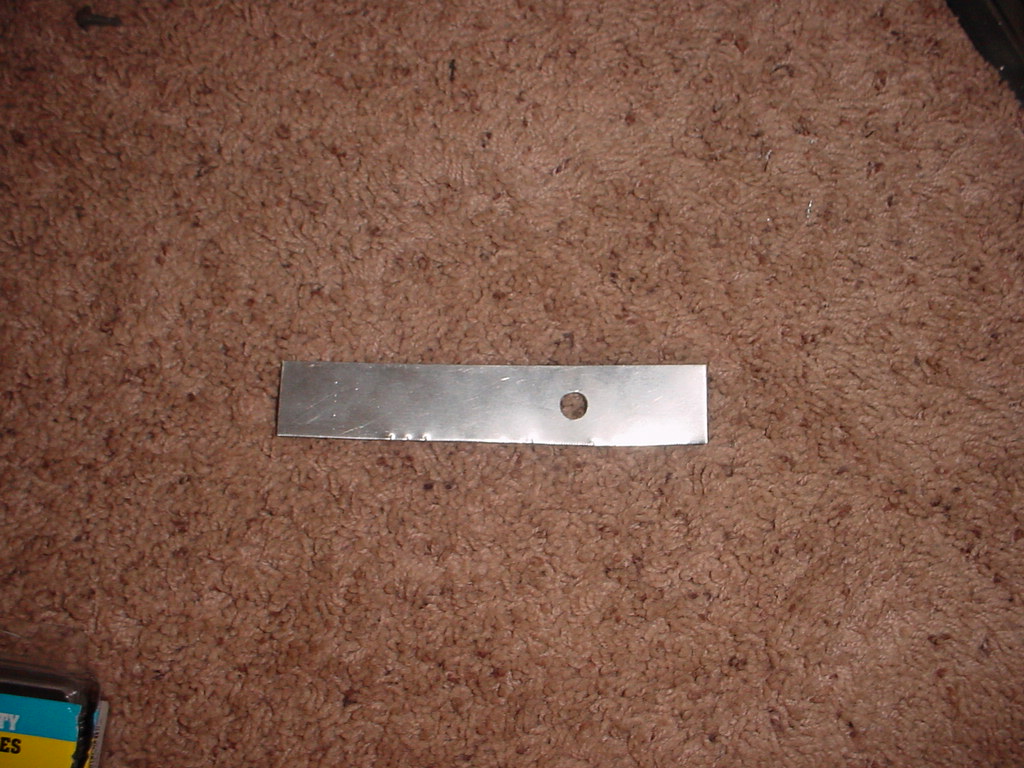

I picked up a strip of 0.025 thick aluminum sheet metal at the Lowes store as well as some self tapping screws. In my case the aluminum came in a 6" x 18" panel. I measured the factory mounts and found that they were right at 1 1/8" wide so I cut out 4 strips of aluminum 6" (15.2 cm) long by 1 1/8" (2.85 cm) wide. I then stacked all 4 of them together in a vice and drilled a 3/8" (9.5 mm) hole, centered 2" (5 cm) from the end, through all of them at once. Drilling though sheet metal is tricky since it was to catch at the end and wrap around the drill bit. By clamping them all together they get more rigidity.
Here is a picture of the straps.

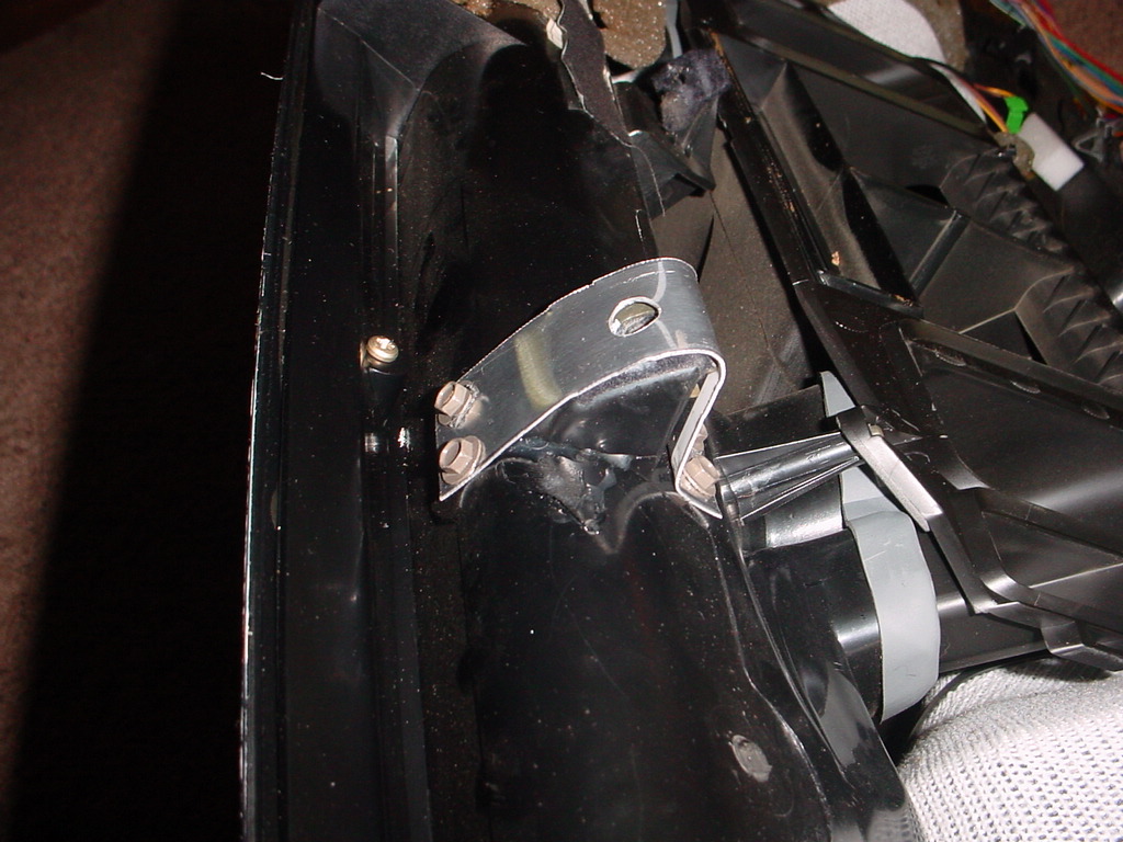

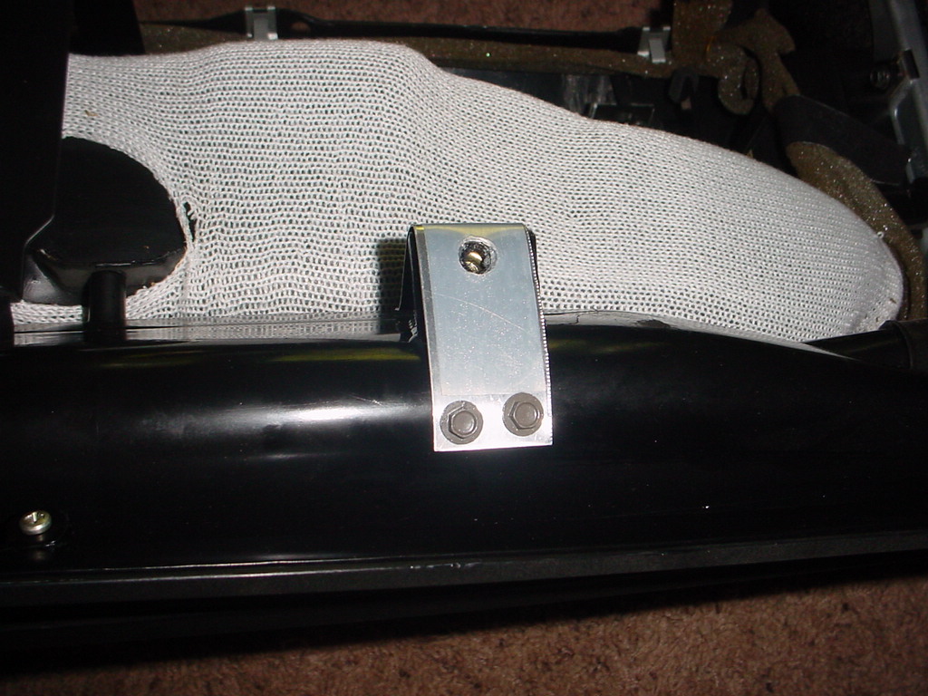

From here it is a matter of lining the factory mount hole up with the hole in the strap. The will wind up being to long but I mounted them from the front first. The short side of the metal from the hole should go toward the front of the dash. I then shot in two self drilling screws through the aluminum and into the plastic. Be careful here not to strip out the hole. I then folded the strip over the mounts and trimmed the metal to fit. The center mounts are different from the end mounts so they use a slightly different length of the strip on the back side.
Here are a couple of pictures that show the strips in place.
The guys on VSP used some thin foam tape to cover the metal straps but I couldn't find an equivalent product. Having three 850's I long ago bought some 3M squeak reduction tape. It is a self adhesive Teflon tape that goes between squeaky joints. I found it through NAPA auto parts. Here is a picture of the box.
I used the tape to cover the aluminum strips and so far so good, no more dashboard noise at all.
With the drying time on the epoxy and further just to keep your sanity this is a 2 day job. If you are doing the evaporator anyway it will only add an hour or so. Only two of my mounts were broken but I reinforced all four of them as a preventative measure.
Here is the finished product.

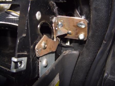

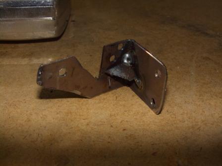

Hey guys I've really found an easy fix. Takes probable an hour (and not two days) In reguards to akitawagon's quote [quote="akitawagon"][quote="Ozark Lee"]
"I was trying to think of some sort of screw to bring it back together and still look good."
I made an L shaped bracket that mounts to the right side of the dash and screws in twice to the front of the door jamb. There is a very small amount of trimming the dash. I'm having trouble getting pics on my computer but will ASAP. It worked wonderfully for me and I'm sure it will for your dash too. I'm thinkin $25 should cover the cost of materials, labor, and shipping. I'm really not trying to make money, just HATED the squeek and would like to relieve some of you of your sqeek. Drop me an e-mail at [email protected]

So here's a couple pics of my first dash fix thingy. Any others I make will look better (firsts in fabrication never look too pretty and I'll spray it black to prevent rust.
- A little modification and it shuts up the sqeeky monster under your dash.
- CIMG5851.JPG (44.43 KiB) Viewed 30064 times
- CIMG5852.JPG (50.43 KiB) Viewed 30081 times
