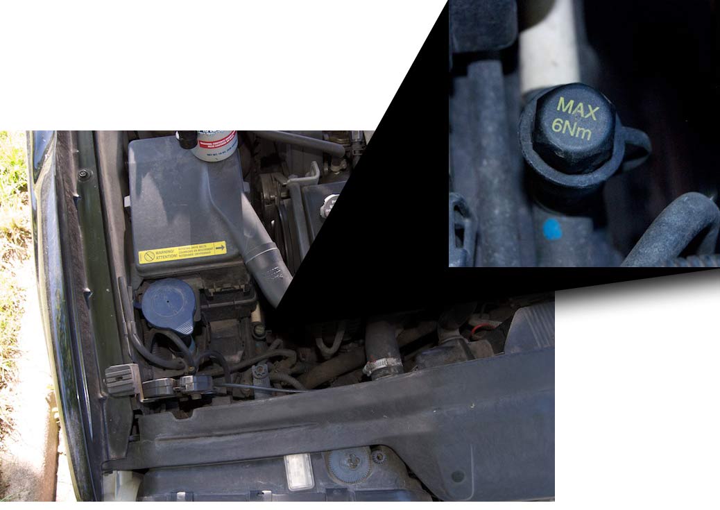

Sounds like you're doing things right. Just to be sure:
- AC low port location Volvo 850
- ac-port-volvo-850-_DSC7677.jpg (67.75 KiB) Viewed 7342 times
