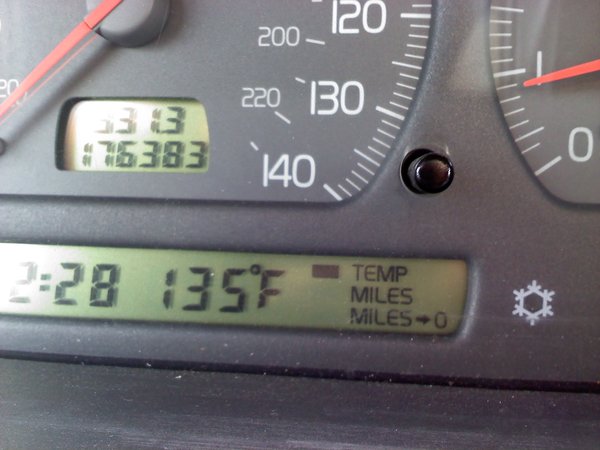

(If I leave mine on temp, it just shows ridiculous numbers). I should just replace the sensor, but its kinda fun seeing the numbers it'll show!
