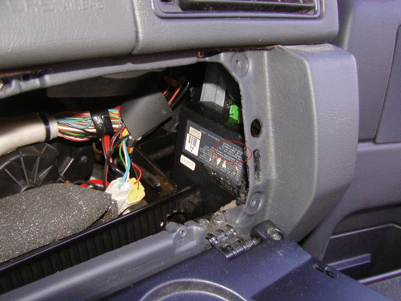

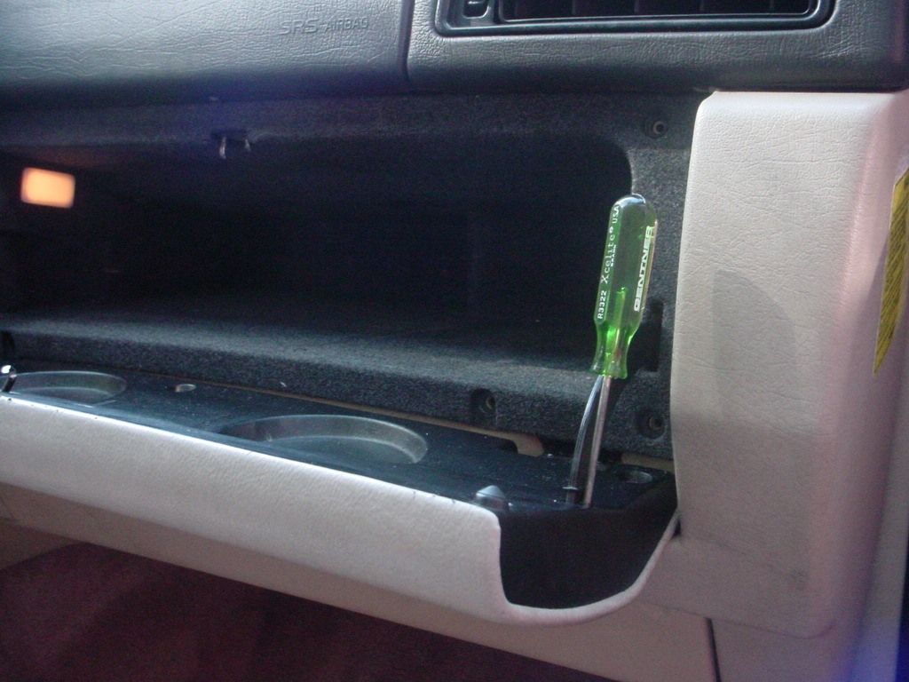

As optioned as your car sounds there is a very good chance that it originally came with a remote. The way to tell for sure is to remove the glove box and look directly to the right, along the A pillar to see if the receiver box is there.
The glove box comes out easily (If it actually still opens at all), the only real trick is releasing the arms that hold the door. Use a small screwdriver or something similar to release the arms through the holes next to the arm mounts.
The receiver looks like this:
remote receiver.jpg (111.01 KiB) Viewed 4926 times
The one pictured is actually upside down from the normal mounting. If you have such a receiver you need to jot down the part number and the FCC identifier so that you can get the correct remote. The numbers you need to look at are circled.
The eBay sellers all claim that their remotes work for all 850s from '93 to '97, they don't. You will need to get the one with the correct numbers for it to work.
If you have a receiver post back the part number and the FCC number and I will get you the correct part number and FCC number for the remote.

Hey Lee, I have a 95 850 and I found the receiver as well.
p/n 3545654
FCC ID CWT5654R
Any help would be great, thanks

You need the 5653T remote.
Her is a link to one currently on eBay.
http://cgi.ebay.com/ebaymotors/Remote-F ... 335721816a
