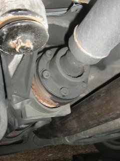

WeAre06 is right, the driveshaft is easily seen and reached either on a rack or ramps. Here's a picture of the rear section of it.
v70 awd driveshaft.jpg (18.02 KiB) Viewed 15726 times
