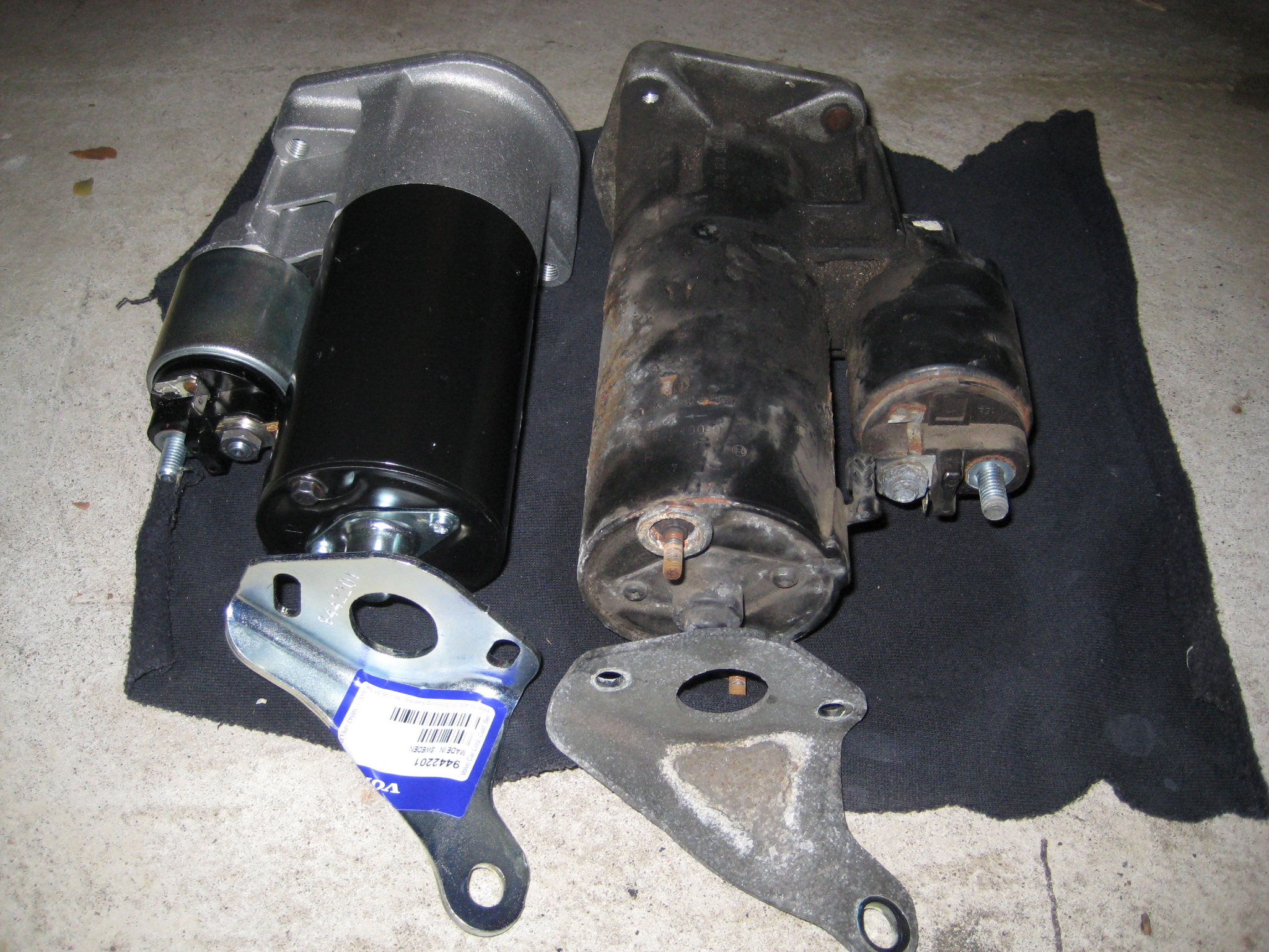

Around $200, the newer type (p/n 8111302, only one volvo dealer sells now) is about 1/2" shorter than the older type (p/n 5003918). Note: for the shorter one, it does not need the mounting bracket only 2 bolts to the engine block.E Showell wrote:How much should I expect to pay for a rebuilt starter?

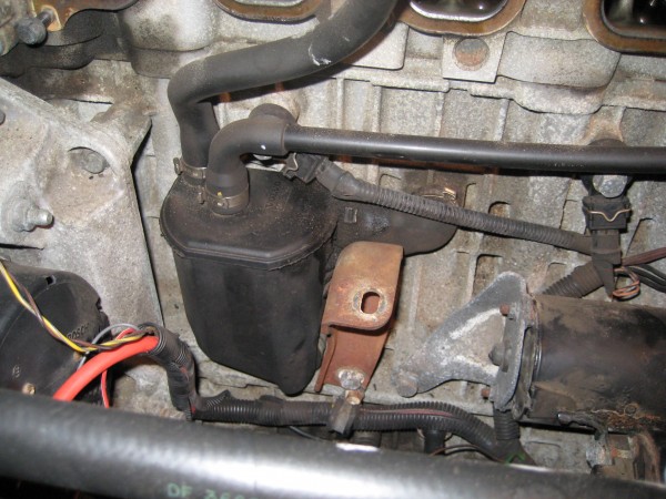

Oh, I found another pic might be helpful, which give you the view of the bracket. Only one bolt to the engine block.
