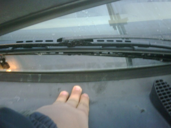

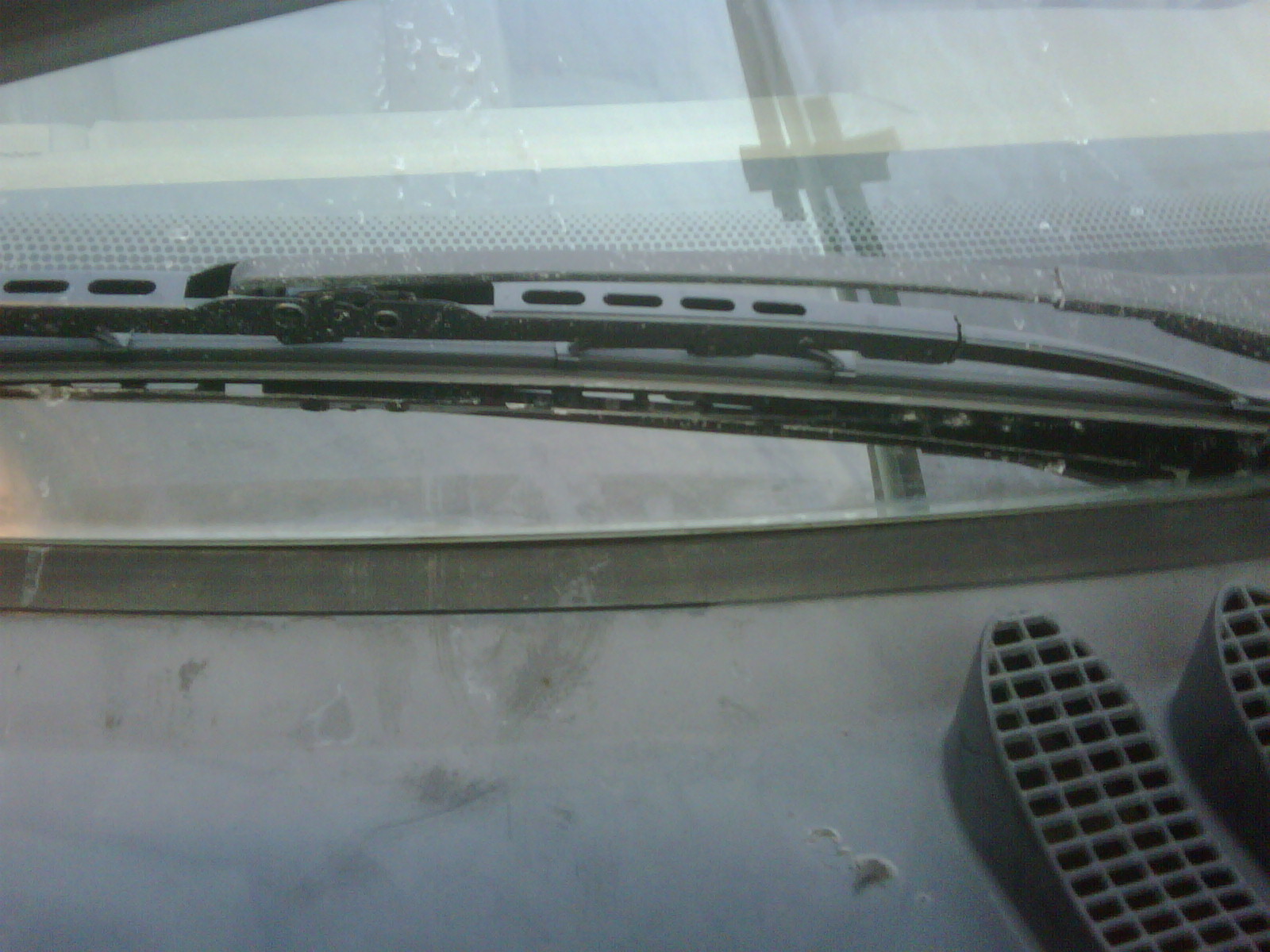

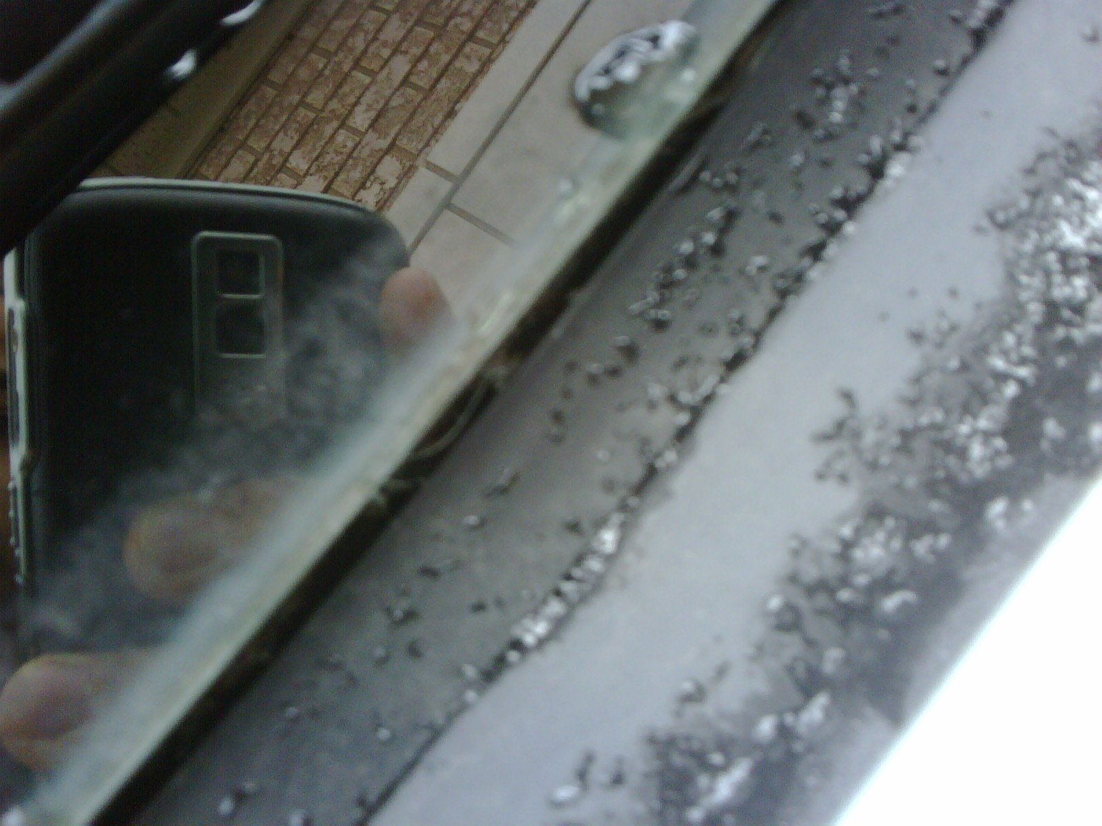

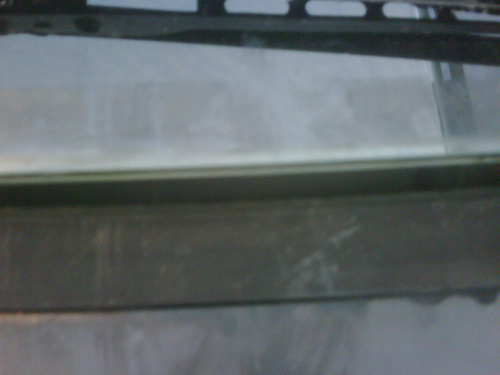

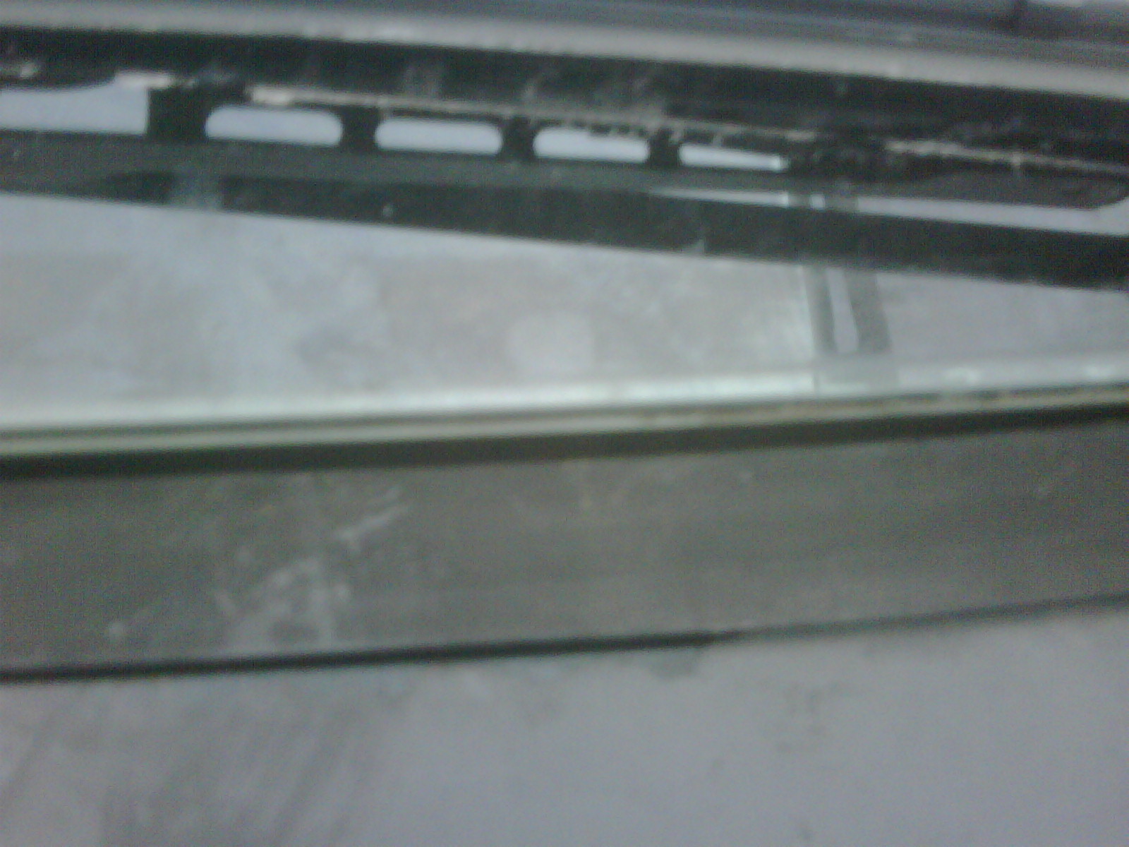

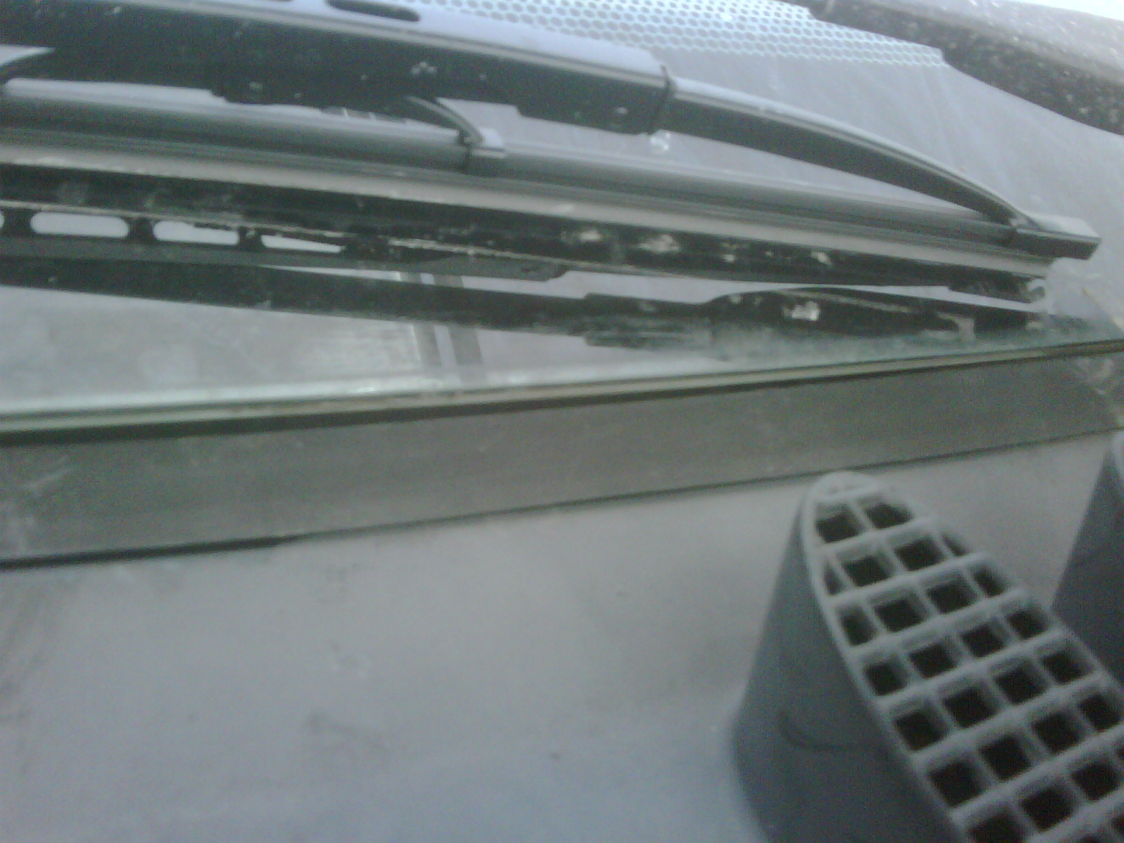

Hi Folks,
As of the past 6 months I've had some wind noise while driving on the highway( more than normal ). I knew the top molding was missing and I figured that that was the source of the extra wind noise. I called IPD to buy the part, as luck had it ,they didn't stock the mold(or mold cover...I'm not too sure). They recommended I go the stealer for it. The fellow on the phone happened to also be a Volvo owner(s70 to be exact). I explained the noises I was getting and the missing top windshield mold cover. He told me he was missing the same exact part...only he didn't have the noises.
I put off the purchase...(70 dollar mold..no thank you!!!)...I figured a junkyard would do just fine...especially for a mold.
Well guess what...now I'm especially glad I didn't buy it...it's the windshield bottom that has to be fixed(the one that I'm 90 % sure is causing me the highway wind noise). It's coming loose...and the base of the windshield is exposed...no longer being covered by the mold.
A picture is worth a thousand words...I took a few...so a few thousand words...haha...I was thinking of going to home depot...but maybe that's the wrong way to go about fixing this.

The molding doesn't seal the windshield, the windshield is glued in, however I suppose a piece of loose trim could make a noise. Use masking tape on small sections at a time covering them up and you'll find the source.

Hi Cattledog,
You are right about it not sealing the windshield. I think the noise is coming from wind blowing between the mold and the windshield. I wanted to glue it back together but I'm not sure what to use or if that's the best way forward.

Sadly you are looking at going to a glass shop. You might try to gob some silicone sealer around the offending leak but it won't last. Ultimately the windshield needs to be removed and re-sealed if it is actually leaking.

...perhaps from a hack windshield install?
pretty sure the moulding is supposed to be glued to the windshield before it is installed. The cowling slips into a slot in the windshield molding.
i would remove the wiper arms, then the cowling (the big plastic cover that you're touching in pic#3). seperate the moulding from the cowling and see if you can re-attach the moulding to the windshield with some silicone, I don't know if you can, the windshield may need to be out the car. If you can't get it on, then you might have to go to an auto glass place and have them pop it out and re-install it correctly.
once the moulding is attached to the windshield , just pop the cowling into it and bolt everything back up.

My apologies Ozark Lee and Larryh...the camera I have is defiantly not the best...if it were better you would be able to see more clearly.
To be completely clear:
There is absolutely no leak into the car...not water and not even smoke ( a smoker pal recently blew in to it and no smoke entered the cabin). The mounding you see pictured(the one that is bad)...does not seal the window...it's more of a loose trim... With the highway wind(I am assuming)...causes some noise because wind blows between this loose trim and the windshield..
The black piece you see pictured just slides into the windshield...nothing fancy
I was thinking of gluing it back in...but didn't know what to use....
