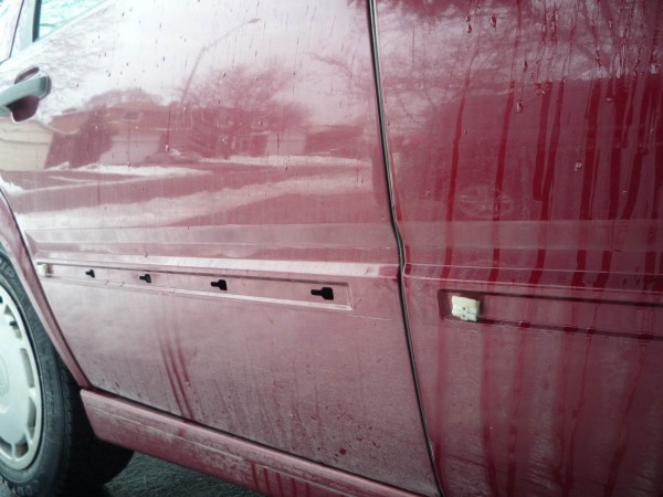

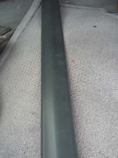

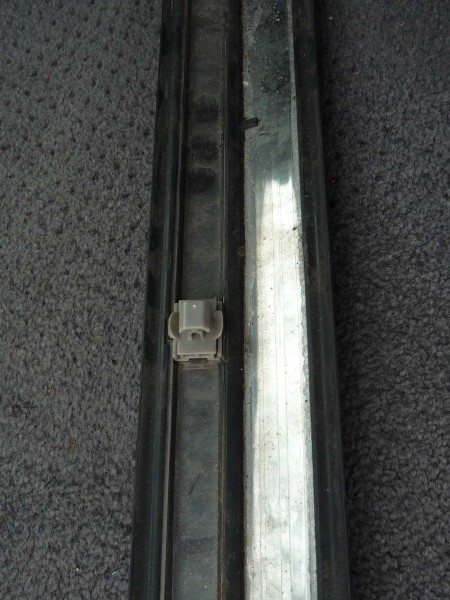

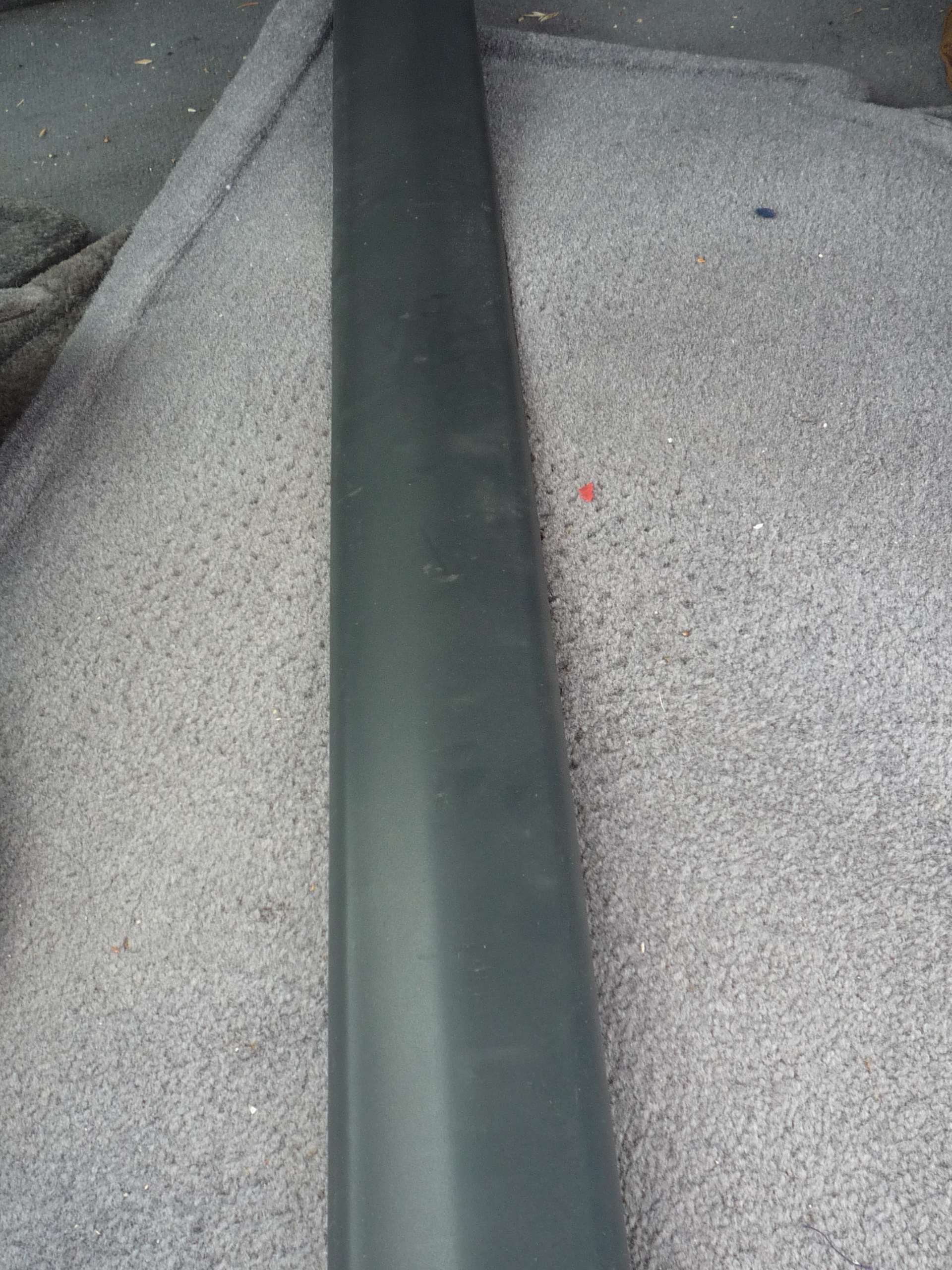

Below there are six pictures depicting my Volvo and the result of the car being a loaner
There is no double sided tape only clips. My model at least!!!
The front quarter panel has clips that just push in, these broke off and pushed all the other trim back. I have tried to connect the trim back on the car and have found that there are a few things that need to be considered.
1) The clips need to be on the trim and not the car.
2) Open the doors. All the clips except the last will be slid into place from the front of the door to the back. Before pushing in the last clip check the alignment of the trim in relation to the door opening and closing and the other trim. If it is out you will have concertina effect and the trim will pop off. Once in place the last clip, closest to the back of each door will be the last to be inserted or pushed into place. The doors need to be open.... once the trim is on you may have to
3) Get new clips all round
4) Work in a heated garage or wait until the weather gets kinder so the parts are not to rigid in cold weather.
To remove:
So in summation, either let your kid drive the car or gently pry off the rear section of the trim being careful not to bend the trim, and then slide the trim forward and it should come right out. Be prepared to break a few clips, you may also find that the clips come away from the trim and stay on the car.
