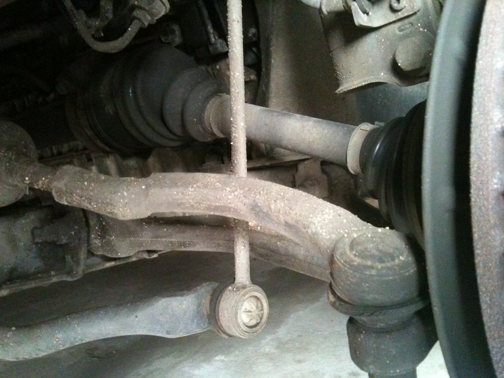

Thanks guys. I took some pics, and yes it looks like the control arm bushing is shot.
I'll take the wheel off again soon and inspect closer.

Justin, can I replace only the bushing?
Also -> Amazon link
jblackburn
Posts: 14043
Joined: 8 June 2008
Year and Model: 1998 S70 T5
Location: Alexandria, VA
Has thanked: 9 times
Been thanked: 19 times
Post by jblackburn »
Yep! There's no need to replace the whole thing unless the arm's bent or the ball joints are shot.
