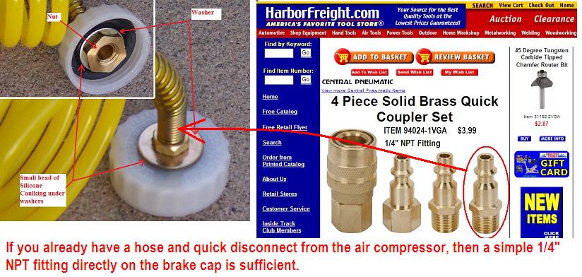

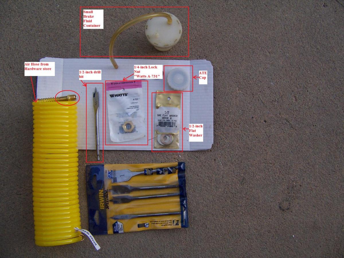

1. To make my DIY cap-hose combination:
- ATE Brake Reservoir Cap from FCP Groton or local Volvo dealer; Volvo PN 1272107, used in many Volvo cars since 1960's through 1990's ($5.00):
http://www.fcpgroton.com/search.php?nod ... rm=1272107
- You can simply buy a 1/4" NPT fitting for $0.50 (or buy a kit for $3.99 at Harbor Freight) and attach it directly to the brake cap:
- 1/4-inch nut ($1.00)
- 1/2-inch washers ($1.00)
- Drill a 1/2-inch hole in the ATE cap and clean any debris.
- Insert 1/4" NPT fitting into the cap, washer on both sides.
- Small bead of Silicone under each washer and the hose male end's threads.
- Tighten the 1/4-inch nut hand tight.
- Let the Silicone Caulk cure for one day before using it.
