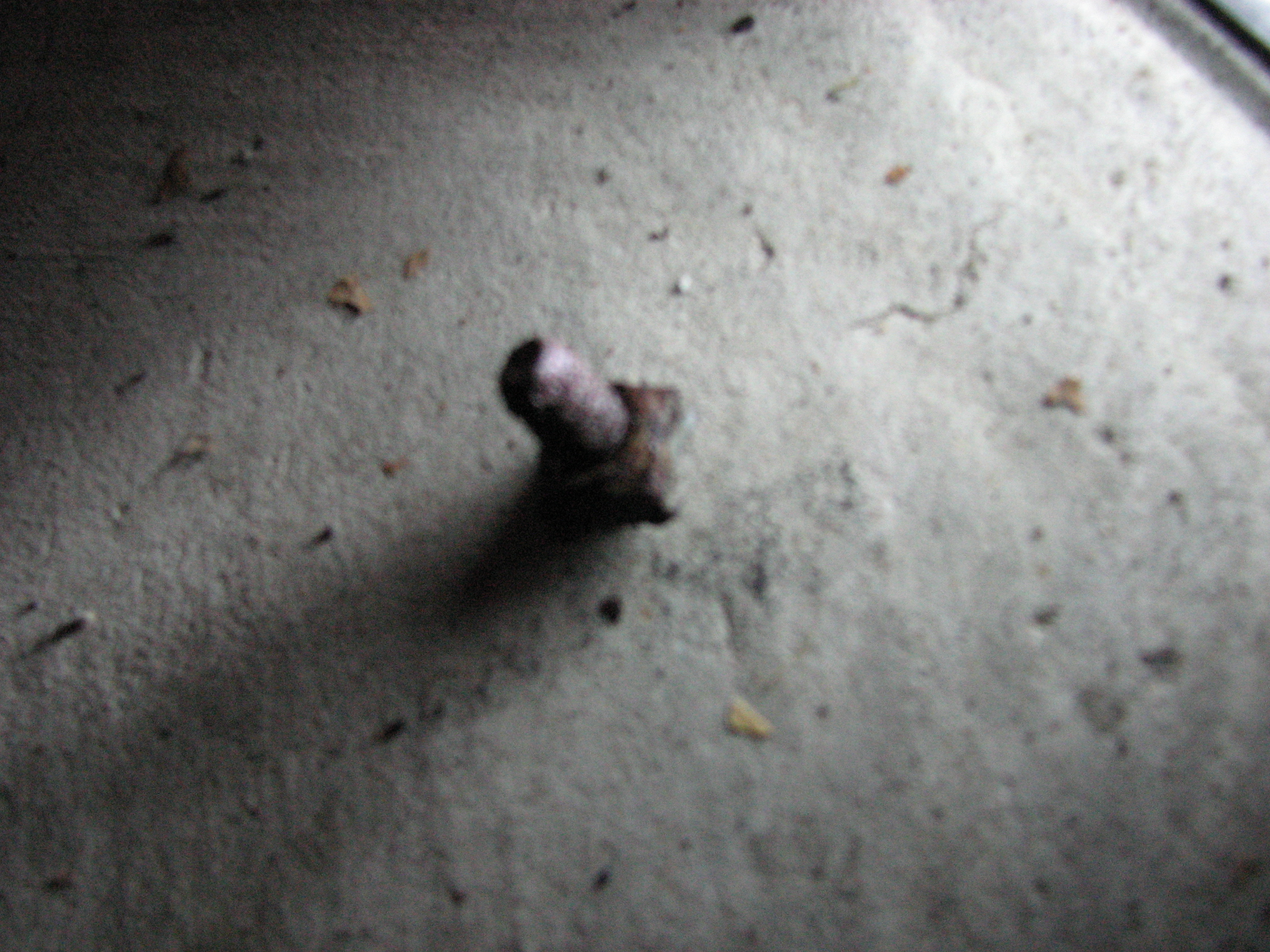

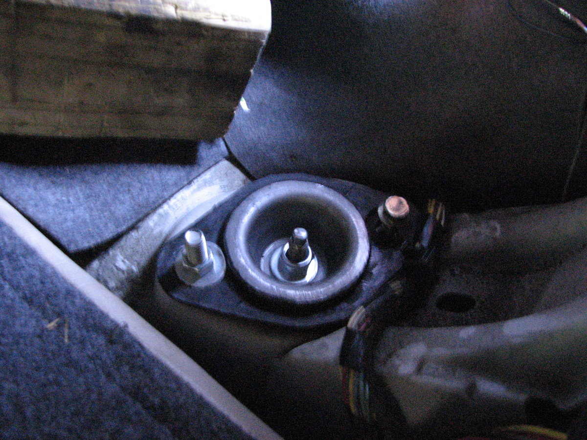

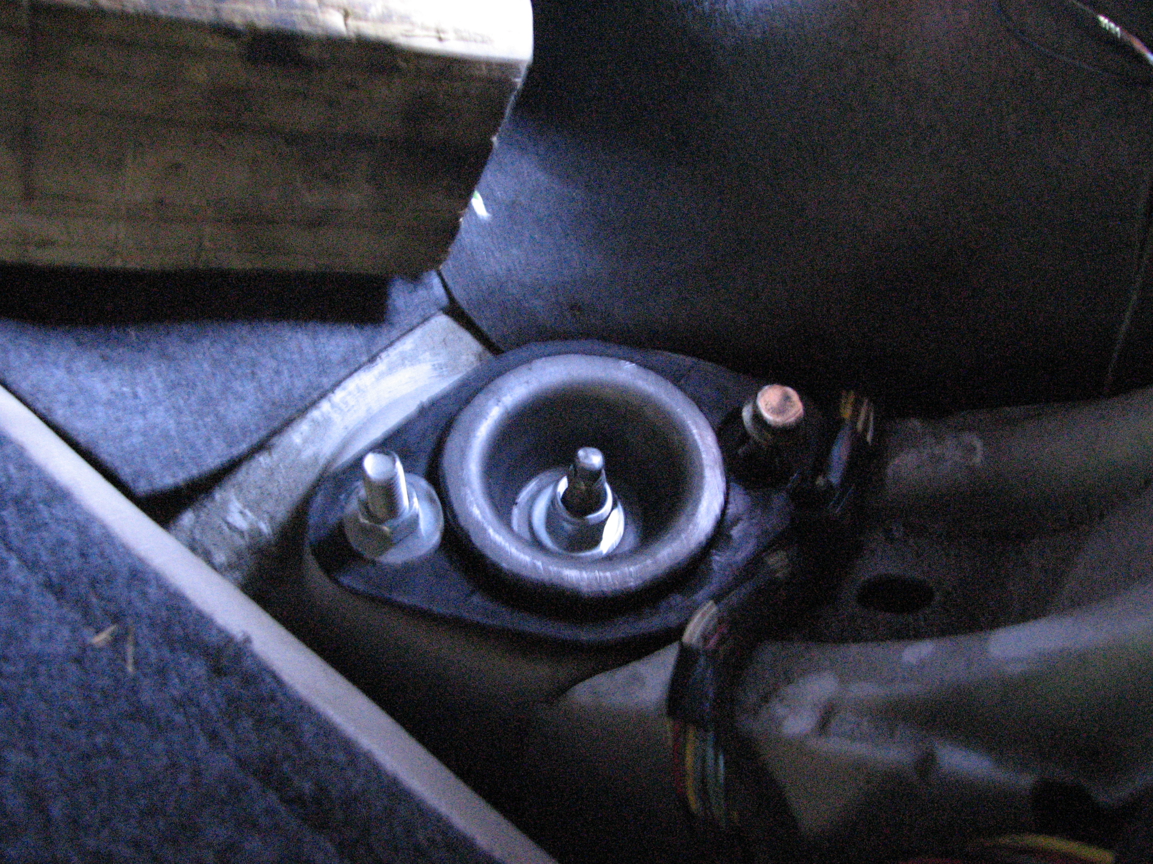

This is a write up for the replacement of rear shock absorbers on an 850 sedan. Before doing this repair I would suggest you let the car sit for at least a night with PB Blaster or WD-40 sprayed on the shock mount bolts and the lower shock to trailing arm bolt. I broke one of the shock mount bolts and I spent the entire weekend trying to get it out. I eventually had to drive it to a mechanic with only one shock mount bolt in place on the passenger side!

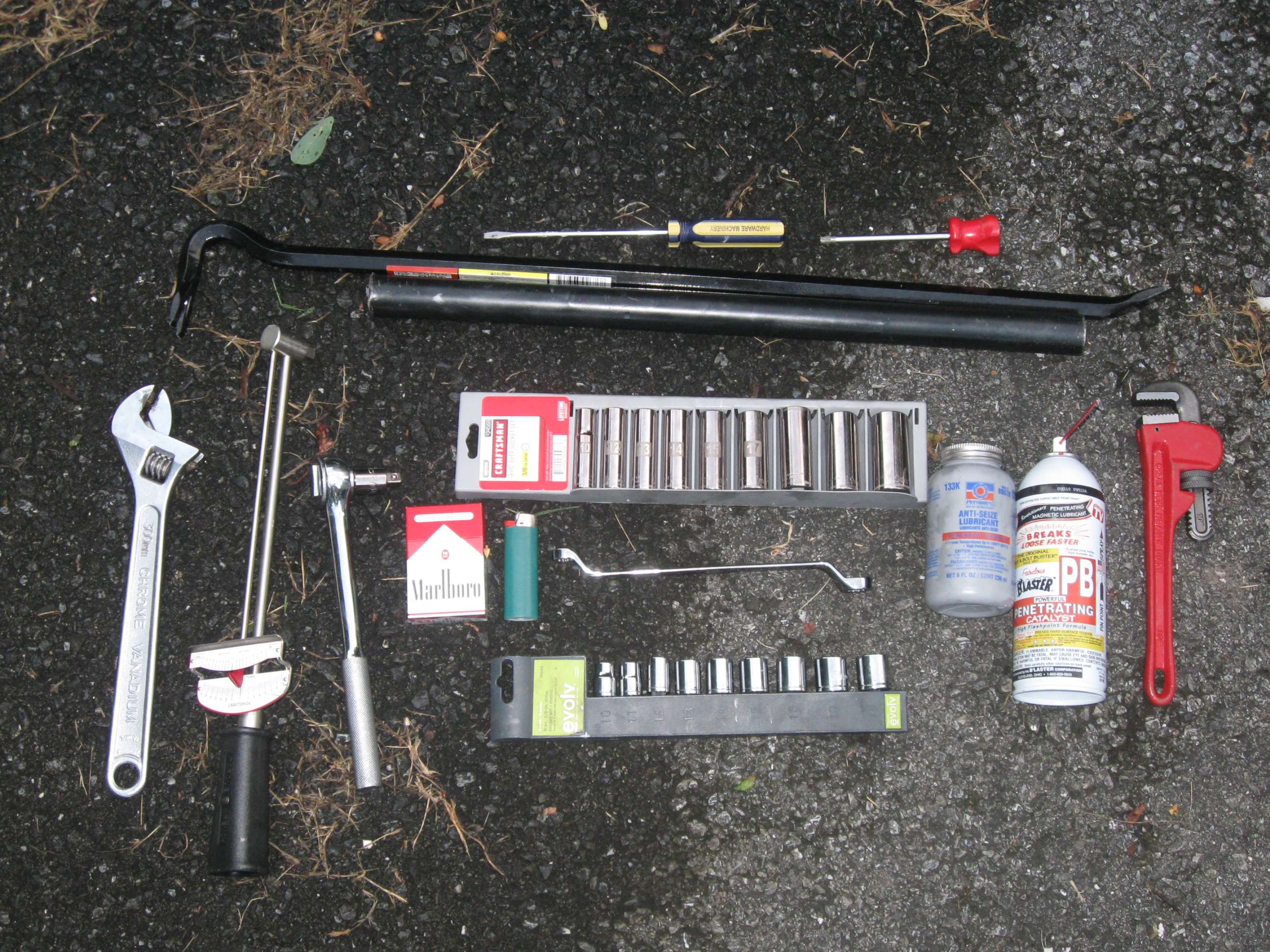

Necessary tools:
Crow Bar
Cheater Pipe
Pipe Wrench
T-30 Driver
Flat head Driver
Crescent Wrench
Torque Wrench
Socket Wrench
Regular Socket Set
Deep Socket Set
Offset Wrench Set
PB Blaster
Anti Seize
Cigarettes :-D

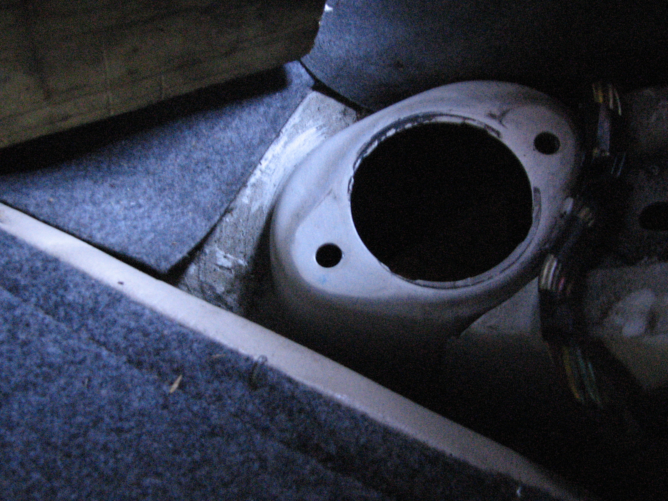

3. Remove the 2 flat head plastic fasteners with a flat head screwdriver. [1 and 3]
4. Remove the plastic 10mm fastener. [4]
5. Remove the pop out fastener. [5]

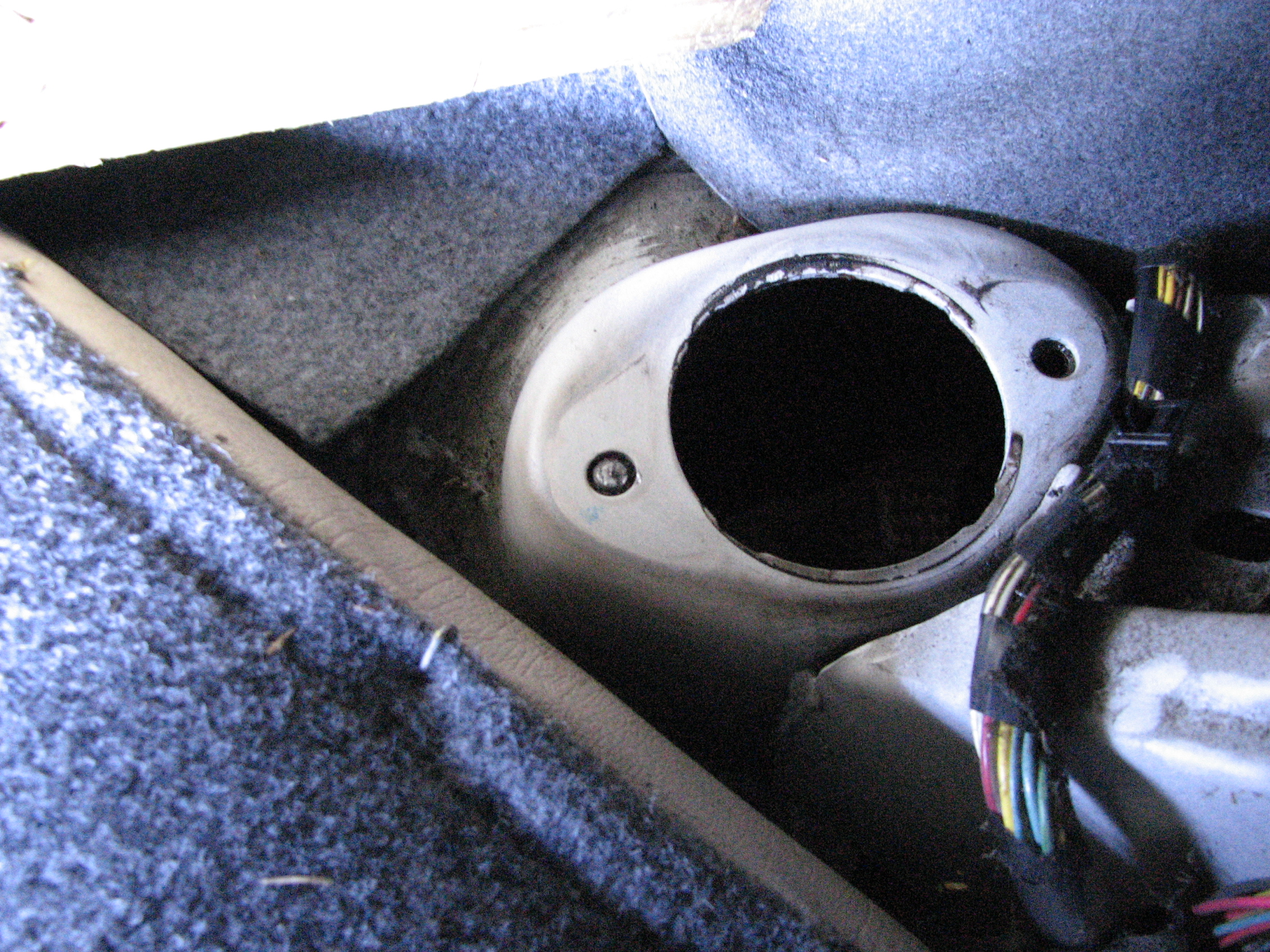

6. Pull back the carpeting.

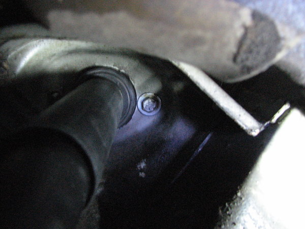

7. Spray some more PB Blaster on top of the shock mount bolts and from below. Also, apply gobs of anti seize to the bottom of these bolts so it will be sucked up into the nut as you spin the bolts.
8. Slowly and carefully remove the 2 shock mount bolts with a 12mm socket. For the 3 bolts that I didn’t break, I used cn90’s technique. It works perfectly. Loosen it 2 turns tighten 1, loosen 2 tighten 1, etc… Periodically, if you feel a lot of resistance, stop, spray PB Blaster and let it set for a while then go after the bolts again.

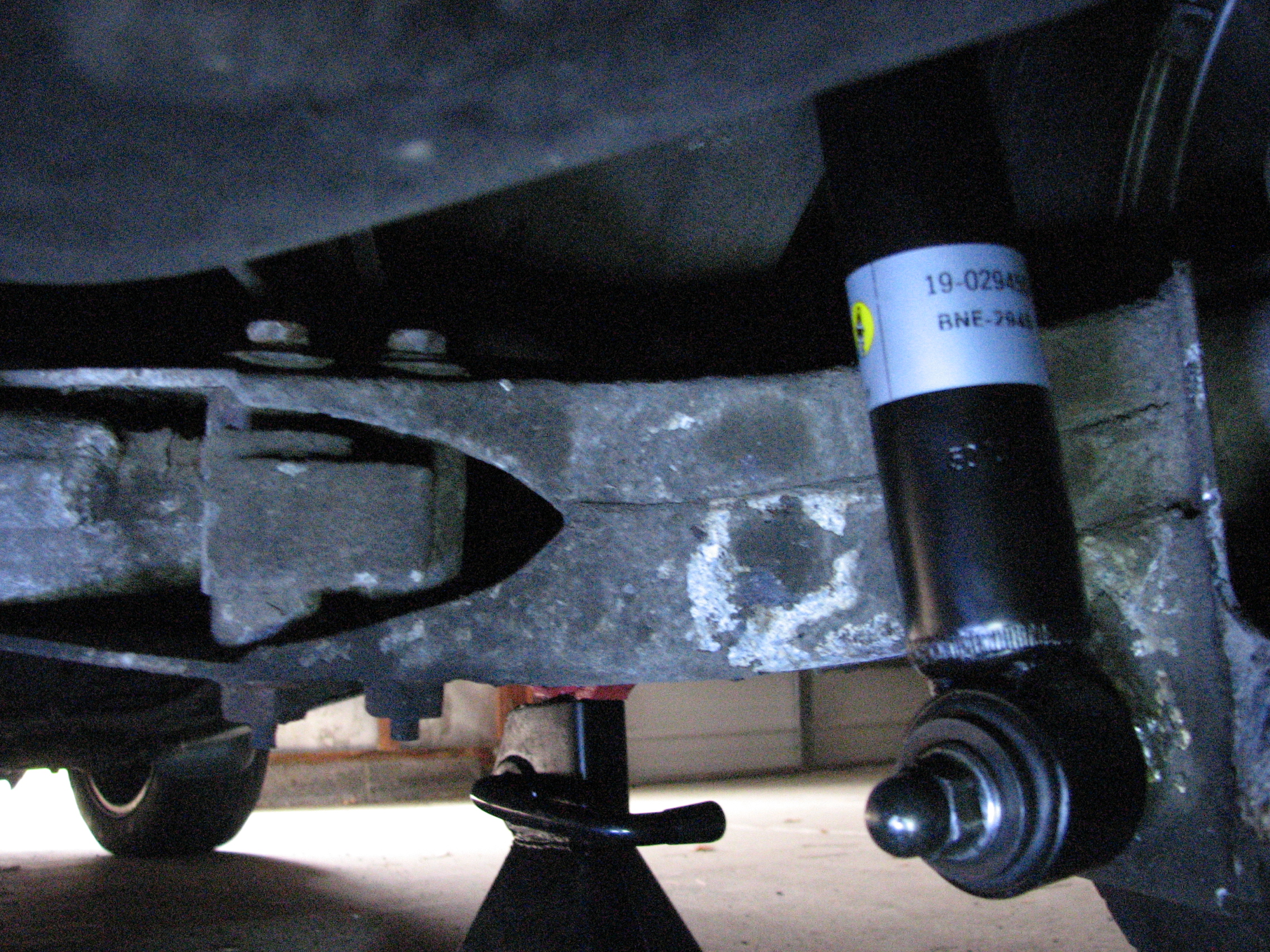

9. Jack up the side of the suspension you are working on to relieve pressure on the shock absorber. Now, use the 18mm deep socket and cheater pipe to remove the 18mm bolt at the bottom of the shock. Be careful with this bolt as well because if you break the stud off you will have to buy a new delt link arm.
10. Use the crow bar to slide the shock off of the mount.
11. Lift the shock through the top.
Reassembly:
1. Order of parts from top to bottom: Nut, Shock Mount, Shock.
2. Hold the bottom of the shock in between your feet. With one hand take an offset wrench [for OEM shocks, it is a 15mm wrench] and with the other hand use a crescent wrench. Tighten the nut as tight as you can. Don’t worry about the torque value for now, it is much easier to tighten once it is in the car.
3. Install the shock through the top. Dip the shock mount bolts in anti seize so the next time you need to remove them, they won’t break. Do not install these 2 bolts yet.
4. With the suspension jacked up a bit, maneuver the bottom of the shock onto the stud on the delta link arm and loosely tighten the 18mm nut with a deep socket. I also sprayed this with PB Blaster for future endeavors.
5. Now go back up top and tighten the center bolt to 29ft/lbs, then the shock mount bolts to 18ft/lbs, and finally, underneath, the 18mm bolt to 59ft/lbs.

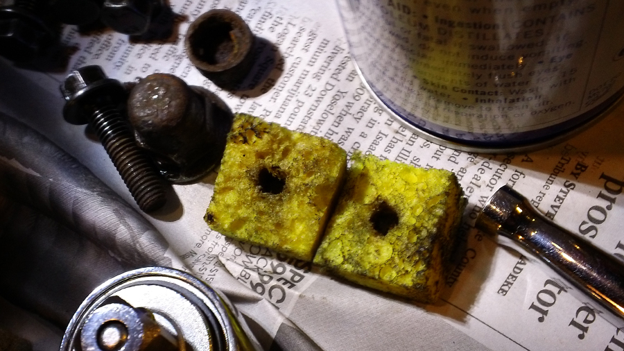

I am using pieces from cleaning supply. it is sponge material. After slicing into 1" cube like shape, i used a drill bit to make a hole through it that is narrower than the stud, wet it with PB Blaster and then use screwing motion to wear it over the bolts, like a boot. Keep it soaked lightly. No squirts and drips, a desirable clean method.
I started the treatment (on and off) a week ago. All my 12mm bolts turned. I will put the socket to 18mm in the morning.

I did mine this morning. the right side came out easy, so I figured the other side would be as well. I broke the first bolt immediately.
I sprayed more PB on the top and bottom of the final bolt and treated it like tapping threads, moving back and forth a little at a time.
When I went back to make a punch dimple to drill out the broken stem, the nut popped right off the underside as if the weld was cold and barely took.
This actually made things easier to fix. I now had a clean surface on top and bottom for the new bolt.

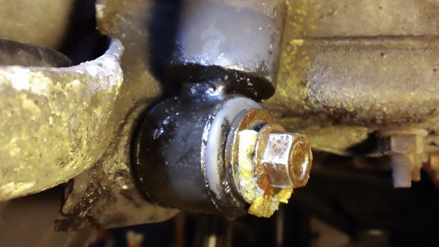

Passenger rear is fully installed and torqued.
12mm bolts are off. I am in trouble with the 18mm cap nut. It has turned two complete thread, i can see it. It made a piercing scream. I am worried.
Here are few photos.
cap nut is turning hard, the acorn broke
cap rusted and broken

Soaking boots...
making use of cleaning sponge
