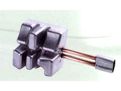

And of course, the block heater. You may stump some mechanics with this one...Most cars use a heating
element that replaces a freeze plug in the block, but there just isn't the space on a Volvo I-5 motor.
Volvo has an OEM heater that bolts on externally, on the back side of the block, just below the turbo.
It used to be P/N 9451756-2, but I'm pretty sure that it's changed. Give Continental in Anchorage a call.

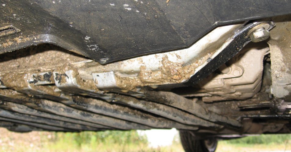

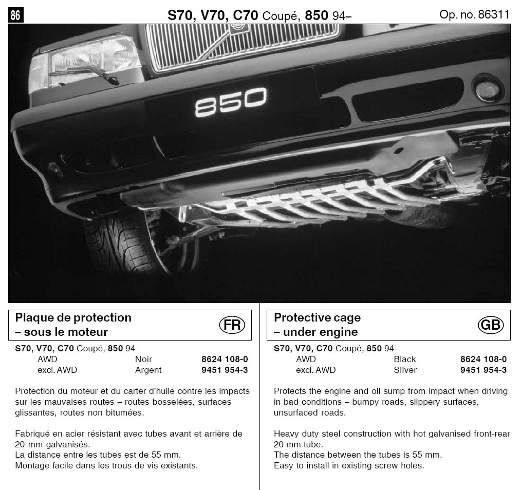

A dealer only item that looks like this: I spent about an hour and a half installing the oil and tranny heatpads, the block heater and an OEM skid plate.
The skid plate can be very useful in preserving your oil pan in "Unplanned" driving situations...They do happen...
Cheap insurance that looks like THIS: And here's what it looks like slightly used:

I've been running the Volvo external bolt on unit pictured above for years here
and it does the job, but the silicone heat pads are also a big part of the picture.
