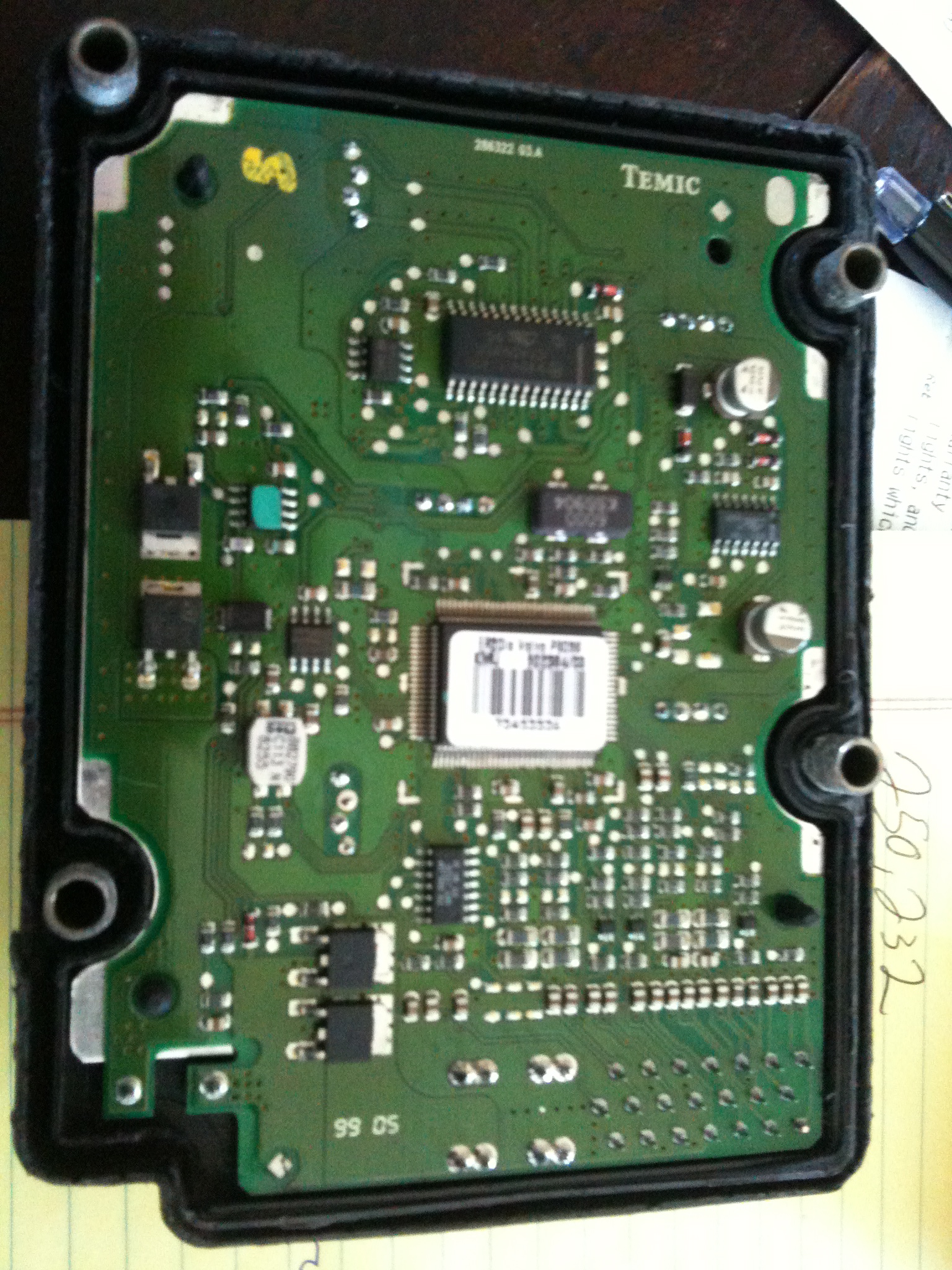

Post by cgreygoose »
I've pulled the ABS module on my wife's 99 V70, per one of the posts on this forum, a Volvo 96 850 I think. Obviously, mine looks different than the one shown on the other post but I can't seem to locate what parts of the board need to be re-soddered. I'm assuming like the other diagrams that the area to be fixed is the right side of this module, As pictured in this post it would be the bottom area from left to right. I dont' see any area's that need redone but If I can get confirmation as to where to repair this ABS module that would be appreciated as my wife needs this fixed. thanks,
