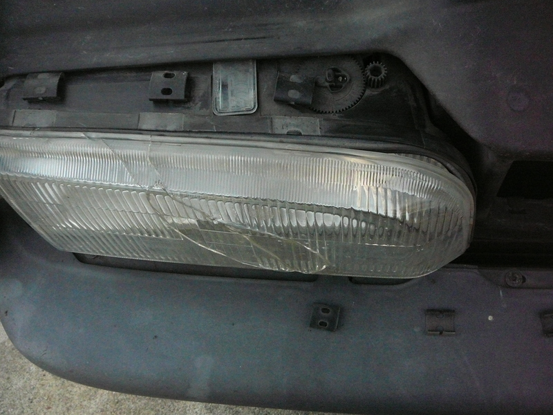

Ok, so my front passenger side headlight lens has a lot of cracks in it. [In NY's accent] Whatz the big deal, 'aam sure it would have laasted another 10 yeers[/End accent]. Well, until I realized that I can replace just the lens for the cost about $30. There goes my excuse for waiting another decade :)

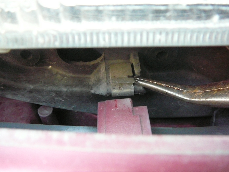

Then take off the mini-bumper right below the headlight. This thing is held in place by a series of clips, some with a little hook backward (like in a fish hook). You can easily spread open the clip with a bent-nose pair of pliers like I did. Or if you're into brute force, yanking it out seems to work too (no real damage as far as I can see). Of course, as with everything else in life, try the gentler way if you can :)

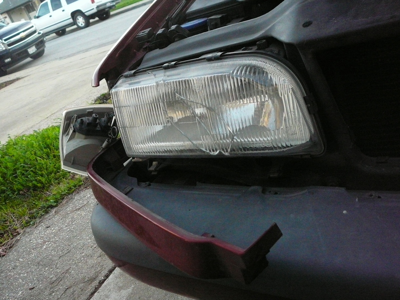

Once that thing is out, open all the clips holding the lens in place. Again it'll help if you have the bent-nose pliers. This is the lens after all the clips are off:

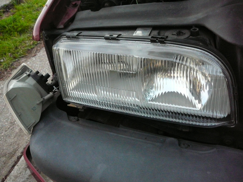

Now put the new plastic damper/gasket and the new lens in, and try to put the clips back on. The first one will seem tough, as in "how the hell can this ever fit?" But once you realize it can be done, you'll find it's easier than you thought 5 mins ago :) This pix is when all the clips are in:
