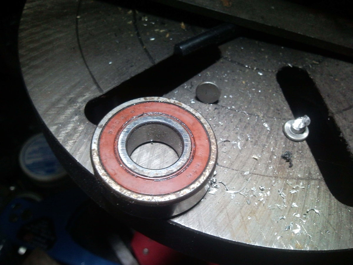

Ever wanted to do things really old school instead of using your wallet whenever the need arises?
I think I have found a way to do just that with the accessory belt tensioners on 850s or V70s (perhaps others too?) at a fraction of the cost of replacing whole tensioners or pulleys.
If the bearing in the pulley is the only part that is failing in your tensioner then why not just replace it for around $10?
With these steps below and some simple tools you can do just that. It took me half an hour to swap it out.
Tools required:
1) Steel or wood jaw vice
2) Point punch
3) 3/64, 13/64 and 19/64 high speed steel drill bits
4) Cold chisel

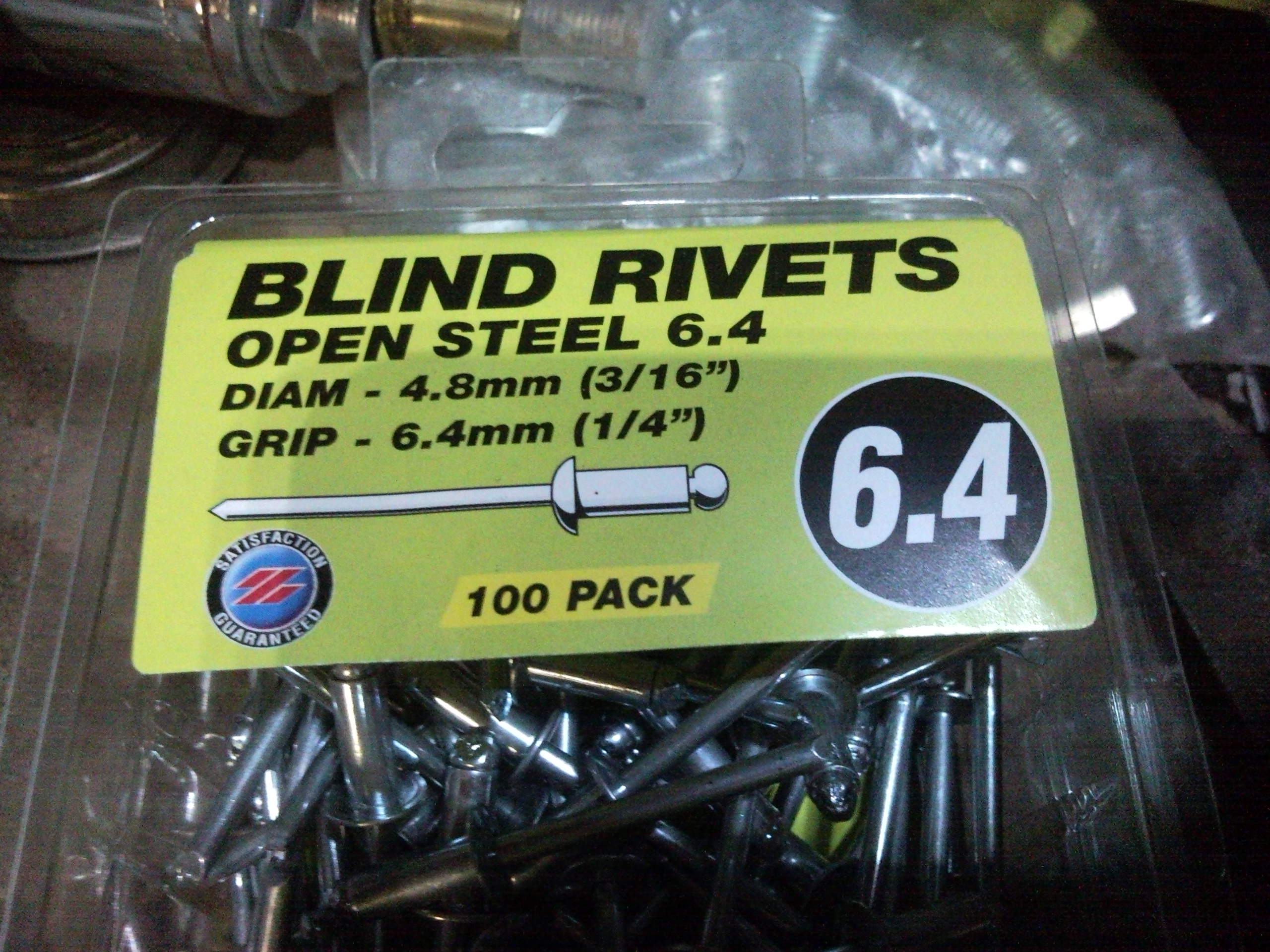

5) 3 Blind rivets 6.4 size as per photo (in steel not aluminium) and a pop rivet gun
6) some plumbing fittings, 1 inch water or gas cap end (perhaps a 20mm socket)
7) T40 torx bit
Step 1: Buy a 6203LH NTN brand or equivalent bearing
Step 2: Remove your tensioner (as this raises much heated discussion on the merits of coins, shaved down plumbing fittings and the like I won't go there :lol: )
Follow the steps below:
Re-assembly is a reversal of the above points with attention to ensuring there are no burrs on the facing belt surface. If so use a flat file and sandpaper to remove
Also once you insert the new bearing and re-assemble the two halves with the three holes lined up place the pulley b/w some wood blocks and belt it back together softly, then rivet the halves together, making sure it is pulled in tight by the rivets.
Loosen the torx bolt with a T40 bit

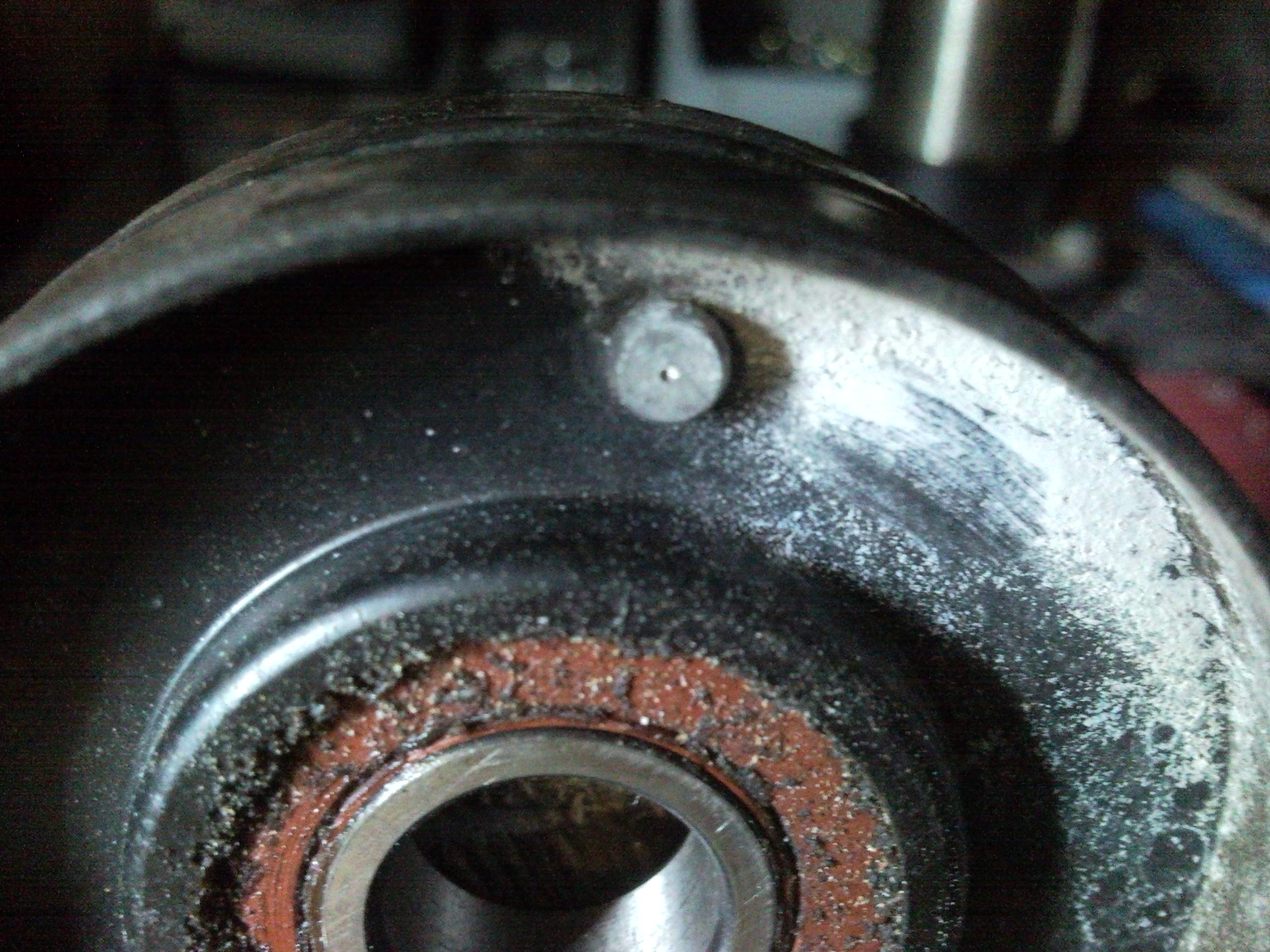

Centre punch back of the three rivets

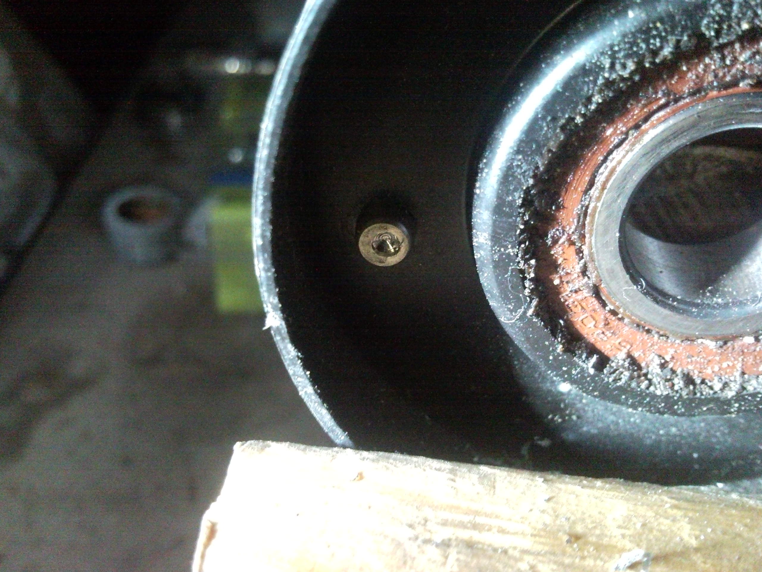

First drill a 3/64 hole in the punch mark
Then progressively drill out the rivets with 13/64 and then 19/64 bits, then punch the rivets out

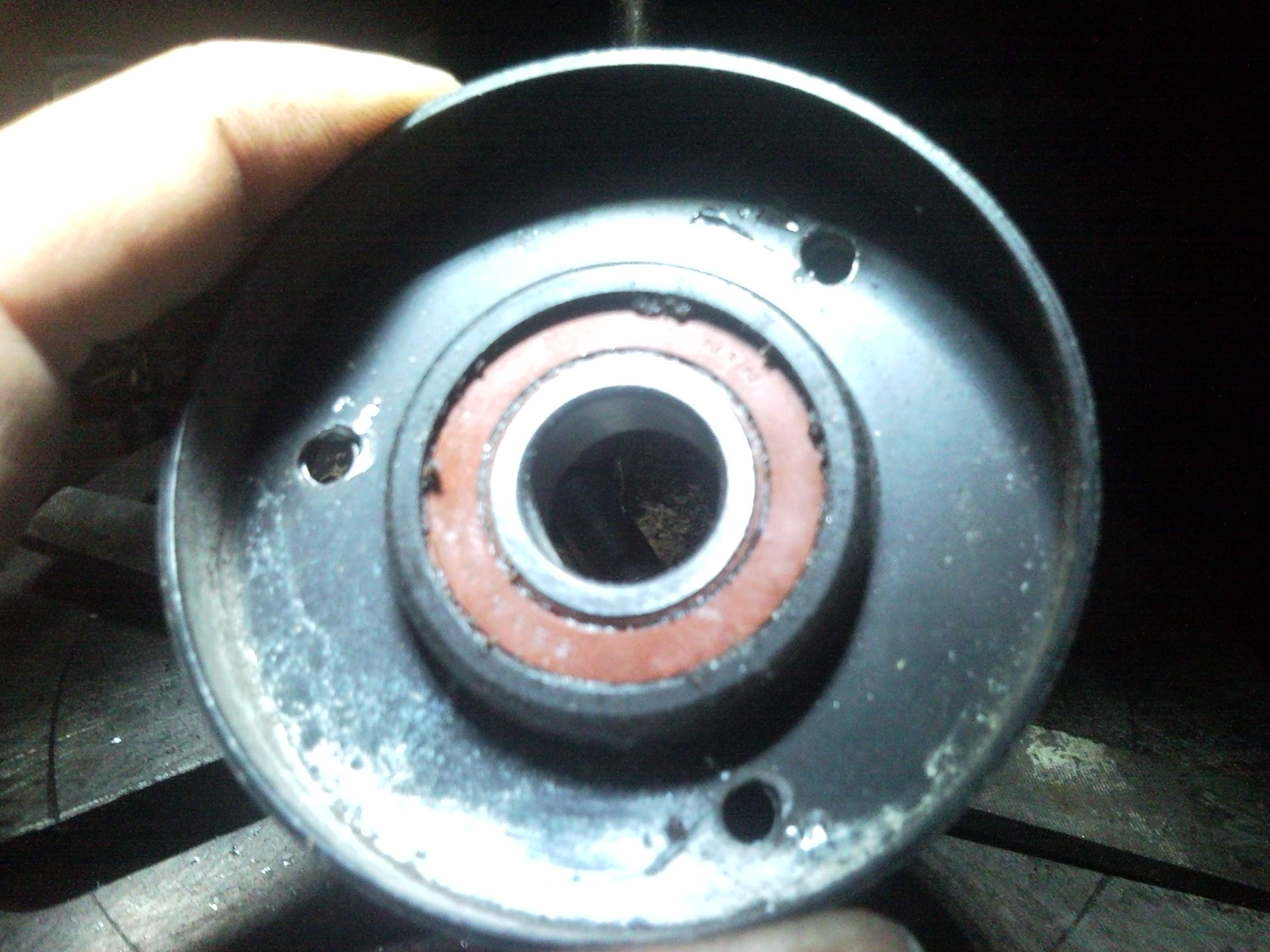

Using a cold chisel work your way around until it separates

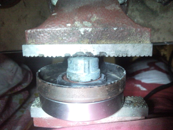

Squeeze the bearing out with a vice (I used a plumbing cap & a large bearing on the other side)
Your bearing is removed

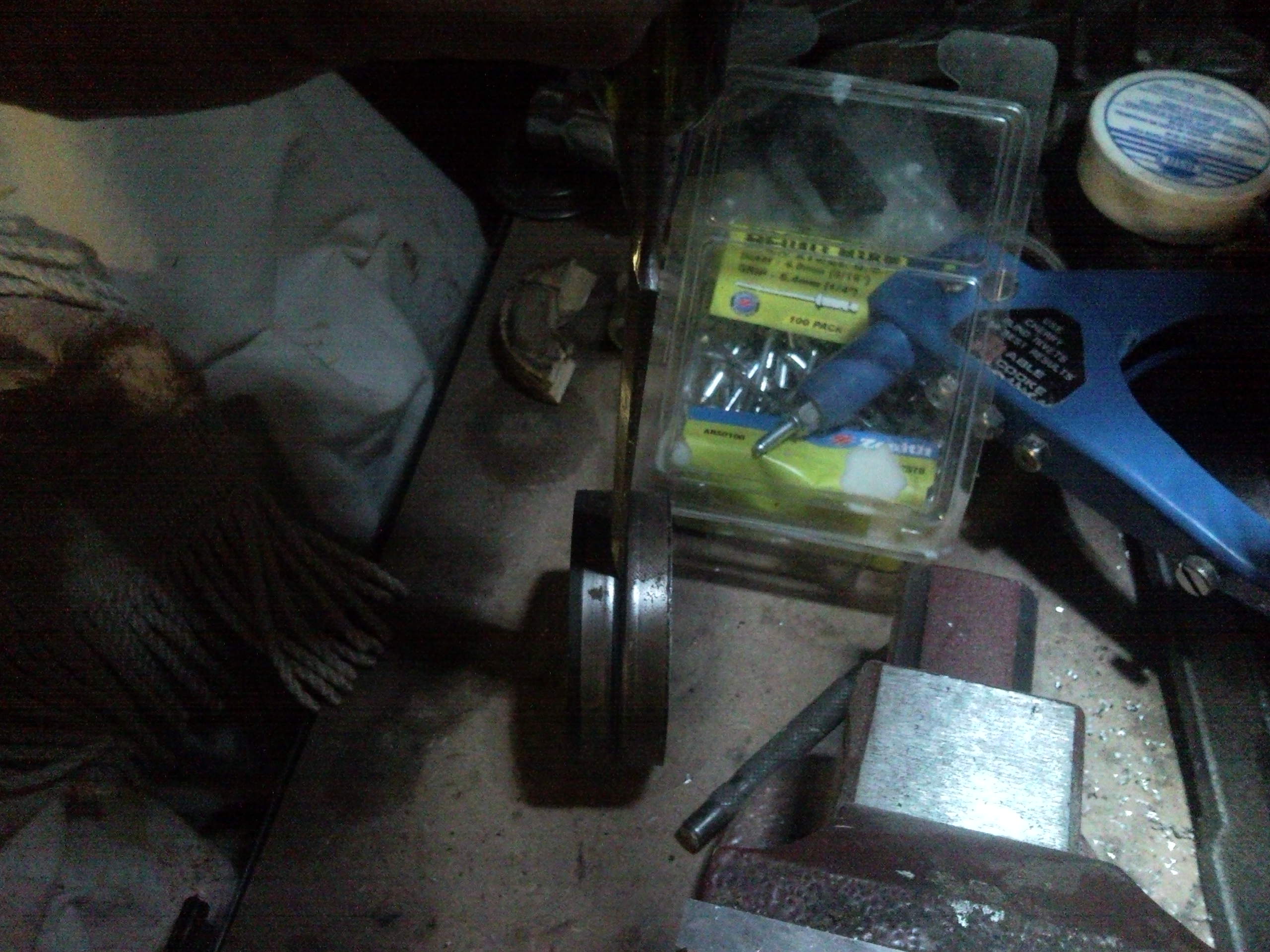

Use steel rivets for peace of mind
The finished product with shiny steel rivets

Your pictures are inserted backwards... otherwise a great writeup! I'm sure most folks just bin the old one without a second thought instead of just replacing the worn part.
PS. Coins? By the way, I use a cut off piece of a large chisel and vise grips to unload my tensioner.

Can anyone educate me the difference between 6203LH and 6203 bearings?
I know quite a bit about bearing but not this "LH" designation.

Looks like NTN says LH = Light Contact Rubber Seal.
I guess any good 6203 bearing (with double seals) is fine.

I installed the brand-new serp belt pulleys (tensioner and idle), so I just played with the old pulleys (150K with very very slight play of bearings) just for fun, but this may help those with tight budget.
For those with tight budget and want to have free repair, here is the EASY way, no need to drill rivets etc.:
- Use hook or pick tool with blunt end, gently lift the inner lip of the seal.
Choose the seal that faces the inside of the engine, this way it is not exposed to dirt should you cause minor damage to the seal.
- Clean old dried grease using Q-tips etc.
- If you want to be a perfectionist, then soak it in mineral spirits and let it dry.
- Apply new grease using your finger, press it in.
- Re-install the seal, outer edge first, use your thumb to press it in. The pulley halves are sort of in the way but you can press the seal in.
- Use a blunt tool to press in the outer edge of the seal, it won't look perfect but close enough.
- Spin it: nice and quiet!!!
This re-greasing business will give you another 50K of life on the pulleys.
All it takes is 5 minutes.
Of course, you are rich and buy new pulleys, don't read this post lol.
precopster
Posts: 7543
Joined: 21 August 2010
Year and Model: Lots
Location: Melbourne Australia
Has thanked: 8 times
Been thanked: 128 times
Post by precopster »
That won't remove all the dried grease on the other side of the bearing, no matter how much spirits you use. Then you'll have old grease mixing with new. Come on this is a $6 bearing we're talking about!!
