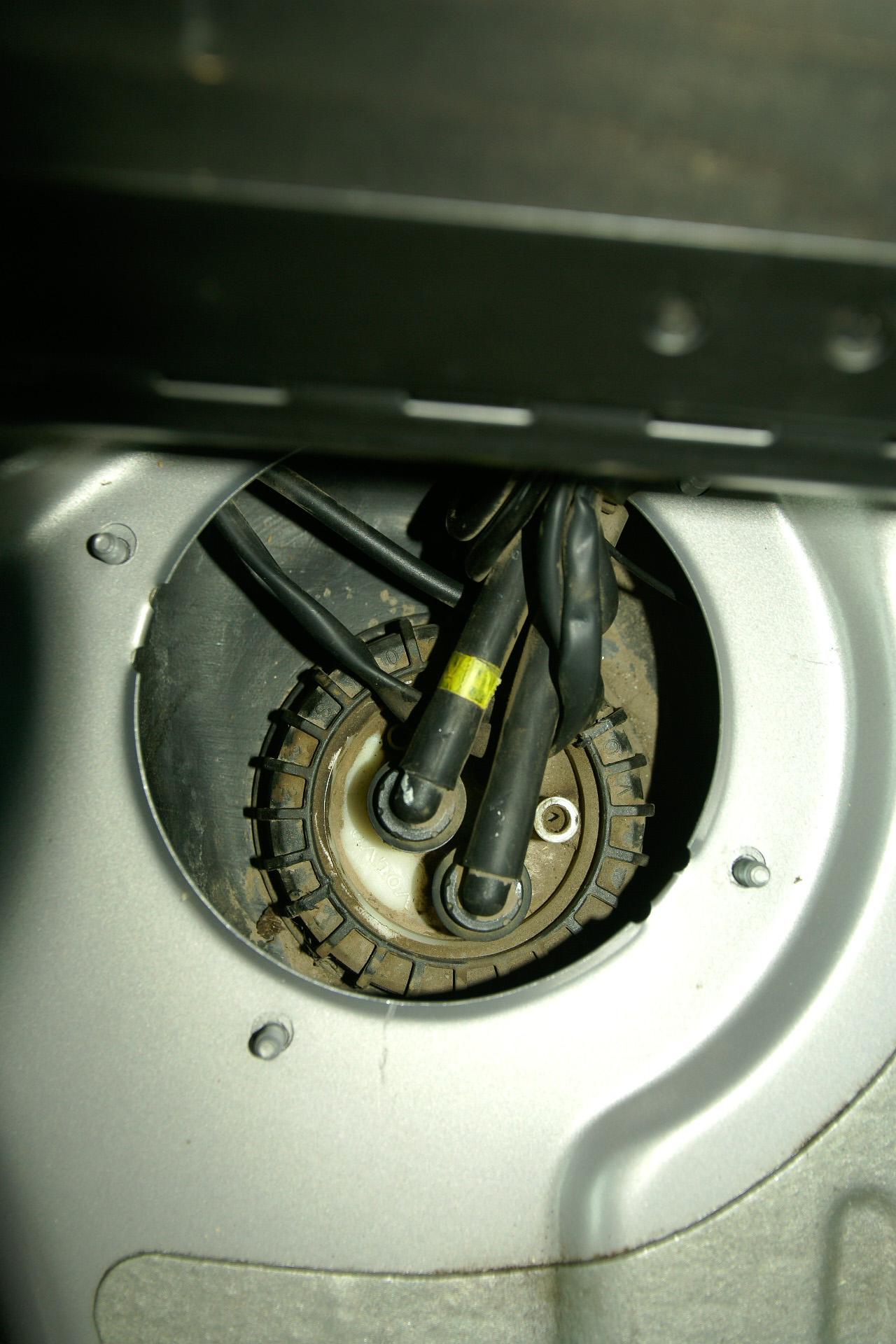

When I talked to the mechanic he mentioned cracks in the plastic (top) cover of the fuel pump and mentioned a kit to repair it, what would the kit consist of?

I myself have never heard of such a kit, but that doesn't mean it doesn't exist. The fuel pump is the one thing I have not had to deal with, but as I understand the whole thing comes as a housing.

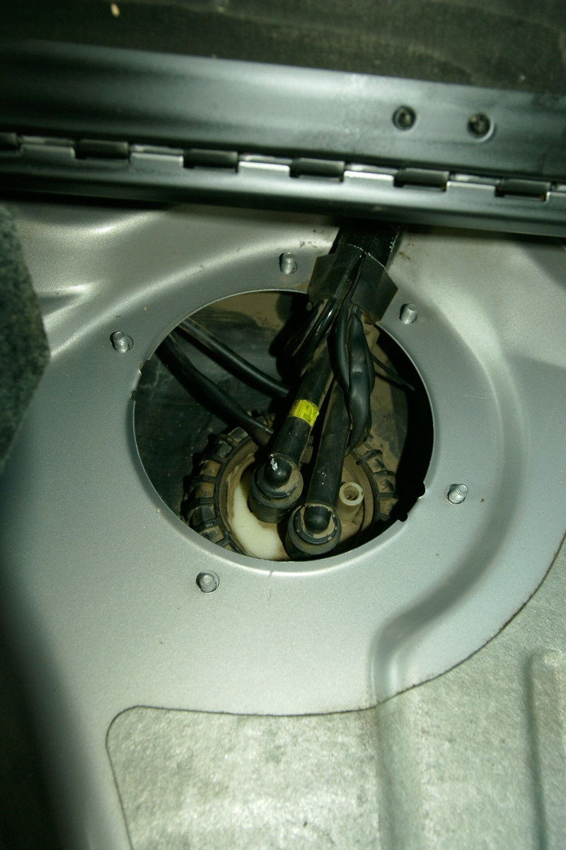

No signs of cracks, Am I looking in the wrong place? Should I take it out to see if its broken inside? I hear it whirling away gently. The pump works, I would expect to smell gas when the car is idling, if anything near pump was leaking.
