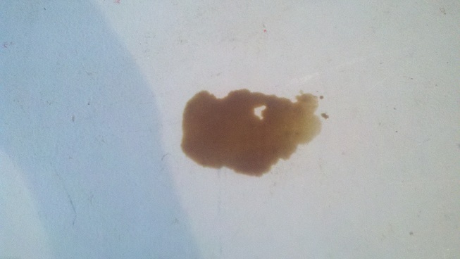

I know I have had somewhat of a leak for the past year probably, well it's come time to try and diagnose and possibly a DIY Fix with the help of this fantastic forum. I was replacing my J-hose yesterday and had the car parked in the garage. I decided to take some pictures of the leaks to see if it was at all possible to tell from the drip locations on the garage floor to see if someone had similar leaks and the location they had their leaks, I am assuming leaks are oil based on smell. The car was in the garage for no more than 2 hours.

Both drips seem to have the same smell but were slightly different in consistency and color. The first picture is the spot located more to the rear of the vehicle. (Rear Main Seal?)

After reading through the forums and seeing some of the common problems, the best I could come up with is that the spots up front are possibly Oil Cooler leaks and the two in the rear are the rear main seal. Based on the pictures of the drip locations, does anyone have any opinions? Is there a "easy" surefire way of checking where the leaks are coming from? Thanks for reading, and appreciate any comments or questions.

I dont think its your rear main seal, but get under the car and look up, and take your time. If that doesnt help, clean the engine and look again!

Oil runs just like water to the lowest point along multiple pathways. Clean it well and have a look at the engine after a long drive.

Look closely where the engine meets the transmission and you'll see a tiny hole between them. If oil is leaking BETWEEN that hole, then it is your RMS leaking. If it's just covering the transmission all over, but that area is dry, it's coming from above.
If it's reaching the ground, my key suspect would be a camshaft seal, on the rear of the engine. It's directly behind the camshaft sensor that's to the rear of the distributor cap.

I would clean your engine with a degreaser, wash the underside and then after it dries run it for a bit. Once its cool and clearly leaking again I would jack it up and see if you can trace were the fresh leak is coming from by looking underneath the car.
