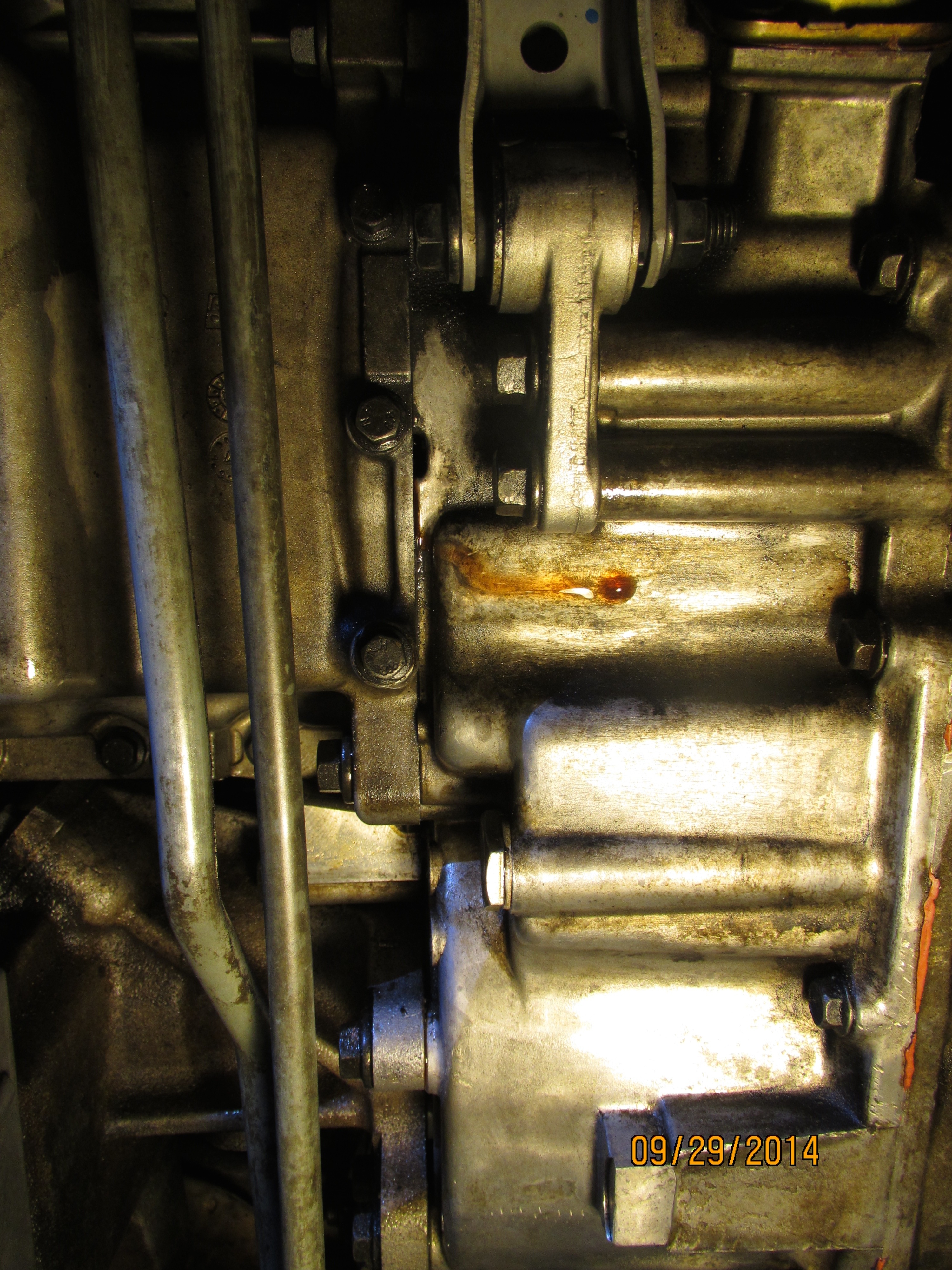

Hi all,
I have read up on Rear Main Seal leaks a bit, and I am pretty sure that is what I have (I showed pictures to my mechanic as well):
My leak has been slowly developing over months; I now have a about a half of piece of paper (8.5"x11") area of oil each time I park in the garage (bought a drip pan finally). I have 180k miles on this 16 soon to be 17 year old car. I like the R, I have taken really good care of it, it still looks good and everything works on it, etc, and I would like to keep it another year or two at least rather than replacing it now. The leak really is not bad yet, in terms of movement on the dipstick - takes a couple hundred miles to see it drop.

That's an RMS leak, no doubt.
What is the PCV service history? OCV is presumed to be the #1 cause of RMS leaks.
(1) No, don't think I have ever heard of that. It will get progressively worse, as long as you are doing city driving and watching the dipstick you will be fine. It may get real messy real soon, may not.
(2) the only snake-oil additive for engines I have ever trusted is one called Auto-Rx. Opinions vary widely even on this one no doubt, but here it is: http://www.auto-rx.com/. I think JDS60R had an additive he likes, he knows his stuff maybe he will post up.
(3) $1,100 for the RMS and trans seals on an R (AWD) is a good deal if the mechanic knows Volvos. Make sure he uses Volvo seals if you go this route. Is it worth it? I would think of it this way: if you didn't have a car, would you buy this one with the new seals for $1,100? I probably would if it was my own car, that is dirt cheap for a 98 R in good condition, but you know the maintenance history the best to answer the question. Is there a bunch of routine work will need to be done soon? As long as the valve stem seals are not yet blowing blue smoke I would probably stick with it, sounds like you still really enjoy it.

As Erik said -clean or replace the PCV system after checking it for clogging (glove test).
If no excess pressure is being built up then you can try ATP AT-205 reseal.
Please use Matts link above if buying from Amazon -then go to AT-205
I've never seen it totally eliminate a big leak but it sure does slow it down a bunch, unless the seal ripped or cracked - then its done. My thoughts are for $10 is worth the gamble. Just pour it in the oil and let it work for 3 hours run time (does not have to be continuous). I have seen very satisfactory results many times.

Hello all,
Thanks for all the great input. I will try to answer a bunch with one post here:
PCV: I knew about the PCV system clogging and potentially causing oil leaks (didn't know about RMS, though). I did most of my own work on the car until family and work got too busy this last year, but I had bought a full PCV replacement kit from IPD last year with the phenolic spacer for the intake manifold, intending to do it all at once. Never got around to it, and my dipstick still showed a bit of negative pressure until about three months ago. I took it in to the dealer to check / diagnosis a vibration and asked about the oil leak. The dealer said then that PCV was probably getting clogged and was about neutral pressure, and that may be contributing to an oil leak. I checked with a tissue over the dipstick and it was pretty neutral; not sucking in and not blowing off. (I also checked the rear camshaft seal and the turbo oil return line, both of which I have done the seals on a few years ago, both dry).
So I don't know that PCV was it. But in any case, I took it to Mike (independent volvo mechanic) and he did the PCV cleaning, replaced all the tubing and breather box under the intake manifold with new, replaced some other random vacuum bits, and put the phenolic spacer in. Great job. So, PCV is fixed, and good. Have a good negative pressure now at dipstick.
Oil leak still continued at about the same rate. My leak sure is not as bad as some you all wrote about: Mine is pretty much only about as far back as halfway down the catalytic converter.
As far as keeping the car: I do like it, but we are finding it somewhat smaller than optimal for big trips now; I do a fair amount of skiing, and even with a roof box, all our ski gear, family of four, sometimes the dog as well, and it gets pretty full, so that is one issue. On the other hand, I agree about the car payments vs. repair payments: $1,200 is about 4 - 5 months of a car payment for a decent maybe 4 - 5 year old replacement car, even with putting a bunch of money down ( I generally only buy used cars - I bought this R as a 2 year old used car). No other repairs are due soon (timing belt in another 30k is the next big thing - three years away for me with my driving) and the maintenance has always been done. Did struts and self leveling shocks last year, steering rack the year before, you get the picture. Synthetic oil, etc.
Anyway, I really appreciate the various ways you all suggested to think about the question of keeping the car or not. Great to have smarter people with the same cars help out, thanks!https://www.matthewsvolvosite.com/forums ... 1&p=344012#
Thanks for the suggestions on the anti leak additives. Sound like that may be an option for a while, and will keep things a little cleaner and delay my decision if I want to delay.
My mechanic is really quite good on Volvos; we talk about his highly modified '99 V70 sedan and all that he has done to it; a lot of it is essentially putting some R like mods on it and then some. If you need a Volvo mechanic in San Diego, I can recommend him.
If I do the repair, I intend to have Mike replace every seal he can get to with OEM while he is in there.
