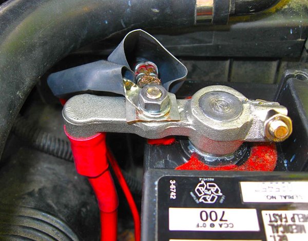

It fit on my 1997 850 GLT wagon. The only glitch was that the screw for the B+ cable terminal (which connects to the top of the terminal of the cable in the above picture) is a little different. So I has to flatten out the B+ terminal so it would make proper contact with the starter cable terminal at the battery. You'll see what I mean when you get it, but it functions fine. There is also a TSB 3370001 that explains exactly how to route the new cable in a retrofit manner.

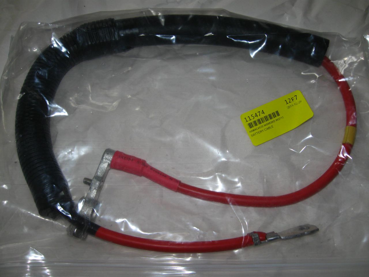

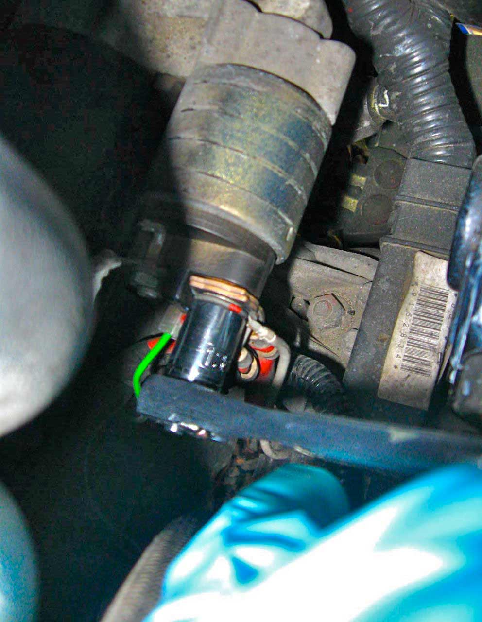

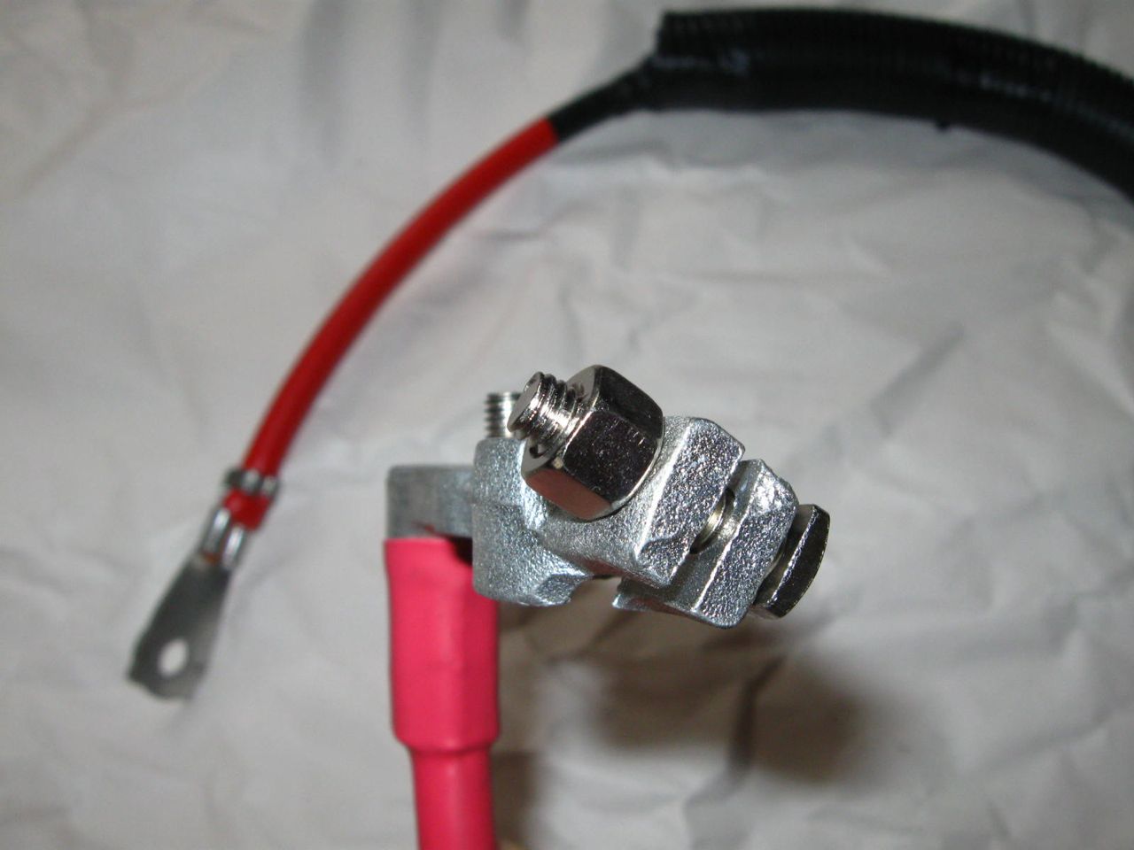

The new cable came from IPD on Friday and I installed it today. The part does fit the 850 just as you guys (Bob850, erikv11) said it would. Thanks! I had to bend the ears on the cable terminal just like what you described. I suspect from the yellow ID label on the bag that it was made by Ramac ("RAMAC4520" just below the bar code on the label), just like the one offered by FCPeuro ( http://www.fcpeuro.com/products/volvo-b ... 70-9456836 ).
Battery cable in bag: Terminal end, showing angled bolt: I took a few pictures along the way during installation to show what it looks like.
Be sure to disconnect the battery cables (positive first, then negative) -- be sure you have the code for the radio before disconnecting! I removed the battery from the car to make it easier to route the new cable.

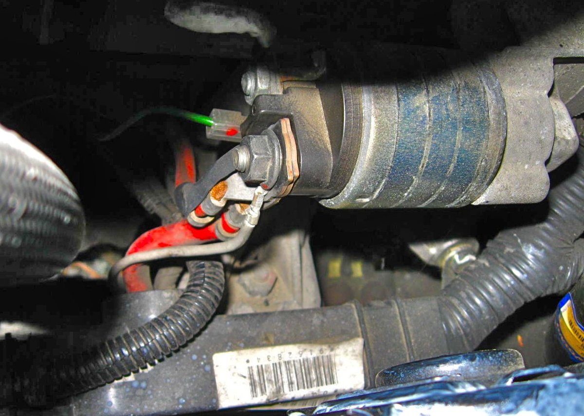

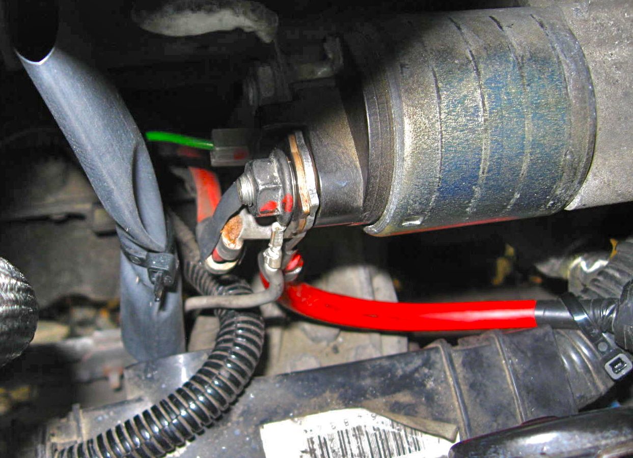

Here is the starter with the original cable still in place, after removing the black plastic cover. The starter cable (on my 855 at least) was the spade terminal closest to the starter on the attachment bolt. I loosened the bolt with a 1/4" drive ratchet and a 13mm socket. There is not much space to access the bolt but it can be done.
Once you get the bolt loose you can pull all three terminals off and move the battery cable out of the way. I opted not to cut it off but instead I covered it with large diameter (~1" dia) heat shrink tubing. I moved the old cable to the left of the picture below. On the right, I used a tie-wrap to tie the new starter cable to the wiring harness. The new cable can be fished in along the old wiring harness, in front of the fan and then up to the battery tray area. I snapped the cover back onto the starter after this: Next I cut off the old positive terminal and wrapped the end of the wire with heat shrink tubing -- but save the nut on the old terminal. Next I installed the battery back into the car, using the little battery retaining clip.

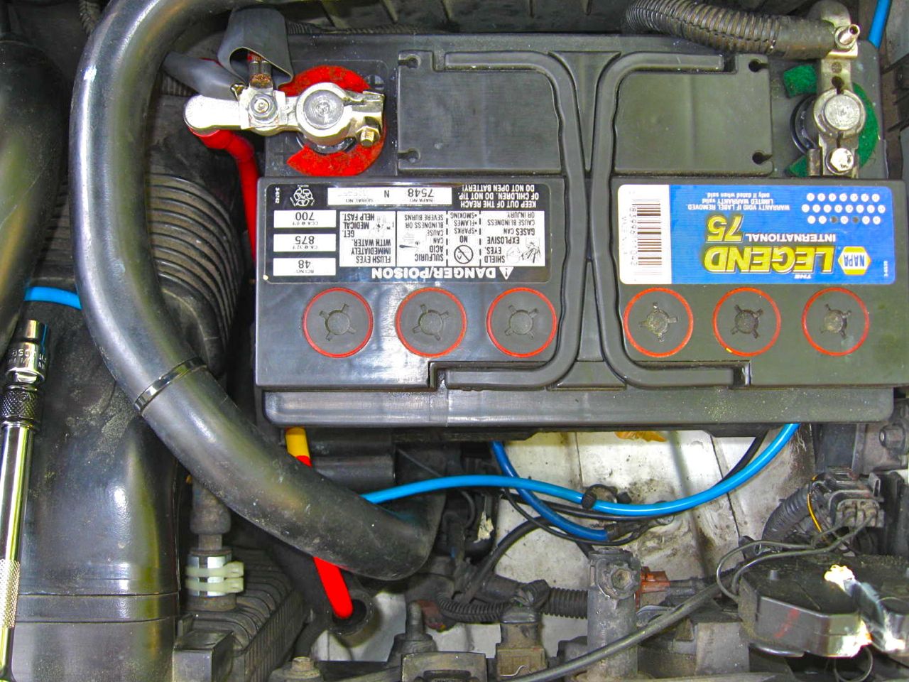

Then I attached the cables to the top nut of the new positive terminal -- this is where on the 850 you have to flatten the ears on one of the cables to get it to sit flat against the top of the terminal. I used the nut from the old terminal on the new terminal because the new terminal did not come with one. I used some heat shrink tubing on these cables to protect them from accidental shorting. Then I reconnected the negative cable to the negative battery post. An overview shot of the finished installation at the battery: Overall not a difficult job. I would definitely buy the part from IPD again -- great service and great price, even if they don't list the part as being a correct fit for the 850. Thanks again for the advice on the compatibility of this part with the 850 -- you guys were right!

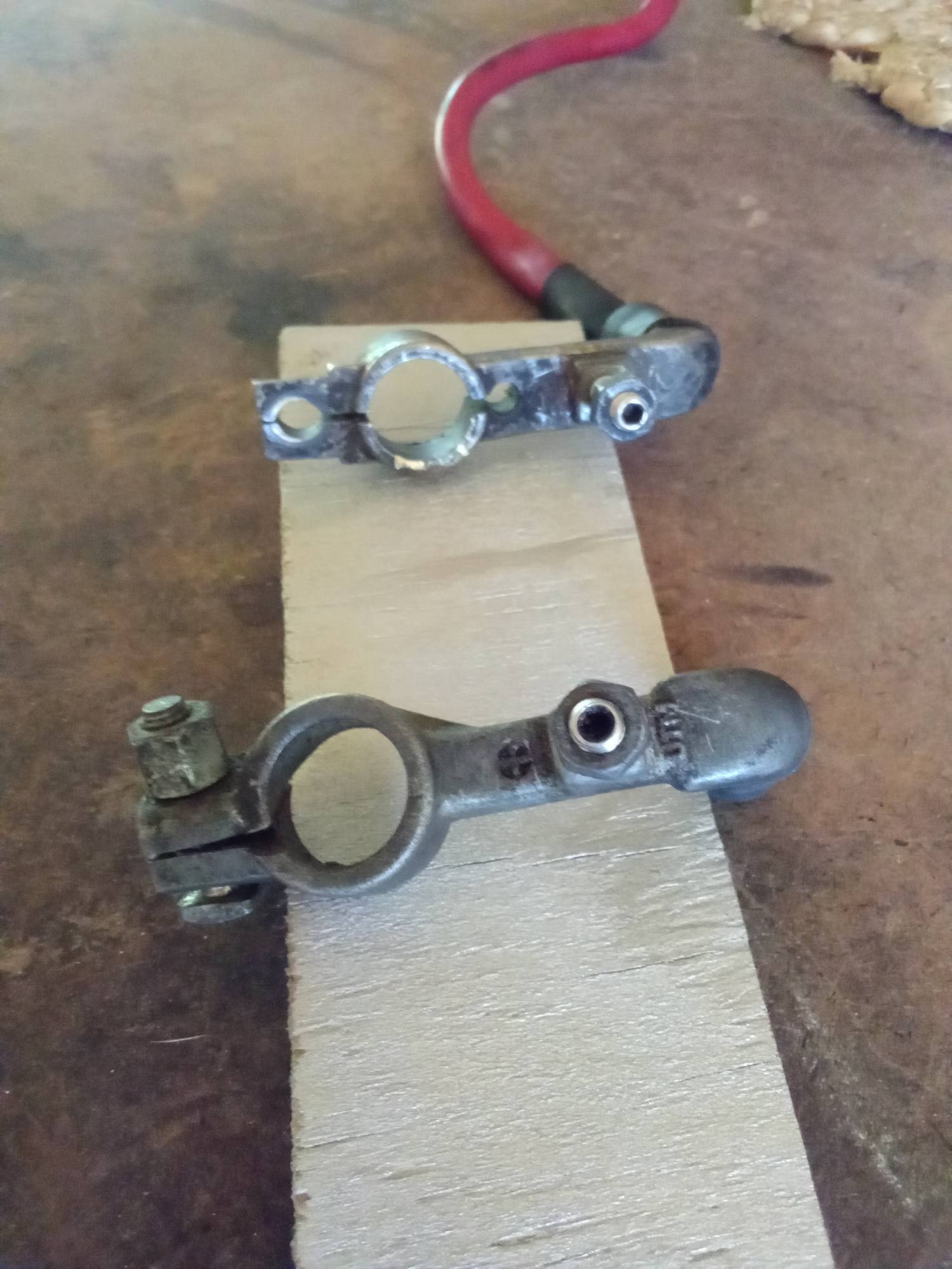

Need help with this cable. The one in the foreground came off my 2000 S70. The other one came off a 98 S70. There is obviously something missing on it. What is missing and does anyone have the missing piece that they might consider parting with?
