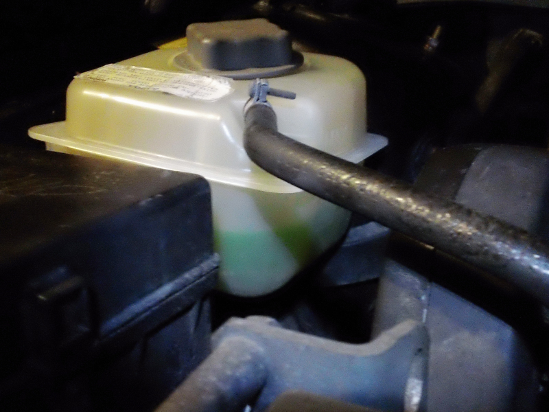

Hoses look fine...
low fluid...
low fluid...

The expansion tank is warped (like mine was) and needs to be replaced. It can leak ever so slowly losing pressure (like mine was). Since you'll need a need Radiator the Hoses, Thermostat and Cap should be replaced also. Might as well do a transmission flush if the fluid is dirty and if you have the time. Both upper and lower hoses will be off when you remove the Radiator. You can flush before connecting it back to the Radiator in case your fluid is very dirty.

- The expansion tank looks fine. Unless the system is leaking when you put it back together, you don't need to replace it.
