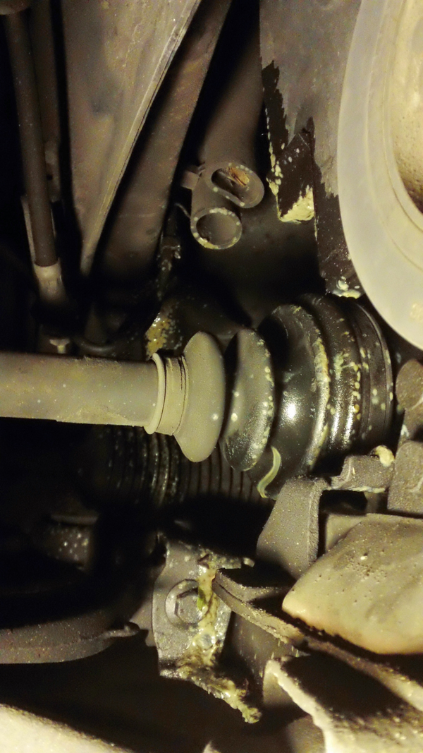

There is a cream color paste splashed under front passenger side. Is it leaking lubrication of some kind, why splash?
passenger side front wheel
TIA!

You may have driven through something.

My vote is that it is out of the CV joint boot. It has a hole or crack in it and leaked it out.
It will leak until the level of the grease is below the hole.

The grease out of our CV is BLACK as TAR.

Yeah. I remember my CV leaking black crud.
Remove the front of the TB cover and have a look: it kinda looks like milky oil from a clogged PCV system to me in a way being flung up by the crankshaft pulley. Though if your oil is that color you may have other problems...

I disagree, the grease i instaled into all 4 of the boots i replaced 2 weeks ago was a tan milky color. the grease that was left over after i had been driving with pin holes in the boots was also a milky color, just lighter because of water getting in there.
replacment of your boots is a easy fix you just need a special tool to close the clamps, you can also replace the hole half shafts. my boots were $15.00 each and i saw new half shafts were around $85 each on line. hope it helps.
