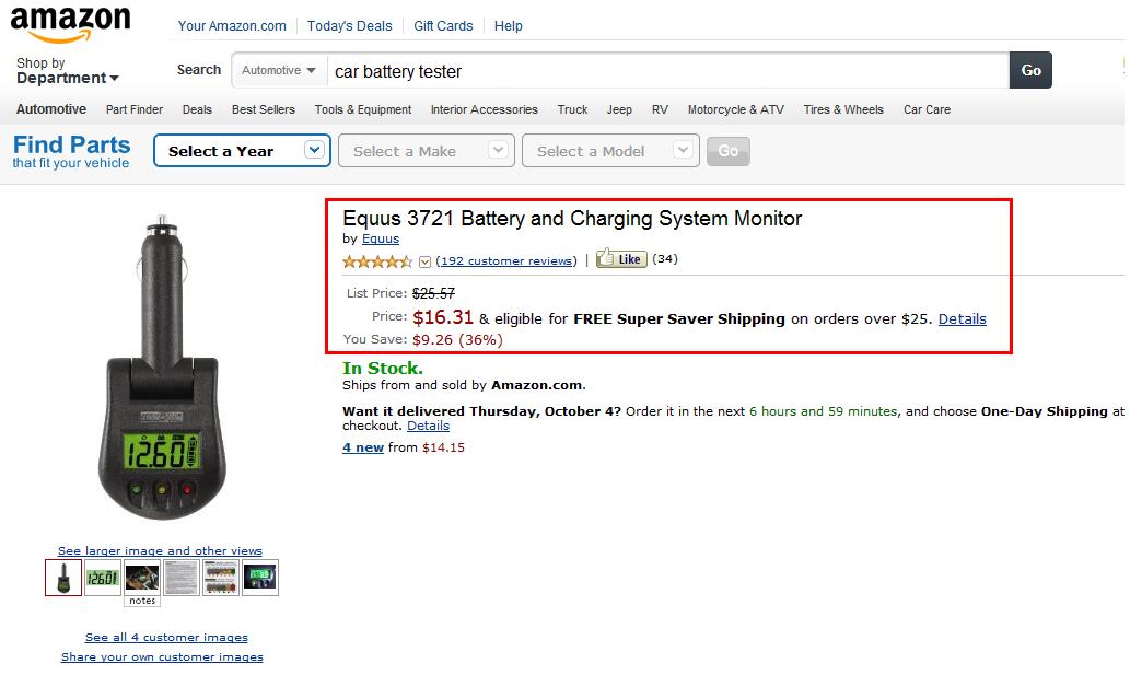

I will tell a little trick: recently, a new product comes out: "cigarette voltage checker".
I have this "cigarette voltage checker" in the glove box just for a quick check (this way you don't have to open the hood or trunk to check the battery). I have verified this against the real multimeter and I have to tell you this little gadget is very accurate.
Kind of a "lazy" way to check the battery from the cockpit LOL.
Example is below for something that costs $14, but again, you can find something similar for $6-$8 on ebay:
rmmagow

I'll pick up the Equus thing tonight, walmart has it for 17. Only battery light I ever had was about 3 months ago when I mis-judged the depth of a puddle and the serp belt started slipping pretty badly. Once it dried (30 seconds) all was fine and never had another battery light. Winter tune this weekend will include removing batt connections and cleaning everything up there and an inspection of that big wire running to the fuse box. Just hope my piggy bank can handle ordering a new propshaft for the thing.
