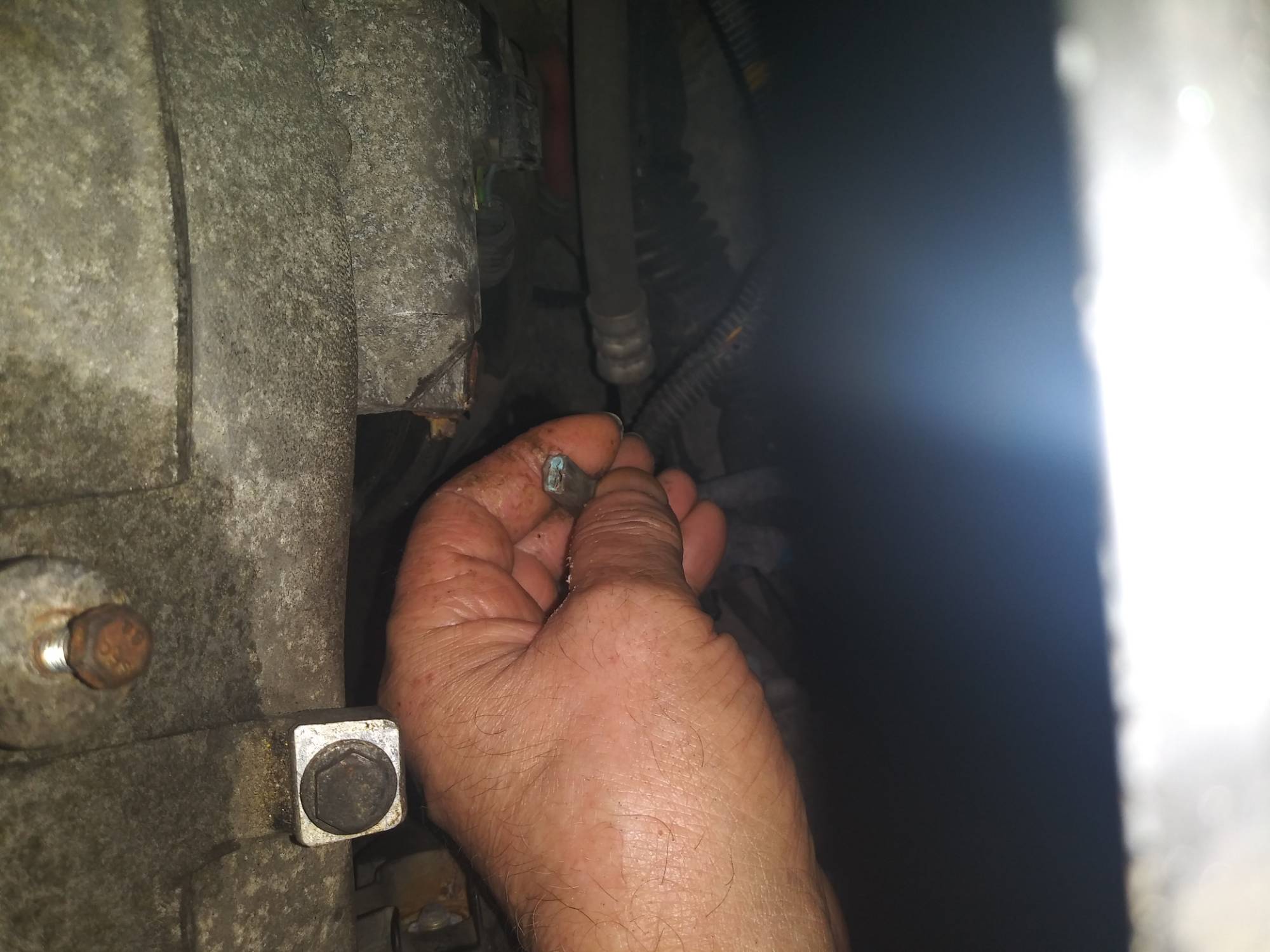

the alt isn't charging, the engine is just running off the battery.
The only way that can happen is if the alt is dead or fails to get a signal to energize.
Check the small signal wire for corrosion, its mostly exposed to the elements. Make sure it slides onto the connection firmly.
I believe if the alt was dead you would get the red warning light on the dash, same as if the serpentine belt snaps.
When the small signal wire is interrupted or broken the red warning light doesn't show and you don't get any charging.

mine looked like this.

Thanks for that tip. Mine looked pretty good. I pulled it off while the car was running, and stuck a multimeter to it. I was getting battery-level voltage at that wire. I am getting a $50 alternator from the local used parts shop. I'm going to see if that makes any difference.
