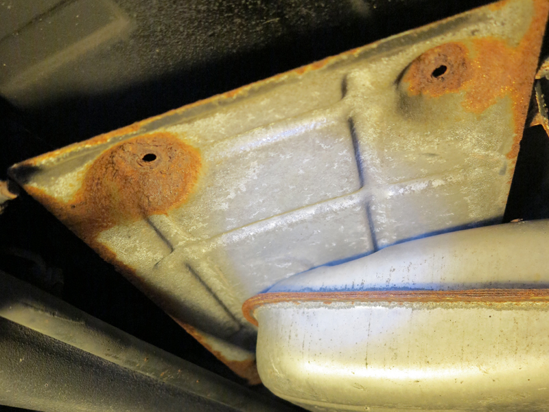

Just the other day I had raised the rear of the car to practice jack stand placements. This morning at cold start there was a rattle, and it was there through out the drive home.
Clamps and hangers seem to be OK, but this item is just sitting there...
Are there nuts missing, any other sign to watch for?
The plate above the muffler is sitting loose...

looks like nuts are missing. Look under it for studs. If no studs, maybe bolts are missing. Hopefully they didn't rust off.

There are four studs, two on passenger side are visible, however, the driver's i was only able to feel.
Could these studs be replaced, from appearance these barely have threads for bolt?

I believe these bolts get those plastic nuts that you finger tighten, just like the plastic cover behind the passenger wheel for the timing belt. I had the same problem but in my case the bolts had rusted away so I just removed the plate. Luckily, I found out I didn't need it when I installed the IPD turboback!
Maybe head to a Midas shop and have them tack it in place?

Location of guard plate suggest it deflects muffler heat. Could it be pulled out for few days, and put back in easily? What coating would help extend its life?vjaneczko wrote:I believe these bolts get those plastic nuts that you finger tighten, just like the plastic cover behind the passenger wheel for the timing belt. I had the same problem but in my case the bolts had rusted away so I just removed the plate. Luckily, I found out I didn't need it when I installed the IPD turboback!
JB Weld, if the nuts don't work. I will pick up new ones from the local volvo this weekend.
Alternatively, is there a two-side threaded cap, like bolting-a-bolt, that could JB Weld to restore/replace these rusted bolts so that the plate is suspended back on.

IIRC, the plate is a little too wide to easily remove without dropping the muffler first.
Yes, it is a heat shield but I figured it's not a huge amount of heat and one could live without it.
