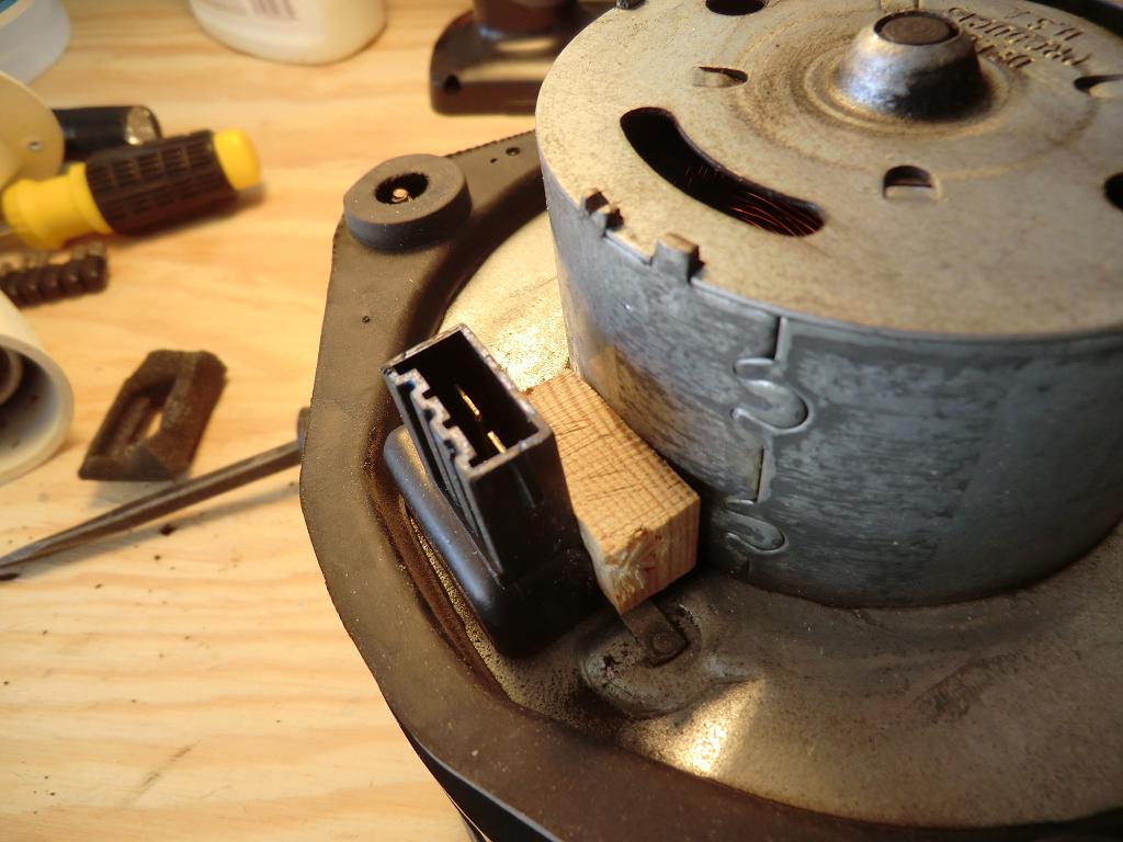

Hey Ozark Lee, You were right on. Even before removing the motor I got the fan to work by jostling that white connector.
However , after cleaning the spades twice with emery board and alcohol and squeezing the connector lightly it still would not work unless I pushed the connector sideways a bit. So I took the motor housing apart and made ( now dont laugh) a small wood wedge that pushes the connector a bit and now the motor works like a champ !
I have a jpeg of it but dont know how to attach here. Thanks for the good advice,
Jack

OK, if this works attached is the wood wedge that moves the fan connector about .020 and completes the connection .
Fan Motor Wedge
Fan Motor Wedge

I lost patience with mine after cleaning my contacts till they were sore and I even cut the connector housing away to prove I had cleaned them. Then I used my test clips straight to the battery and still very little rotation unless pressure was placed on the connector itself. Then swapped the fan from my '99 V70 wreck into my 2000 V70 and placed a garden twig into the same position except that the plastic cover was on and placed it back in the spare car.Image

My gimmick fix only lasted one week, then the motor would operate , or not , depending on how hard a bump I hit. Then I noticed a faint smell of burning and assumed the motor was stalled and maybe shorting. So I gave up the trick fix and bought a new motor from Direct Auto online, free delivery, no tax and only $60 bucks with they say a lifetime warranty.
