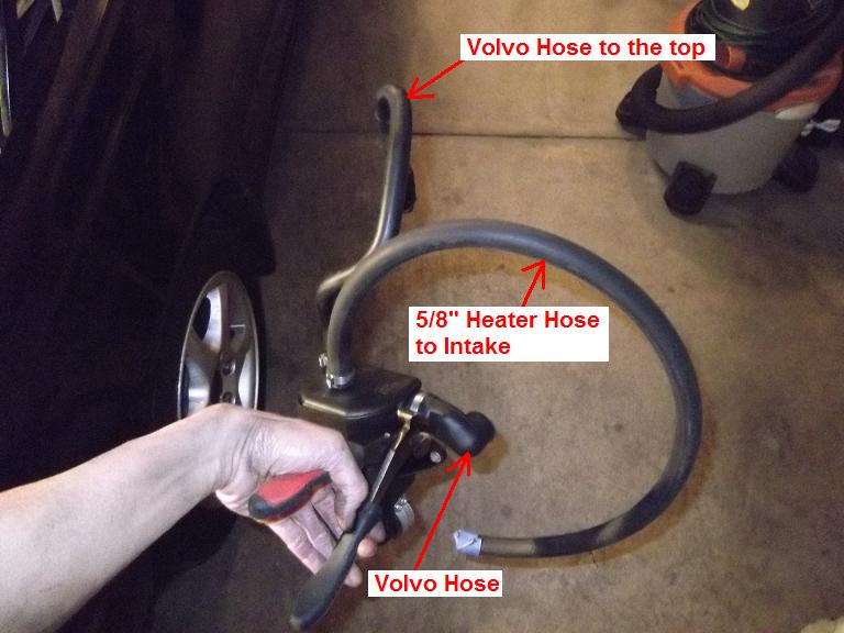

I just did exactly this PCV last weekend. I improvised and will post a DIY later.
This is a job that takes some 6-8h to do, so you don't want to go back in there for another 100K.
Stick to Volvo OEM parts, I spent $150 (same price as IPD or FCP Euro) but I got all OEM parts from Superior Volvo in Kansas City.
The Volvo PN 9471644 (the long tube that contains the vacuum pipe and the vent pipe) is a piece of junk.
The 3/8" plastic pipe broke after 2 years. What a waste of $40.
I ordered a new one but I ended using only the vacuum tube of this thing and substitute with heater hose (ID = 5/8", $6 for 6-foot roll at autoparts store).
Some people use copper pipe (the malleable type that people use to run natural gas line at home) but this is overkill.
The 5/8" heater hose is a perfect fit and allows more blow-by gas to escape (stock is 3/8").
This is a preview of what I modified, I will post a quick DIY later:

This is what I'd recommend (pricing from Superior Volvo in KC):
956561...oetiker clamp...qty = 4; $1.94 x4
976584...oetiker clamp...qty = 2; $2.00 x2
977964...oetiker clamp...qty = 2; $2.58 x 2
8653339...short hose to engine block...$5.85
1271653..hose to engine block... qty = 1; $8.76
1271654..hose to top of engine... qty = 1; $21.24
(I guess you can use heater hose here, just a guess)
1271988...oil trap $29.88
9146266...intake manifold gasket... $13.86
---> 9471644...piece of junk, save $40 for beer! Do NOT buy this. Use heater hose as I mentioned above.
The vacuum part of this, use standard vacuum hose.

Only issue I would have with heater hose is it's not a compounded type of rubber that will resist oil , it's going to break down faster then a proper type .
