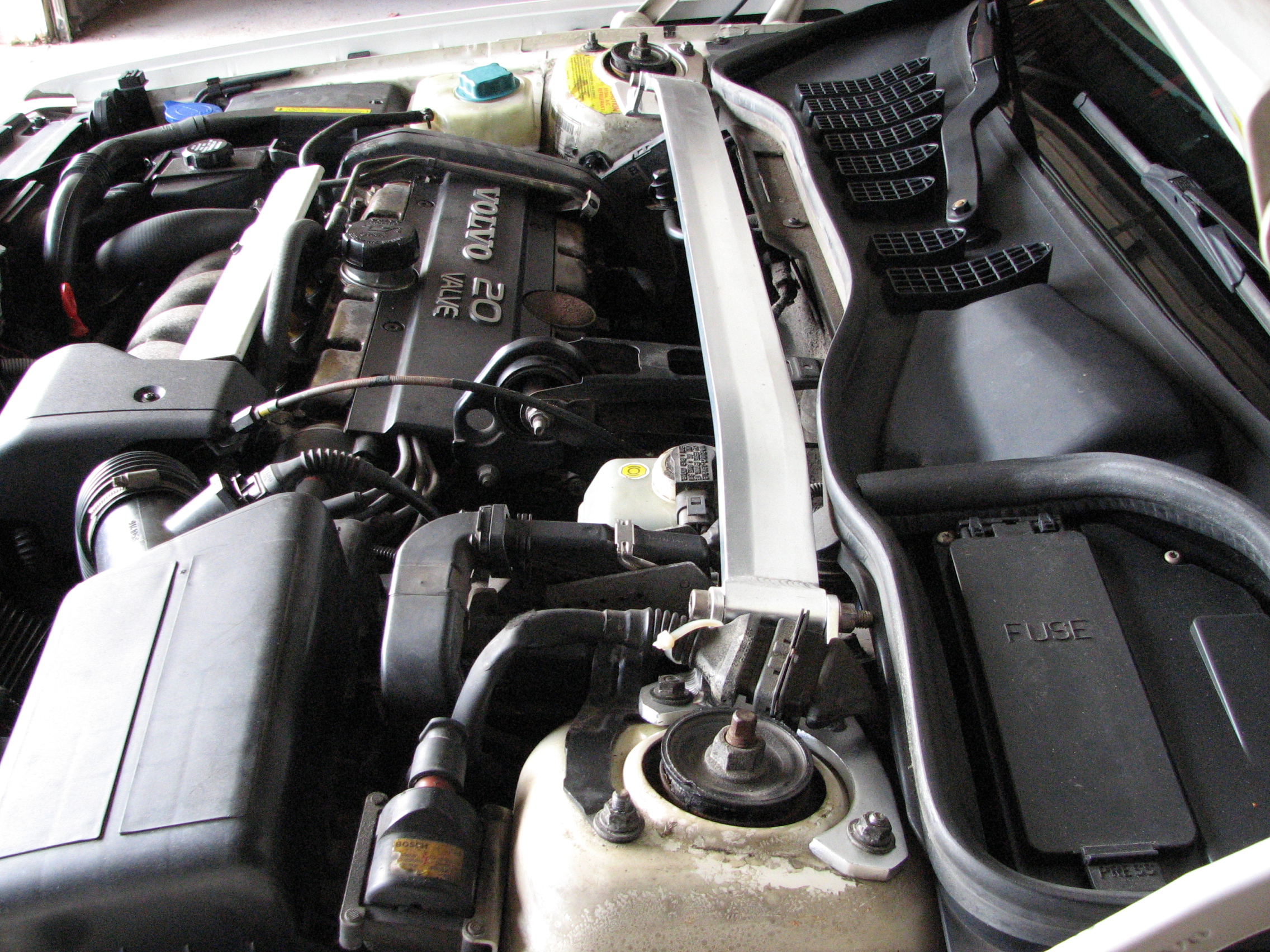

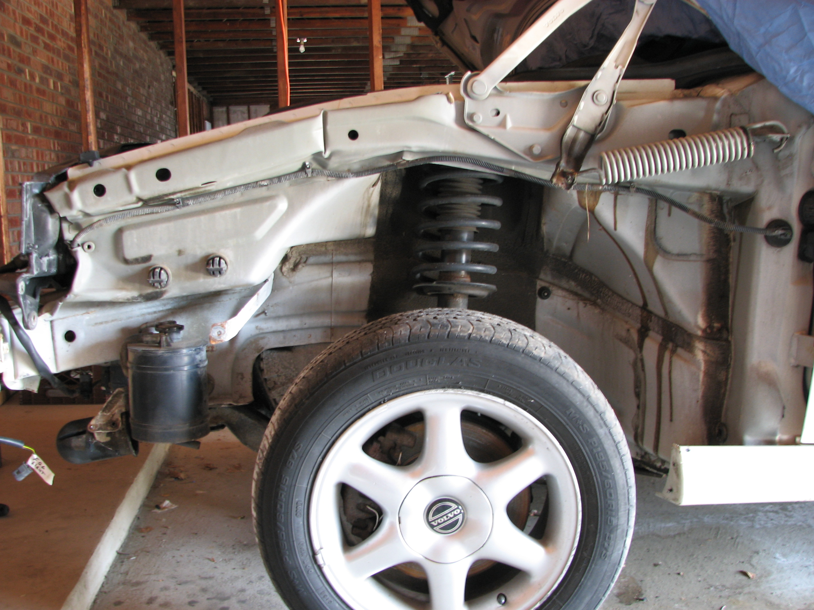

I did notice a substantial feel after intalling the OBX strut brace. It was meant to be additional support for the unibody repair that I had done. It is not a high end racing piece by any means, nor is the '93 n/a.

Regardless, I noticed a stability that was assuring.

^ glad you posted the images of your car before. My r has those same kinks where the inner fenders are tweaked a little.
I can see the price of strut bars rising... and it looks like I need one.

Here is mine which seems to be available again. They were out of stock everywhere when I was looking for it, so I ended up paying more than a new one.
http://www.ebay.com/itm/OBX-Front-Strut ... 7b&vxp=mtr
Ipd has one that people seem to like. You can see the price difference. It is more of the "Track" type, whereas mine is a functional showy type.
http://www.ipdusa.com/products/6520/114 ... -p80-black

Ben850 wrote:Here is mine which seems to be available again. They were out of stock everywhere when I was looking for it, so I ended up paying more than a new one.
I have this one and highly recommend it, especially for the price. One suggestion if you get it; make sure the hex bolt is facing towards the engine and the nut is facing the rear of the car. It'll make it much easier to tighten everything down.
