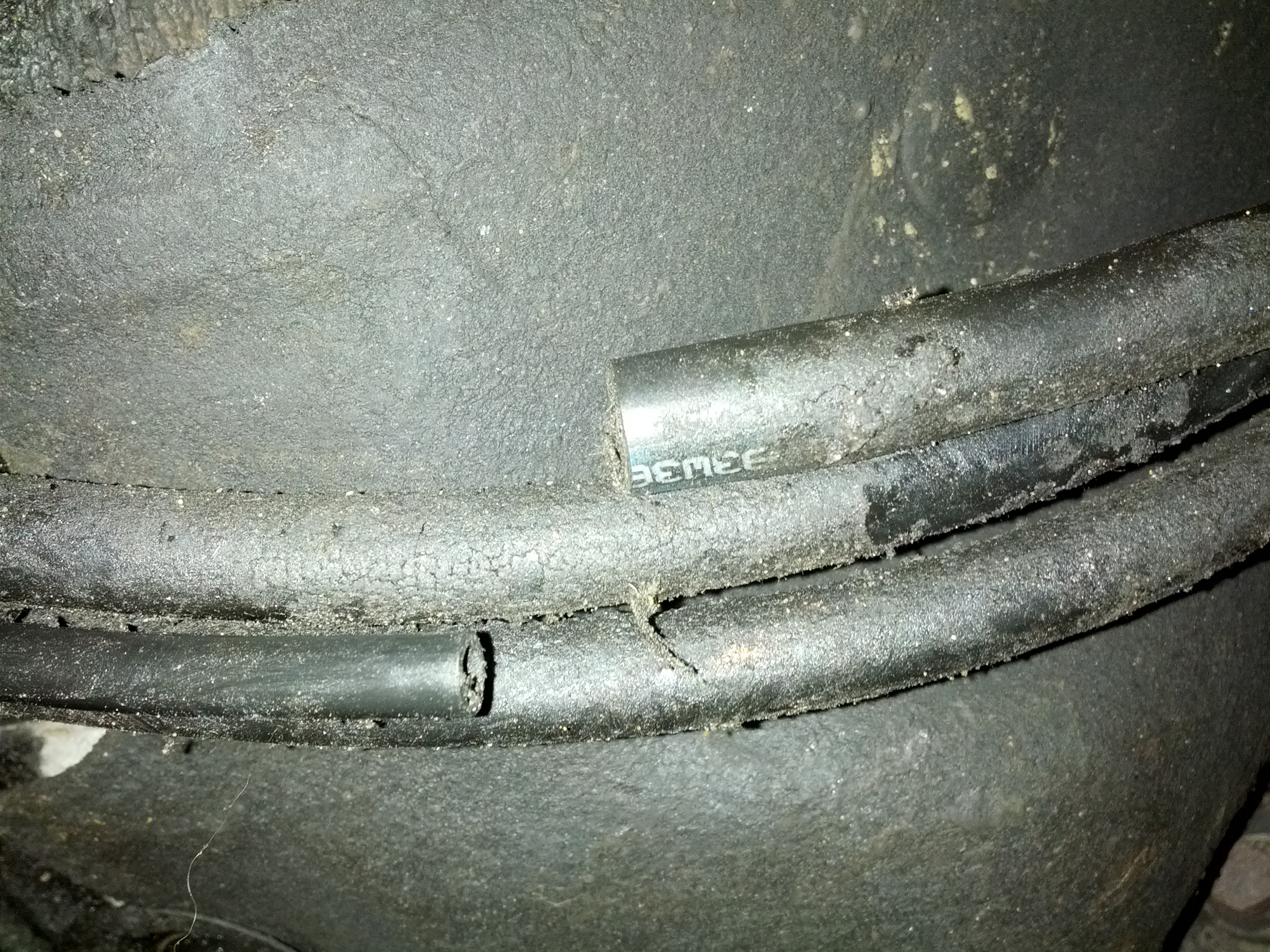

Hey Everyone, I got some bad news...the problem is back again.
I'll try to swap out the battery for a new one. It's been a while since it was replaced last.
I noticed when I pulled the engine/trans awhile ago to replace my Rear Main Seal, there was this vacuum-like line going from the fuel tank to the engine next to the fuel supply and return lines. Looked like it runs along the subframe and connects somewhere around the transmission area (I'm sorry, but I can't remember exactly where it connects). My car has the EGR/Air pump setup. I fixed it, but I'm wondering what could this vacuum line could be used for? Could this be part of the problem?
Passenger side of the car. Fuel supply and return line. Vacuum-like line separated
Thanks everyone!
-volvofan94

That goes back to the EVAP canister in the front fender. Mine came loose after power washing the underside. I believe it was also reponsible for a starting issue I was experiencing after that particular car wash.
That reminds me, I plan on putting a hose clamp on it for a little assurance.

I patched mine up last night. I think the car has been driven with the line disconnected for a while now. :oops:
The new battery has been installed with not much difference in starting. It took several cranks to get it to finally start up. I'm pretty sure it's getting good gas and air, but I'm not too sure about good spark. My thought is to check the ignition coil and spark plugs next.
