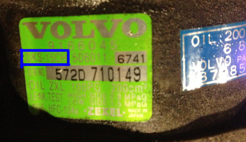

Post by erikv11 »
JDS60's pdf is probably right but I thought Lee has posted that he has seen some of his 850's needed different weight PAG oil. That would be counter to what the pdf says. Or maybe it is because not all have a Zexel compressor. At any rate, you are so close, you might as well be certain. On the green sticker where you got the number you posted, the Zexel model is just to the left. Like this:
The compressor model is inside the hand-drawn blue box. This one is a DKS-15CH, so it uses PAG 46 oil.
AC compressor sticker.jpg (186.59 KiB) Viewed 2086 times
Also, there is no need to order the PAG oil from Volvo. Just get it from any auto parts store.
