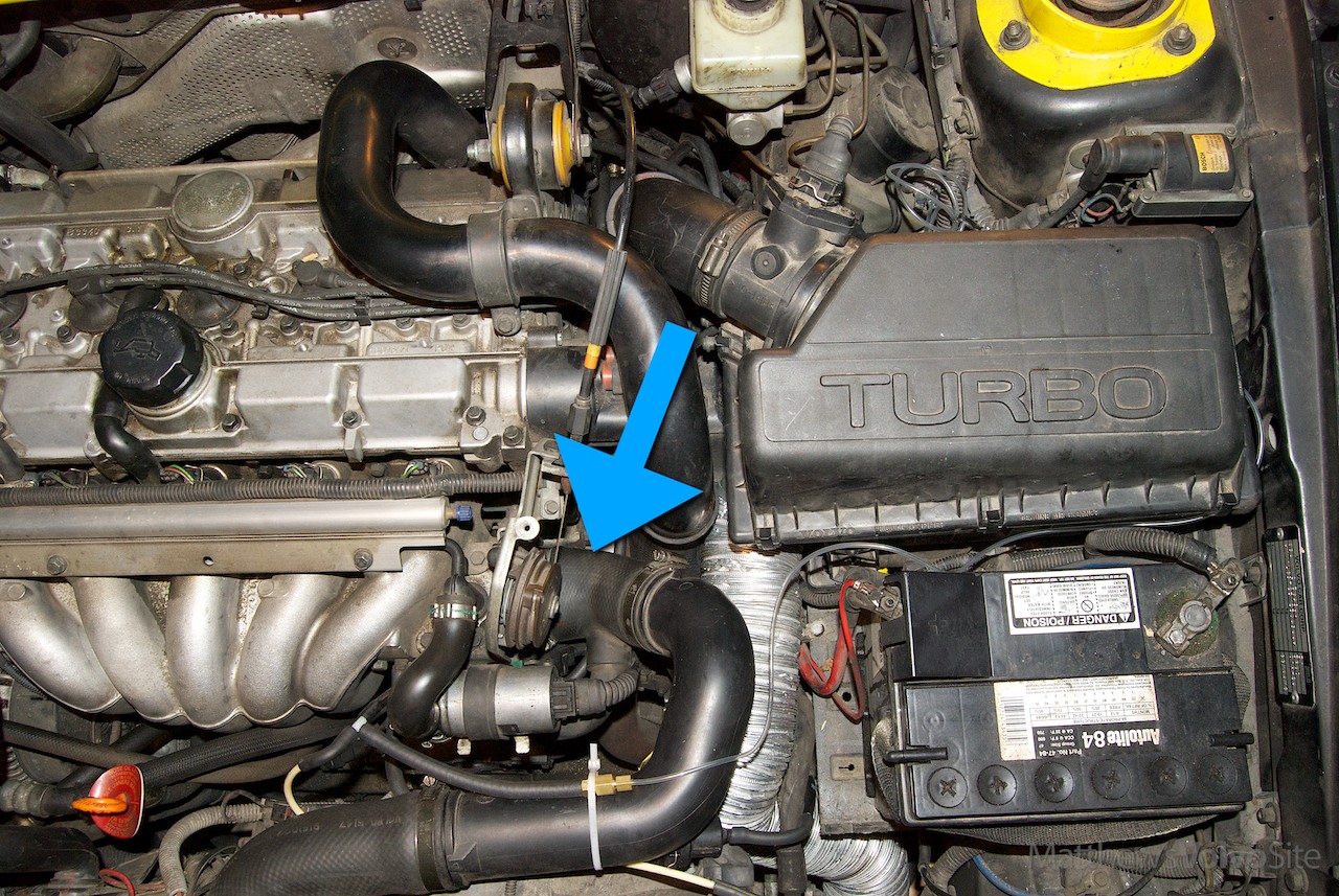

Ensure that the underside of this large intake hose is not slipping off.

just checked all around the intake hose and it is securely on correctly on both ends...
