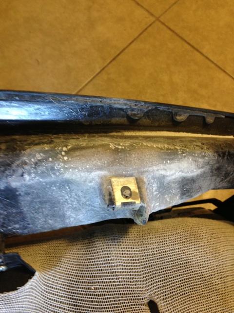

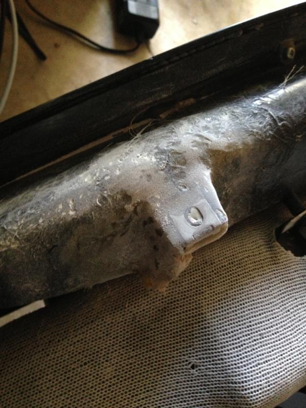

The initial repairs from 5 years ago did work to an extent but they didn't completely remedy the problem. The mounts that were not broken before remained largely unbroken. They tried to break but the reinforcing limited the damage to cracks around the mounts rather than the mount breaking free from the duct.
The previously broken mounts, however, detached again and this time they took more of the defrost duct with them. That said, enough of the reinforcing metal remained affixed to the duct to hold the dashboard in place.
The flaw in the initial reinforcing plan was not the reinforcing strap itself but rather what the strap screwed into as well as the concentration of force on those mounting screws which occupy a small surface area.

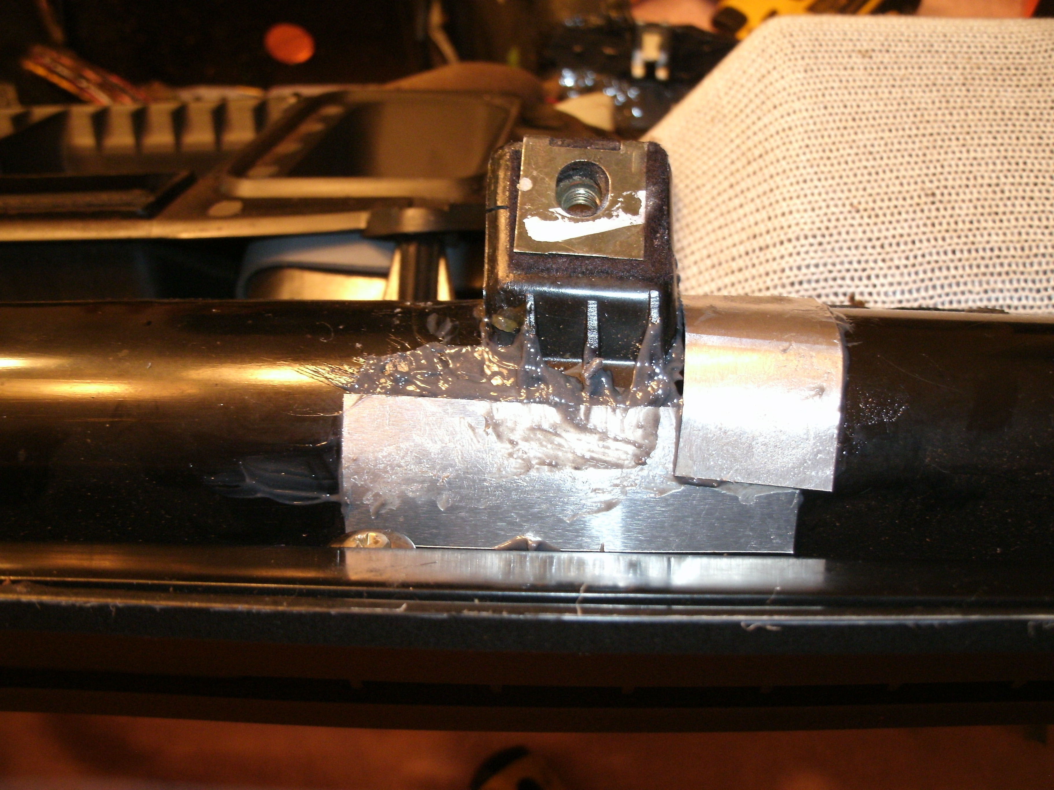

Getting back to the main dashboard mounts I used one of the broken pieces to roughly size a new support. I figured that the new support would need to structurally take the place of the existing mounts so it would need to be reinforced on the sides.
Here is what I came up with.
The breaks on the side supports need to mirror each other. One will fold to the left and the other to the right.
Once the bracket pieces are fabricated they need to be joined. For this I used a small tip on an Oxy /Acetylene torch and silver solder which I had on hand. I use it for soldering ground systems together on radio and TV stations. Soft solder will not be strong enough for this application.
The steel flashing has a zinc plating and the solder doesn't flow well at the joints in its presence. I knocked the plating off with a grinder to get to bare steel so as to provide a good surface for the solder adhesion.
I used welding vice grips hold the parts together for soldering. I will not win any prizes for soldering prettiness but they are plenty strong. The solder joints were made on the inside of the mounts. The heat is much different between soldering copper (which I am used to) and steel (which I don't work with often). The brackets represented a learning experience and they got easier as I adjusted the torch until I was happy with the way the silver solder flowed. I used the silver solder since I had it on hand, brazing rod would be equally as acceptable.
Depending on the condition of the outboard mounts you may need to leave the outer side of the bracket off. As shipped, the outermost OEM mount sides have a fin for additional strength and to also establish a vertical position for the dash. With the fins the additional side support on the new brackets will not fit over the original bracket. One of my side brackets was good but on the other side it was gone. To a large extent, each mount will wind up fitting differently over the original. For the good mount I soldered straps onto the new mounts so as to anchor the outboard side of the new mount to the new surface.
I then used the most substantial broken mount to test fit the bracket. The top of the OEM mount is flat and going into the corner may have left more excess bracket height than the firewall side of the mounts would be happy with. So as to not alter the final mount height I used a Dremel tool with a cutoff wheel to nip off the very top portion of the new bracket.
The next step is to spot the bolt hole in the new brackets. Drilling sheet metal is always a problem unless the holes are drilled before the pieces are fabricated but the final location of the holes can vary depending on how things finally fit together. The only advice I can give is to start off small, at about a 1/8” bit, and step your way up. This prevents the drill bit from grabbing at the end of its cut and wadding your new mount around the drill bit. My final hole size was 3/8”.
From here I began the new mounting bases. I started on the mounts that were still in relatively good shape so as to come up with methods and procedures that I could use on the mounts that were going to be patched together. I roughly formed a full 5”x 7” piece of the aluminum flashing around the contour of the defroster duct and then “eyeballed” a spot to cut out the rectangular piece to slide around the existing dash mount. Once again, the Dremel tool with the cutoff wheel is handy to cut the rectangular opening in the middle of the sheet. Most of the sheets needed a relief cut to allow the aluminum to take the shape of the molded air duct.
With the opening cut, I finished forming the aluminum around the duct and then drilled holes to accept pop rivets. The rivets were standard 1/8” diameter, 1/4” grip aluminum rivets. When drilling the holes, push a rivet into the hole you just drilled before drilling the next hole. This keeps the plate form shifting as you drill the holes. For the rivets on the “nose” of the duct you need to spot the holes high enough and at an angle that will allow the rivet tool to clear the front portion of the dashboard. I then removed the new backer plate, cleaned and deburred the inside surface, and wiped down the duct itself where the back plate would fit. On most of the new backer plates I had to make a relief cut so as to allow the plate to follow the original duct contour.
What I wanted to accomplish was effectively a laminate for the backer plate. At this point I mixed up about 1/3 of the tube of epoxy and spread it evenly across the backer plate. And then repositioned it on the duct. I then started the rivets again, starting in the corners and worked my way back. Have your drill with an 1/8” bit hand at this step as you may need to re-drill some of the holes. The epoxy starts to go off in about 4 ½ minutes so time is of the essence. You want to get the backer plate in place and riveted down while the epoxy is still fluid. The tighter the aluminum plate fits to the contour of the duct the better the overall lamination will be. Once the backer is riveted down you can mix up a bit more epoxy and then rivet the new mounts in position.
Having completed the mounts that were still in one piece I moved on to the more daunting task of trying to rebuild the other old mounts that had completely detached from the duct. Find what pieces you can and, start by epoxying the pieces in place. The main mount will usually have at least a portion where it can be matched up to spot its original location and orientation. Keep in mind that this part of the repair will not be structurally significant, it simply provides a location and orientation of the original mount to locate and orient the new mounting bracket that will do all of the work. Also at this stage I cut appropriately sized patches to cover the remaining gaps in the ductwork where the pieces were too small to try to glue back in place.
For these parts you appreciate how quickly the epoxy will set up, about the only way to piece the parts back together is to hold the mount in place with your fingers until the epoxy sets. Once the pieces are set in place you can continue with the backer plate fabrication and the installation of the new mounts.
