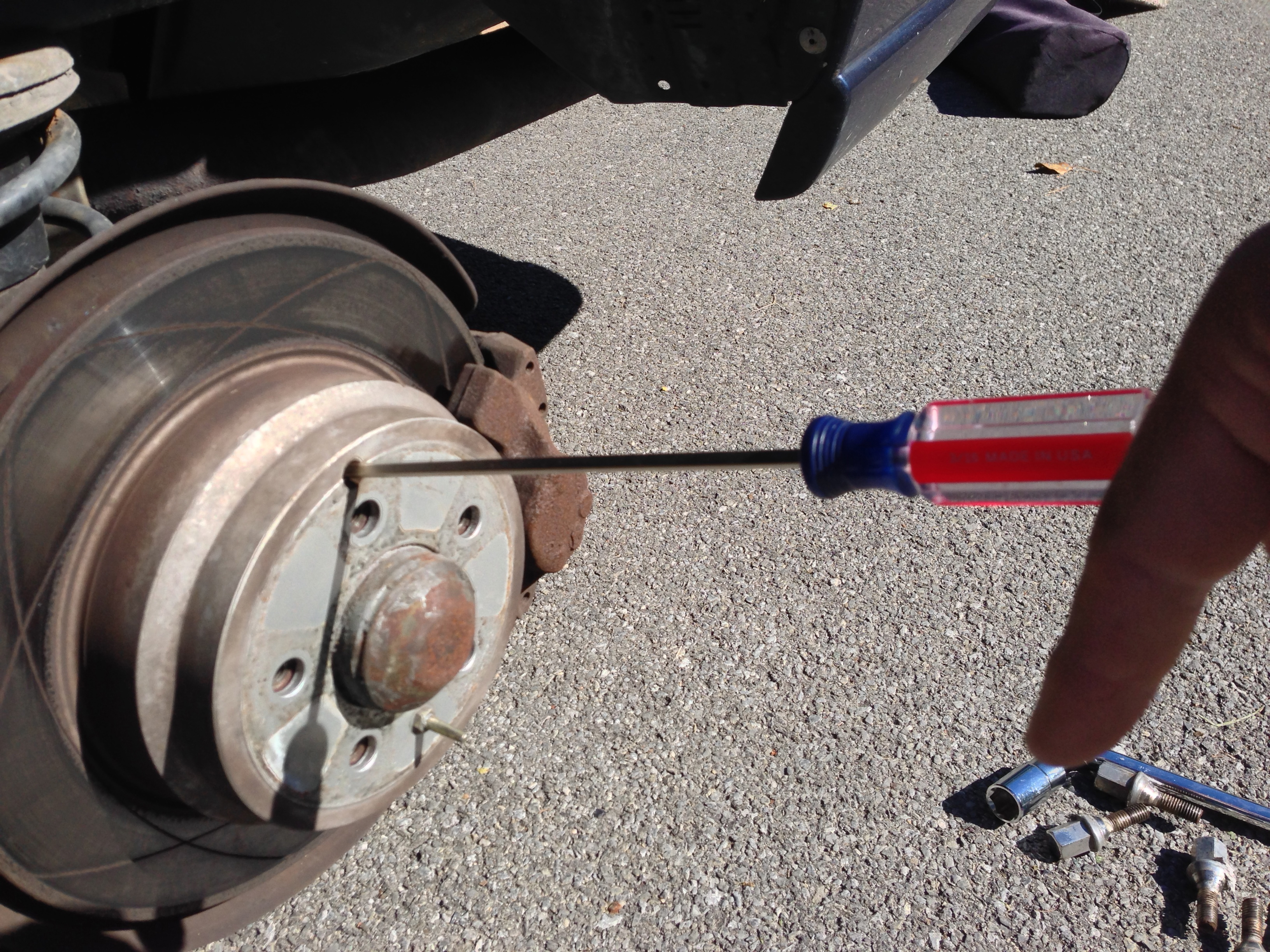

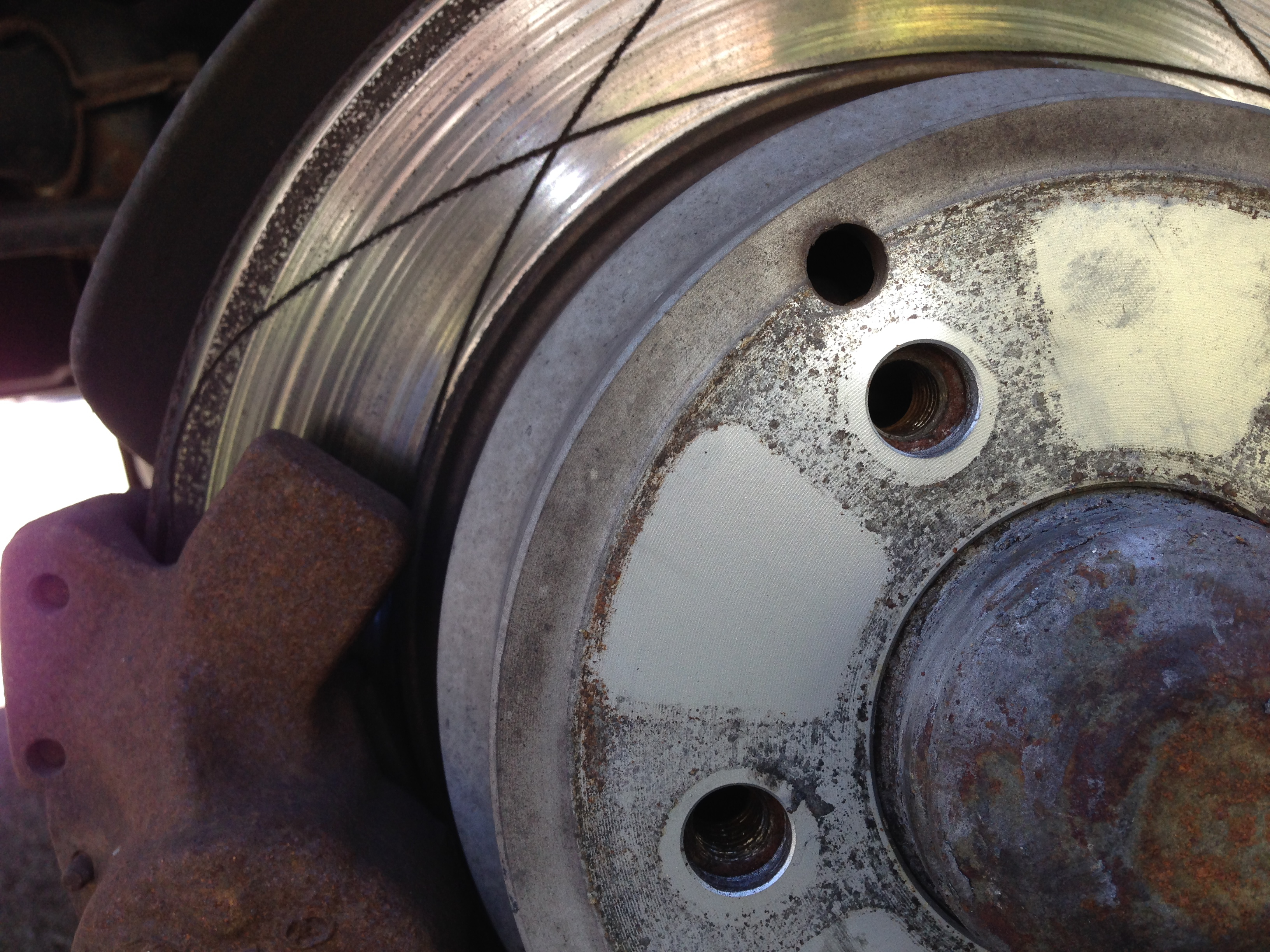

On my car, you adjust the clearance inside the rear brake drums (integral with brake rotor)

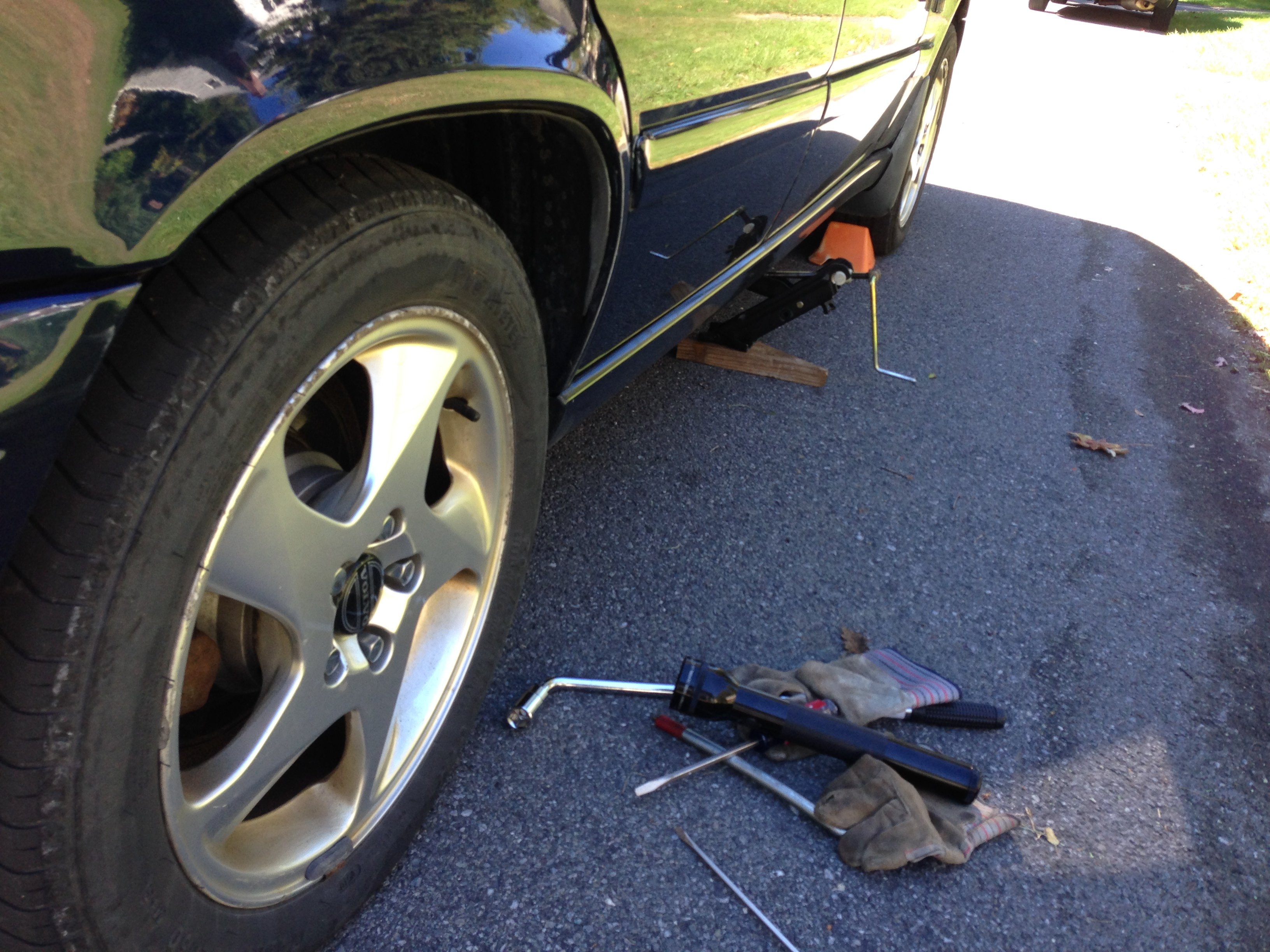

I did this one wheel at a time, on the car jack. No part of my body ever went under any part of the car in this configuration. If you need to go under, use JACK STANDS, no wood, trees, cinder blocks (NO NO NO) bricks

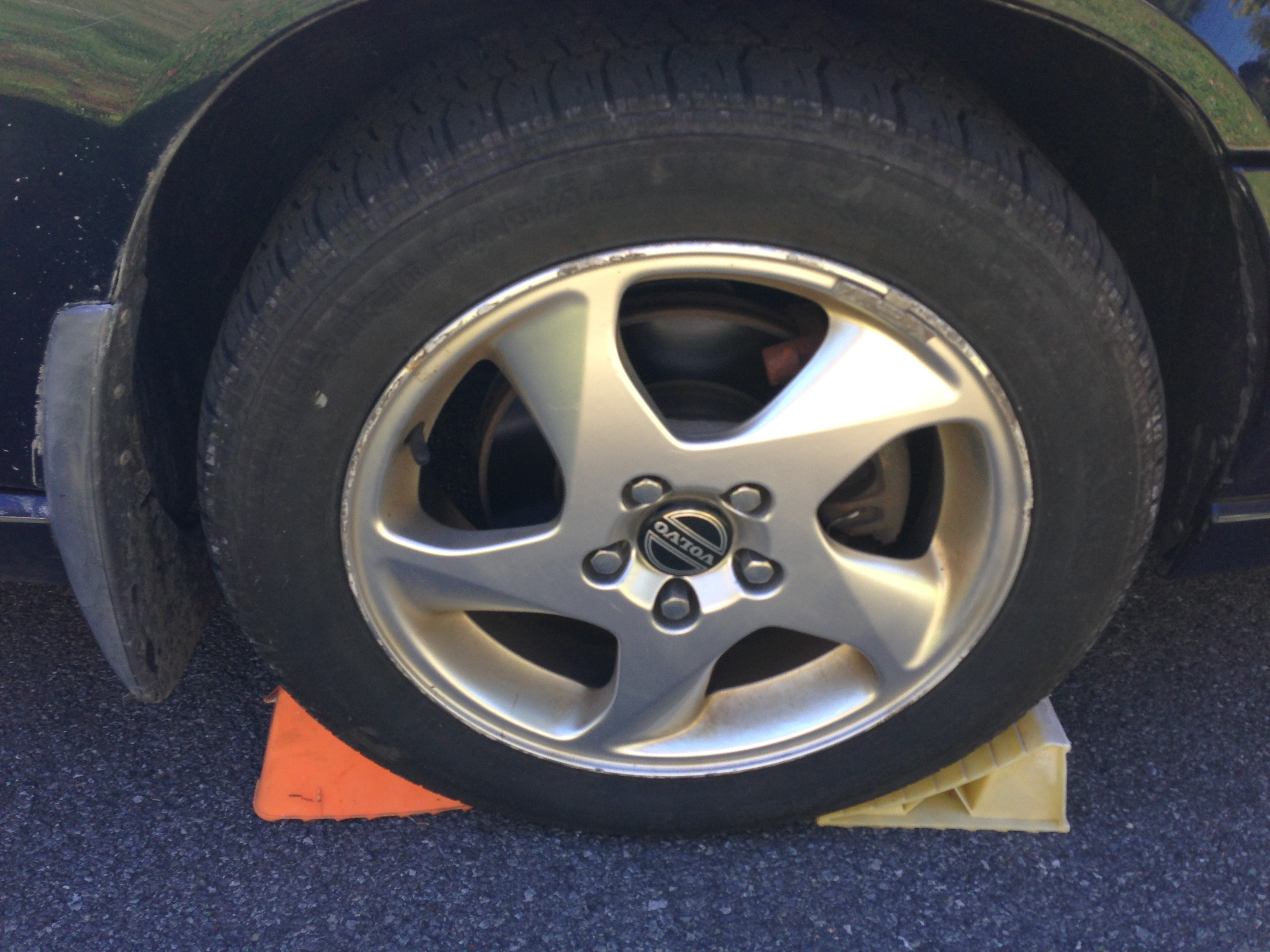

Block the front wheel diagonally from the rear wheel you are working on.
Whats wrong with this configuration?

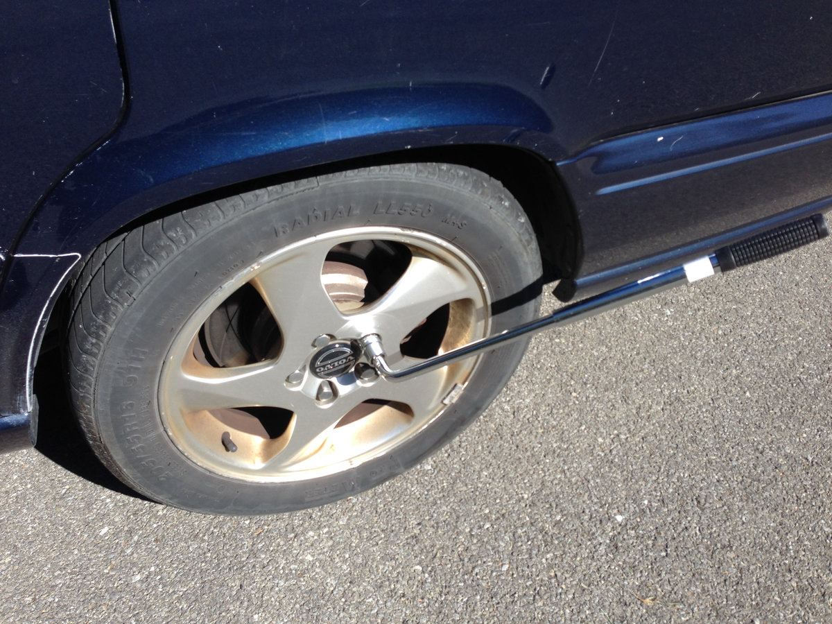

Crack the lugs nuts before jacking
LHS adjuster hole (above lug bolt holes) in roughly 12 0/c position - ready to turn adjuster. Push down on screwdriver to turn outside face of star wheel UP to tighten on LHS. I got about 8 clicks on this side, and 1-2 clicks back to ease drum to turn freely.
RHS hole uncovers adjuster at about 11 o/C postion - also tightened by turning star wheel UP (push down on screwdriver). I got 12 clicks on this side, and 2 clicks back to ease drum to turn freely
End result - 4 clicks on parking brake handle in car gives excellent braking and holding.
