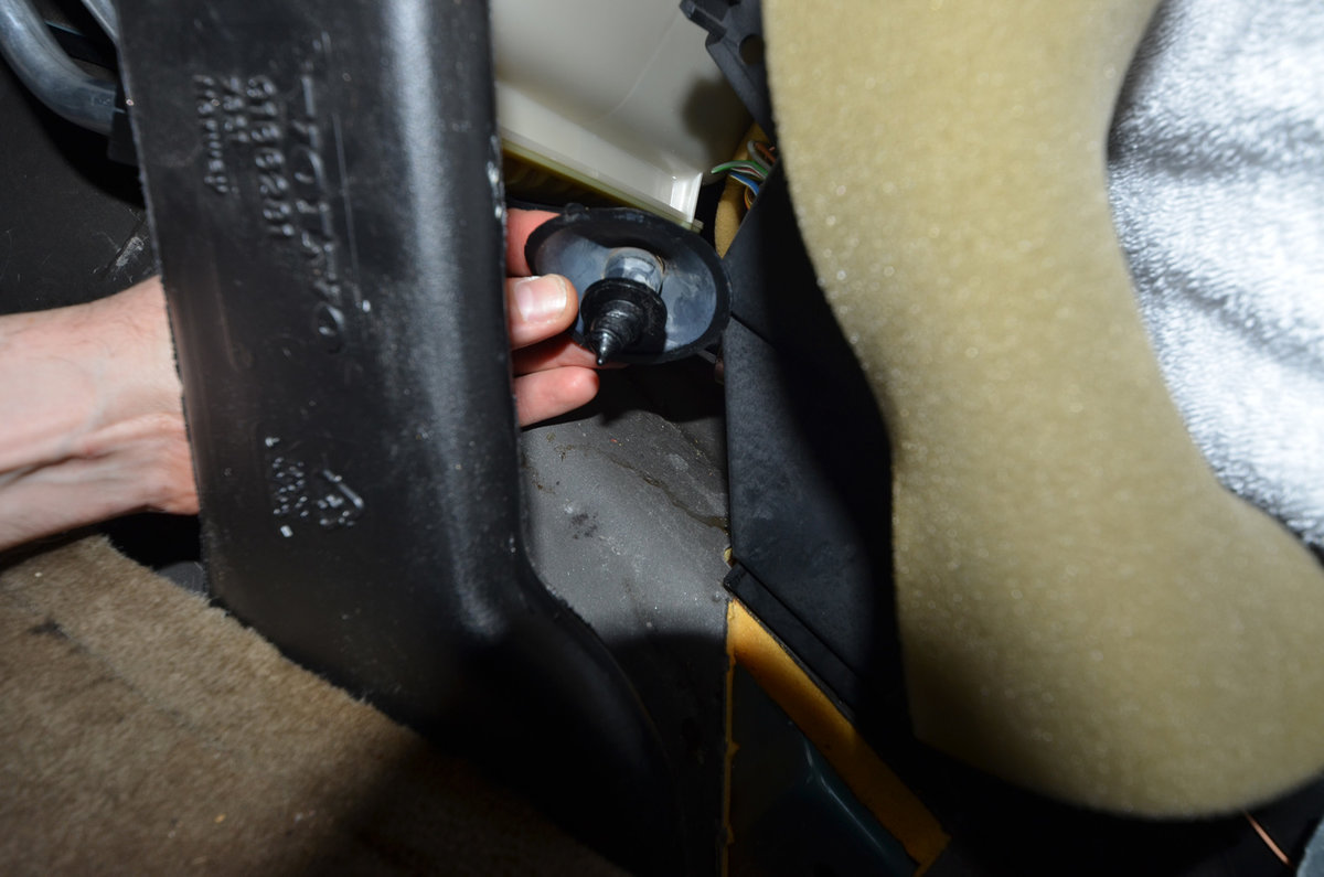

Hi, I am working on my evaporator right now and I see a strange looking drainage pipe end that goes from the climate control unit to the center console floor (see picture). The end of the pipe looks like it is fused. There is no hole. Is this the AC condensation water drain? If yes, it is completely fused. I actually have a problem now with AC condensation water drainage. It is not draining. I wonder is this the cause? or is the AC drainage somewhere else. My thought is the catalytic converter gets too hot on the inlet and melted the plastic from that pipe end fusing it.

That is the AC drain, I don't remember what mine looked like on the bottom when I did my evap on my 99. I thought it was just open, with no check valve. Does it look melted on the end?

Is that a "check valve" on the pipe end? It looks to me like it is fused. There is not hole at the end of that pipe.

I see, It is something Volvo put there. Vida calls it Hose connection PN 8663397. I will pull it off to look at it. My AC is not draining condensation water now. Is this the only pipe that would get clogged?
