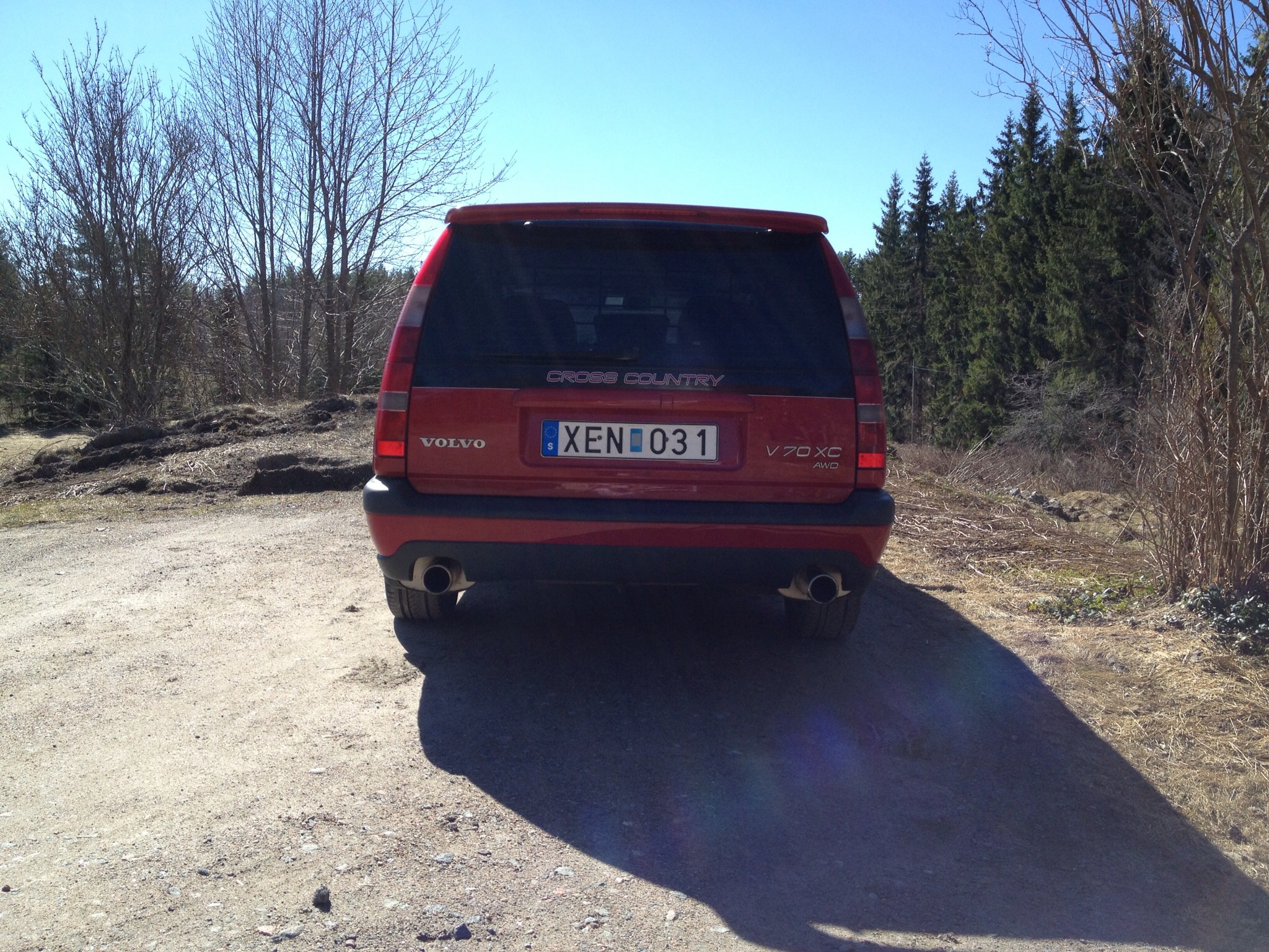

Excuse the poor grammar on my last post. I noticed a mistake but anyways I forgot to mention the exhaust is weird on 70 series AWD. The tailpipe comes out the right side instead of the left. There is a muffler on each side. The right side has an exhaust tip and comes out the bumper and the left side is a dead muffler. It's plumbed in but there is no exit on it and the bumper has a weird plastic cover over it. It's a weird look but definitely differentiates it from fwd models. I think they did it because a dual setup was too noisy. Wouldn't be hard to weld a new muffler with tip on though

drgswede1978
- Posts: 45
- Joined: 02 Sep 2012, 12:29
- Year and Model: XC70 1998
- Location: Sweden
