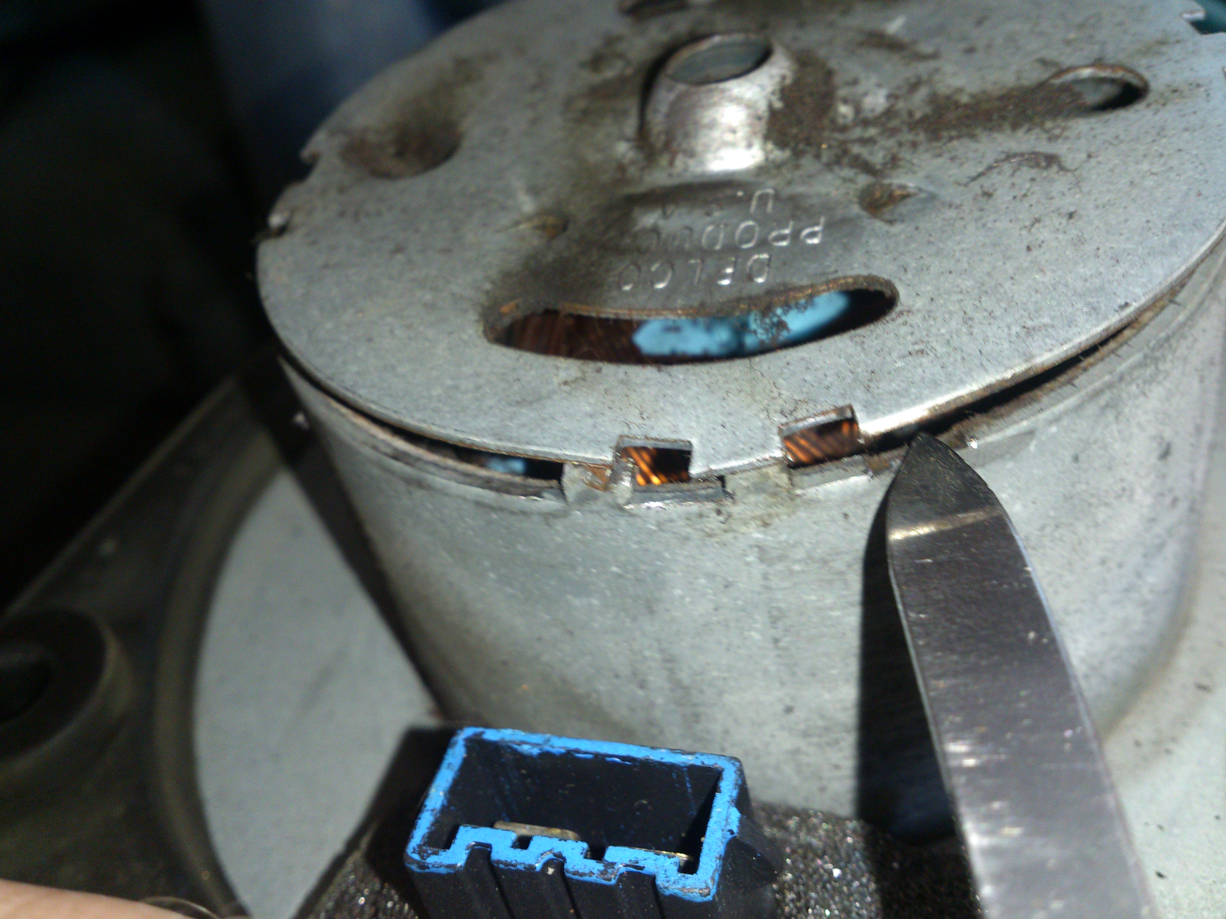

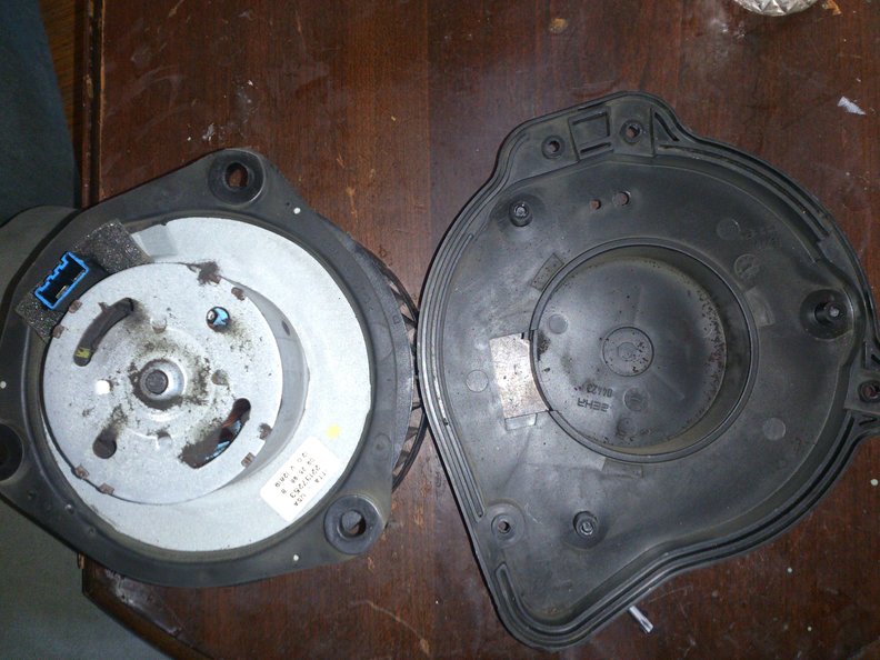

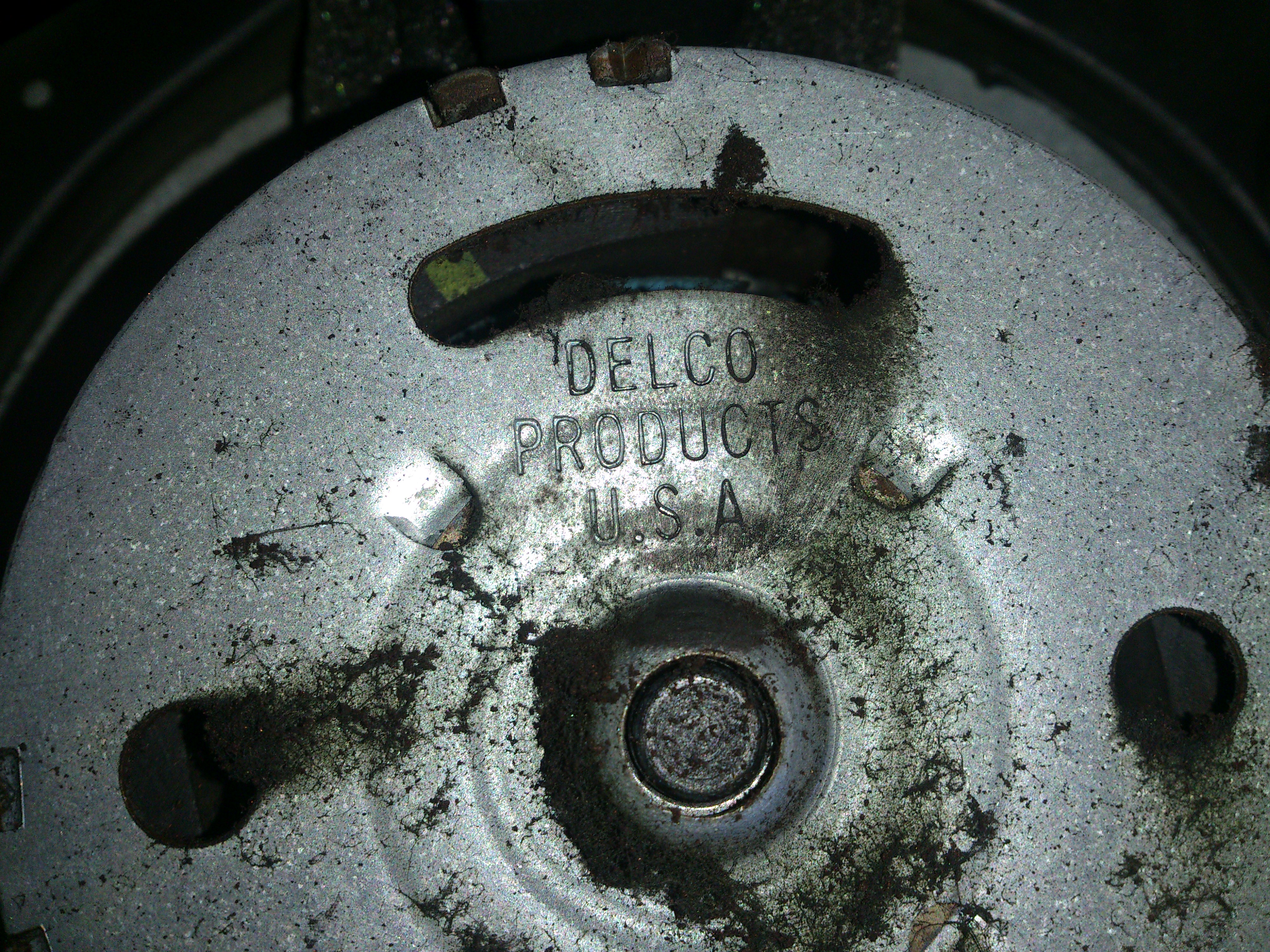

This Motor says "Behr France" and a date of June 1998 and I found no evidence of tampering/replacement before myself. After removing the three TORX screws and seperating the plastic from the motor, I found the motor to be stamped with "DELCO Products USA"
Delco USA? What the heck? HAs this blower been replaced?
So, I figured I'd go ahead and open this sucker up.

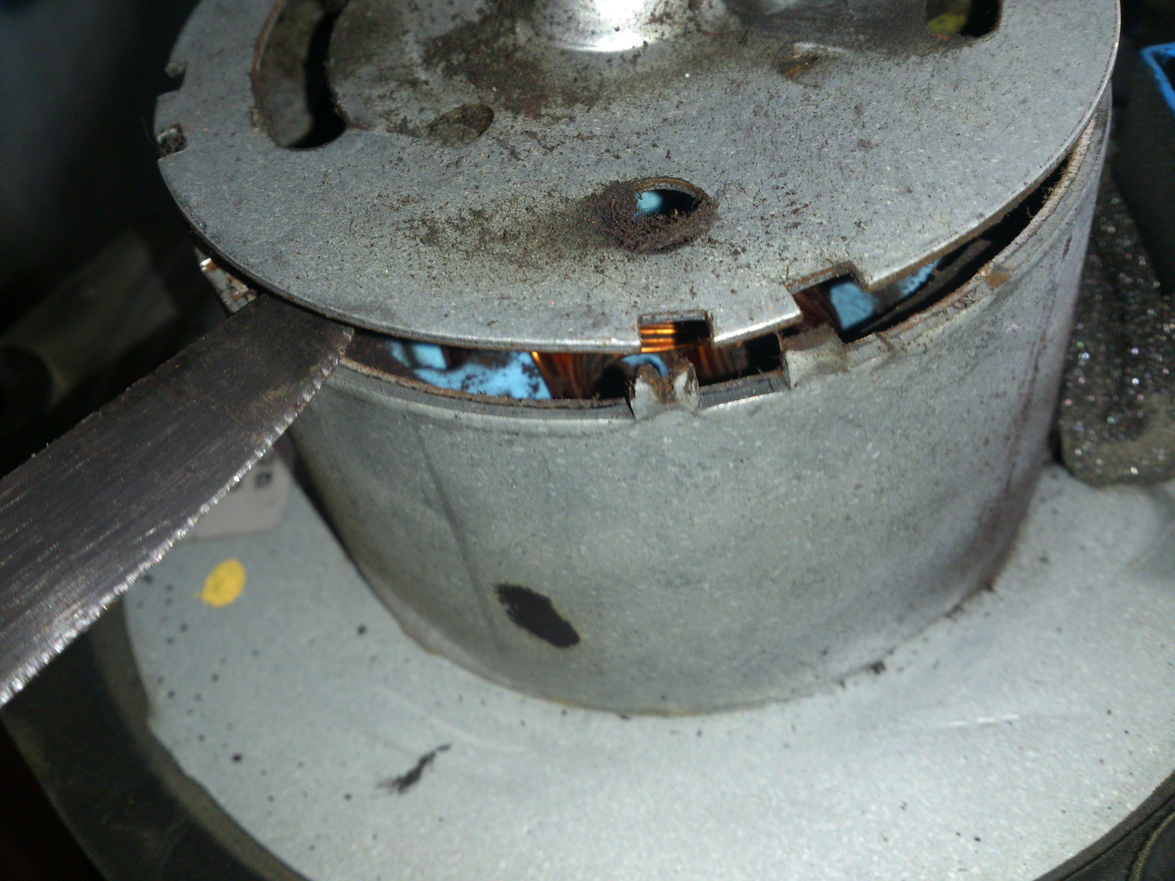

It was simple, it has four metal tabs which fit into cutouts on the round end plate. The tabs are split down the center as to cause them to expand hence securing the
plate to the magnet body. I squeezed the tabs back together with channel locks, then with a regular flat head screwdriver located a notch that allows seperation of the plate and body through prying.

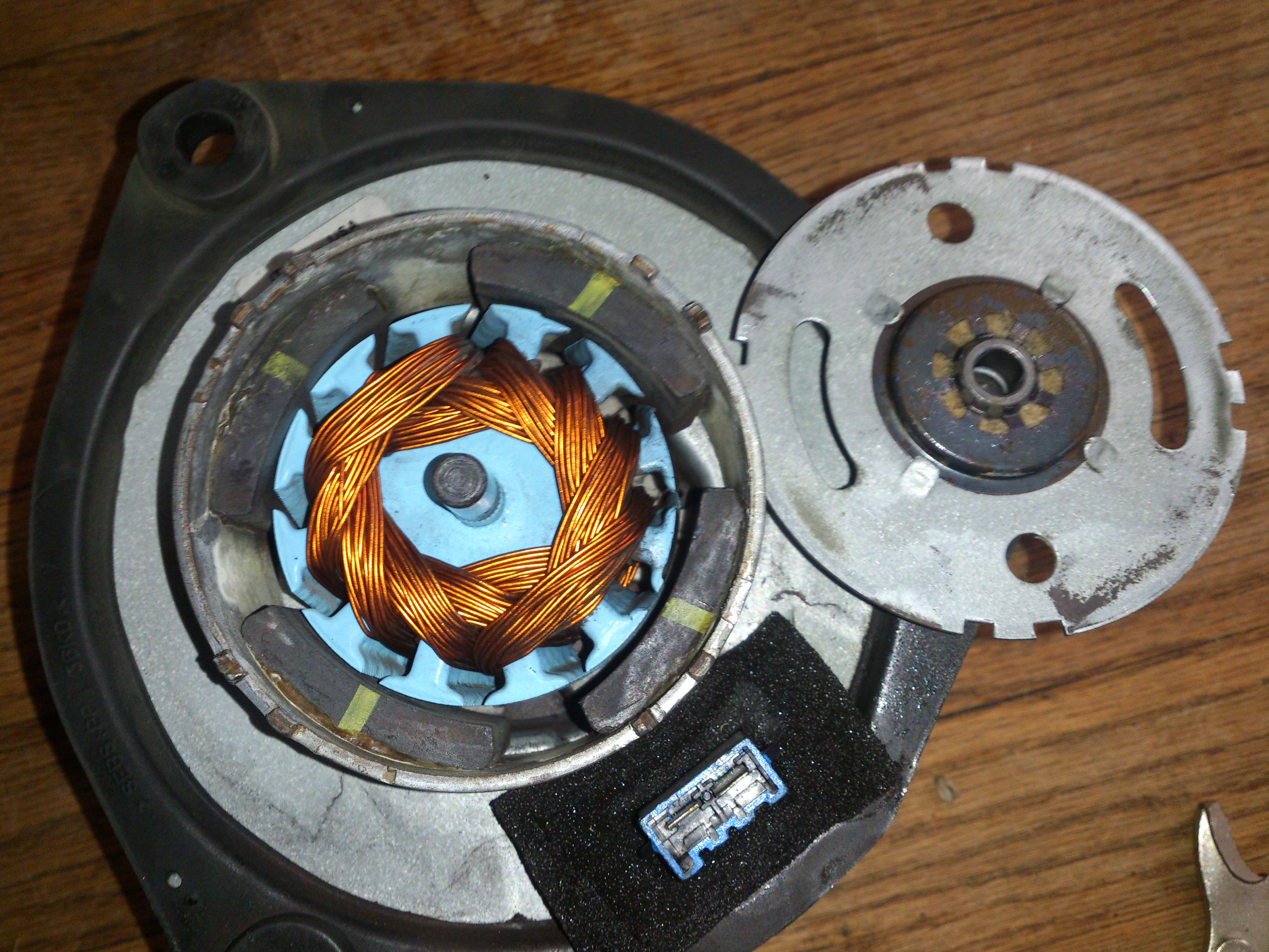

The internal windings, magnets, and in general everything were filthy with slightly sticky black carbon and dust. I sprayed brake cleaner through the open side and through the ports on the fan side. A shower of black turned clean. I then blew out motor with compressed air, confirming it was dry and placed the end cover back in place. The tabs were bent back, motor and plastic cover reunited and I was done.
It looked much cleaner, the blower no longer made any noise when turning the wheel by hand so I applied 12 volts to it and bam! Dead quiet, very strong air movement.

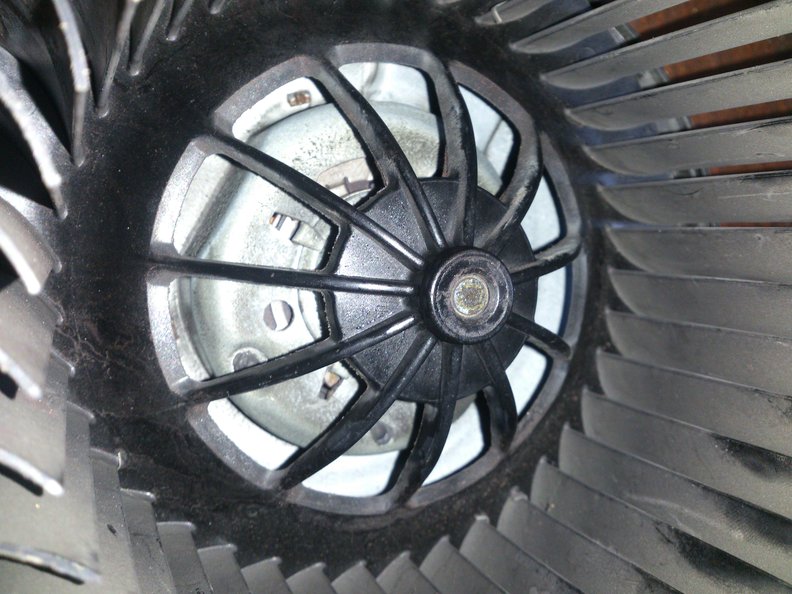

Now as a side note. I didn't completely disassemble the entire motor, only removed the rear cap. In order to remove the entire assembly, the fan wheel would need pulled off the shaft. I saw no need for this so I left it on since my only intention was to clean it and not inspect the internal electricals. Also, it is most likely possible to clean it without even removing the rear cap by spraying through the small holes but I would think this would take longer and may not clean/drain as well.
