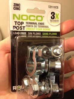

I have these:
and
Now from what I can tell thus far, all I need is the proper gauge wire.
Summary:
This is my primary question: I have no idea what to look for (or even where to look for) in proper battery cabling. I figure 100% copper is good.
I would really appreciate knowing:
#1: The wire gauge (what you recommend, I think stock is 4 gauge?)
#2: The lengths, if you know it
#3: How should I go about connecting the block ground to the chassis/battery ground wire?
- combine them into one "cable lug" and crimp it?
- use a separate "cable lug" for the end of each wire and then stack them on the chassis ground point?
#4: Anything else I should know about making my own battery cables?

#1: I would get the 1/0 gauge welding cables.
#2: 15ft would do all the cables, alternator to starter, starter to battery, engine block ground, chassis ground.
#3: I ground both at the battery, see below pic.
#4: See below
#5: I sanded the block down to get a good surface and just ground.

tryingbe wrote:I upgraded my alternator to starter, starter to battery, battery to ground, and battery to chassis cables with thick 1/0 gauge welding cable. It's at least 70% thicker than stock.
Here are what you want to buy.
http://www.ebay.com/itm/181074818504?ss ... 1497.l2649
http://www.ebay.com/itm/261298170208?ss ... 1497.l2649
http://www.harborfreight.com/hydraulic- ... 66150.html
And two battery terminal that you can get at your auto part store.
With everything on, the voltage drop between the pos of the alternator and the pos end of the battery is now .07 V vs .7 V before.
