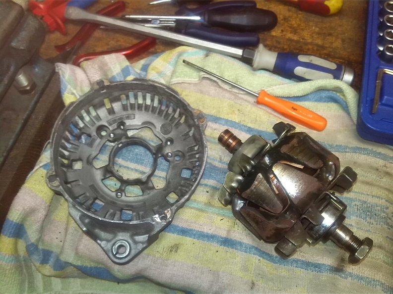

To remove the shaft from the front housing, I have inserted a plunger in the pulley end of the shaft (it is hollow) and knocked the plunger with the parts above on a vice (shaft vertically, the plunger is below and I just hit the whole thing onto the vice – I was a bit desperate at this point, so I simply forgot to take pic... see second pic for advice). If you repeat that several times, the front bearing will come out slowly from the housing.
Now you should have the two housings and the shaft assembly apart.
Shaft assembly with front housing
To remove the rear bearing use a bearing removal tool. Be aware that the rear end of the shaft is the slip ring itself, which is plastic. It is hollow and some millimeter deeper there is the actual steel shaft. So to avoid damaging the original slip ring with the bearing removal tool, I have put an M3 nut in the hollow end of the slip ring. It was just enough to have a good point for the removal tool's shaft .
To remove the front bearing you have to pry off the washer below the pulley first. You can do that with two large flathead screwdriver. Some penetrating oil could be useful here. Note the orientation of the washer (the stepped side towards the bearing).
Now comes the funny part. Grip the front bearing gently in the vice. Place a rag or some kind of towel over the shaft and now let all of your anger, frustration and hate into that bearing by simply crashing it with the vice. Clean off the remaining of the outer ring and the balls. (Obviously be careful not to damage the shaft assembly with this step, so be carefully to grip only the bearing).
To remove the internal ring of the bearing you have grind down that ring until the shaft. I have used a 1mm cutting disc to cut really close to the shaft, and after that grind it further until the shaft was just visible. When you have reached the shaft, you can try to rotate the ring (i. e. punch it with a plunger and hammer). If the material is thick enough near the cut, it will break and then you can pry it off with 2 flathead screwdrivers just enough to place a bearing removal tool below.
(already pried up a bit)
(I used the same tool for the rear bearing)
As the shaft was rusted below the ring, I have used a fine sandpaper to polish it.
