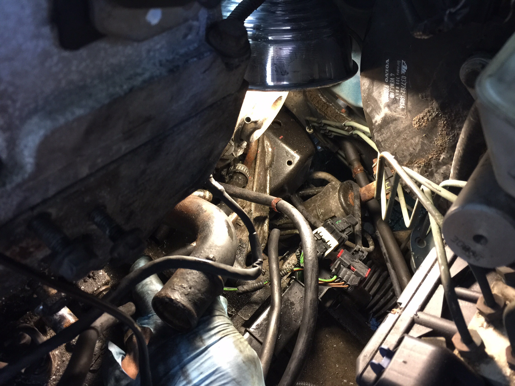

Approaching the beast...turbo pipe, cooling hoses removed
Here is the winter of your disconnect....

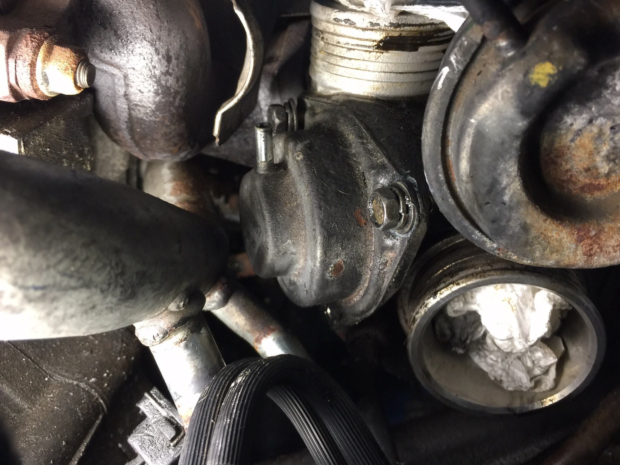

Bolt number one, 10mm wrenches off easy..you are 1/3 done and sitting pretty.
Bolt number 2, at the bottom, you go underneath since your hand won't fit from top. Note the shiny part of the turbo coolant return pipe. You guessed it...the bolt will not clear the pipe with it installed, so plan on replacing that hose for this job. From below, left hand to start the threads, it is tough moving cover to align but it must be done. Tension bolt number one so that the cover moves but stays in place.
Bolt number 3, tucked behind the heat shield, is the spawn of the Devils seed. You can't get fingers nor tool in from the side, so you approach it from the top with right hand, jockey the cover with left to get the bolt aligned. I actually fed into the hole with a Kelly clamp I stole from surgery.
When you feel the threads catch, rejoice, turn it down, the go up top with your open end 10mm and turn it in , in 1/12 rotation increments, inverting your wrench each time.
Hopefully you won't do what I did, and get the cover on, then look under the car and see your BCV spring and diaphragm fell out and yuk have to remove and replace again. Elapsed time, 3 hours.

I actually think that is the Compressor Bypass Valve (CBV). It is essentially a Blowoff Valve (BOV) that is a closed loop and returns air to the turbo intake rather than just dumping it.
I've had several turbos on and off and it might just be easier to loosen the turbo from the exhaust manifold to get to the bottom bolt. That said I've not yet tried to change one while the turbo is installed. I have a bad one on the platinum and I need to though.

When I was doing my turbo coolant hose, I had to go from above, and the most comfortable way I found to do it was to climb up onto the engine.
Can't remember exactly how I did it - I have some vague memories of putting my knees on the engine block, and I may have lain on my side at some point - but this kept my hands free to hold and manipulate things while my back wasn't bending over the car.
I am a small person so this might not work for everyone. You have to be careful not to put weight on the fan shroud or on the intake manifold far from the block.
Also, I highly recommend a headlamp for pretty much any job you're not doing outdoors in the sunlight. You'll look like a dork, but aren't we scraping up our hands and emptying our wallets for old Volvos? Bit late to worry about that.
