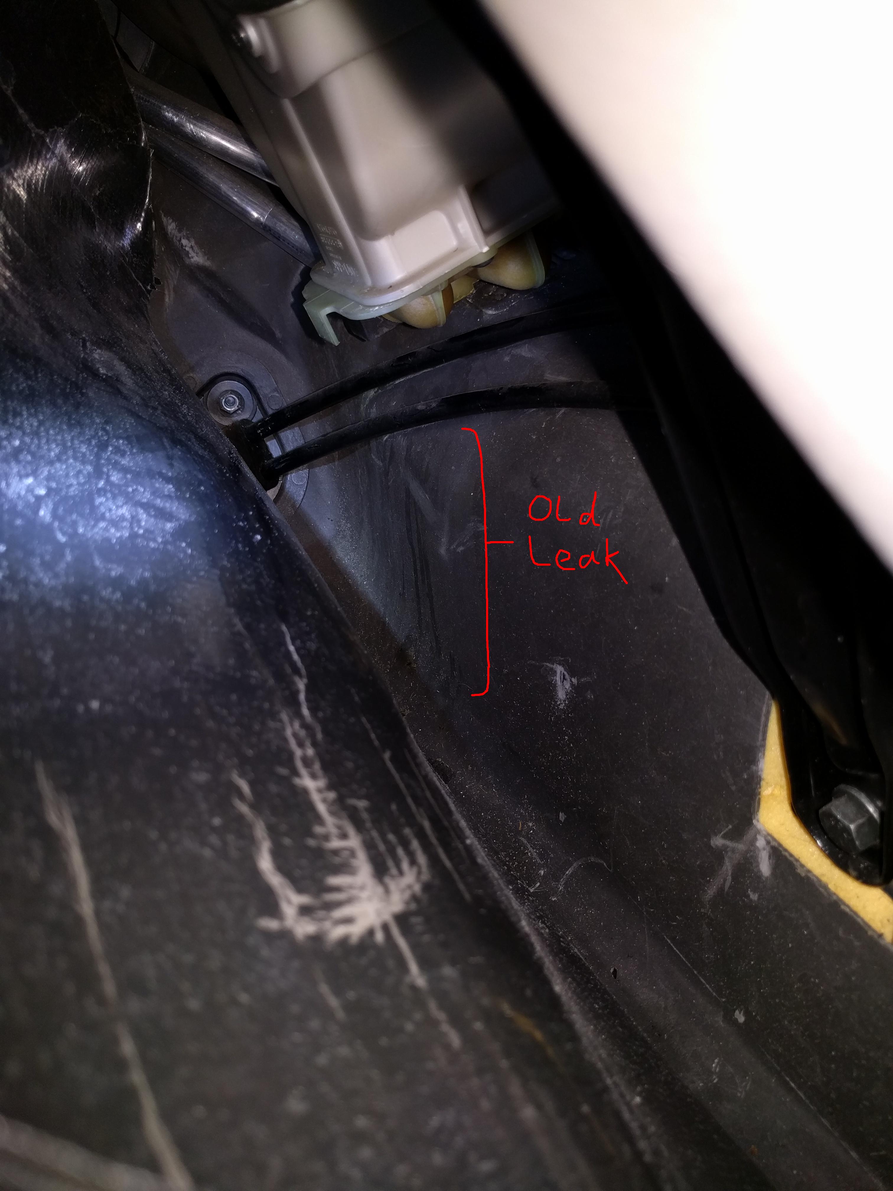

My 2000 V70 with 250k miles has had coolant under the front driver's carpet for a while now. I'm not sure when it happened since my coolant level is at max. Suspecting a leak at the heater core, I pulled back the carpet and saw some old evidence of leakage. I observed no leaks while idling the engine up to temp for about 10 mins while changing the heat and vent settings.
Under the first layer of carpet was slightly damp. The mass of coolant was soaked into the rubberized foam beneath the carpet, oozing up through cracks in the rubber. I've got to remove both the carpet and rubberized foam to clean this up.

If you're sure that's the original heater core, I would replace it for peace of mind, if you're already going to pull it out to inspect it. From what I've seen, at 250k, you're already riding on borrowed time. Depending on where you park your car, it'll be a lot easier to replace it now before winter really sets in.

The heater settings have no impact on the core - its full flow. If its a small leak, it will leak less when the car is cold and cooling system pressure is low.
There isn't anywhere else in the car where there is coolant, but 'core leak' here includes core, attachment point, hoses, tubes, or rings - quite a lot of places where the coolant can seep in the climate system.
At 250k original - I would replace it and all the cooling group hoses

I just fixed a leak in the same spot on my 2000 V70XC. With wet carpets and slowly dropping coolant level I was prepared to replace the heater core but instead tracked it down to simply a loose bolt: The torx head bolt that holds the hard pipes to the back the housing for the heater core. I tightened it up and no more leak.
