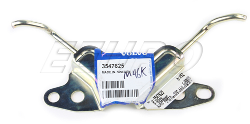

Looking further back the rear most tail pipe hanger bracket is almost ready
to fall off due to rust. Going to look for a replacement on ebay.
The rest of the exhaust system looks to be in very good shape.
Found this on ebay, but also need the bracket bolted to the chassis:
