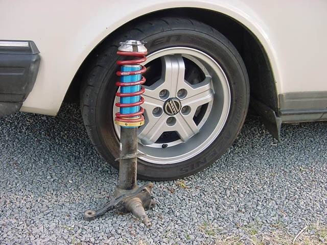

Martin_Frydenbo wrote: 24 Sep 2017, 07:34 And no, I dont want adjustable suspension, and no, I dont want it any lower than 15mm :wink:
You will not find what you're looking for until you go full adjustable coilover. No one sells 15mm shorter springs. There is no way I would trust some rumor that some 20 year old suspension springs are slightly shorter original spec. Plus, springs wear out and get shorter, ask anyone with a saggy rear end springs.
So, used unknown factory springs, new aftermarket springs with 1.5-2 inch drop, or coilover with adjustable are your real choices.
