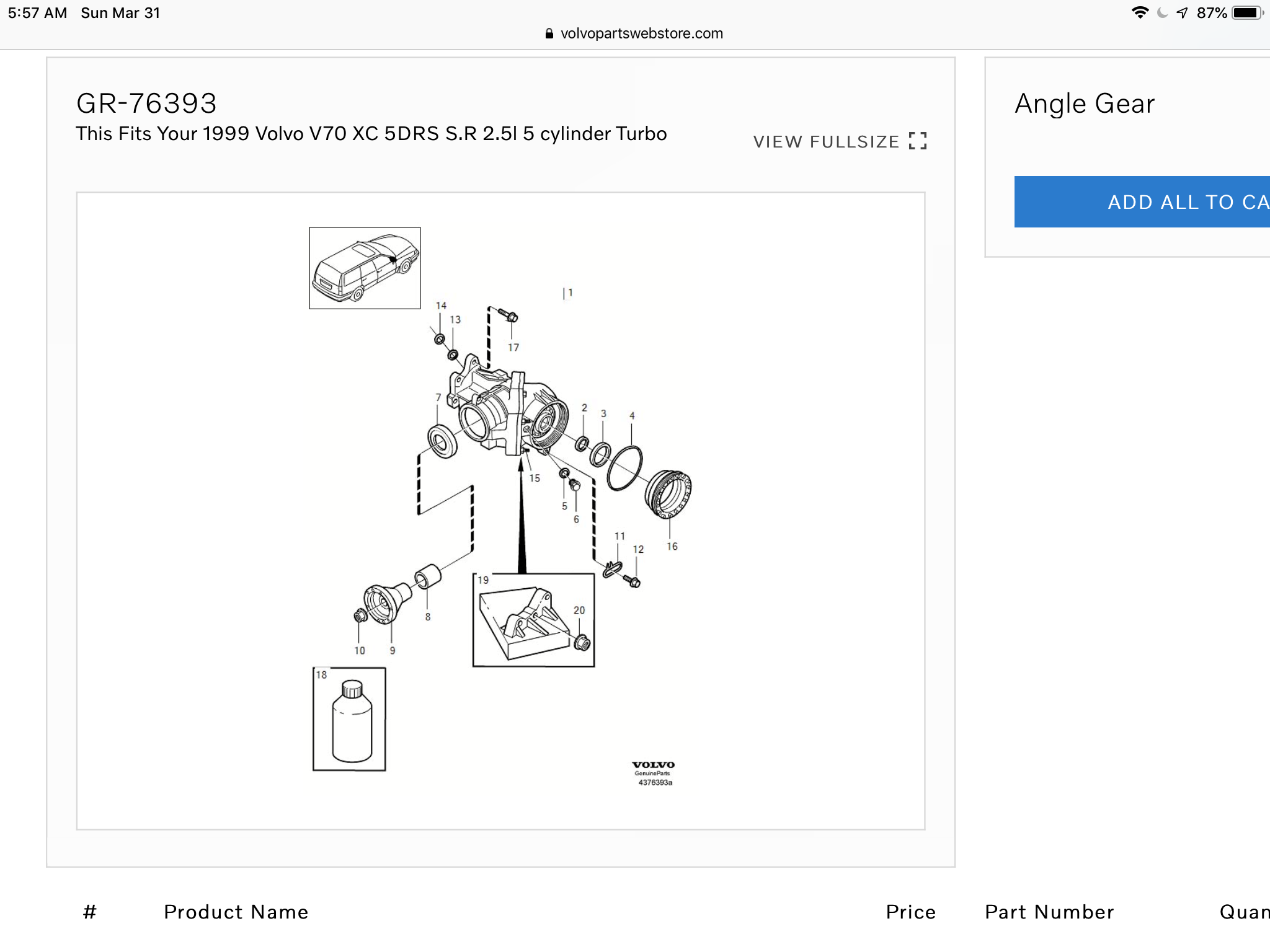

After you have nicely removed the two bolts, taken of the cover to look for the third, with your mirror and flashlight you will find the third lurking blindly up top, accessible blind with a short stub and a wobble M8
Or, just look at the diagram, which only shows one bolt ( the bitch bolt)
Have fun with this..8/10 on the PITA scale

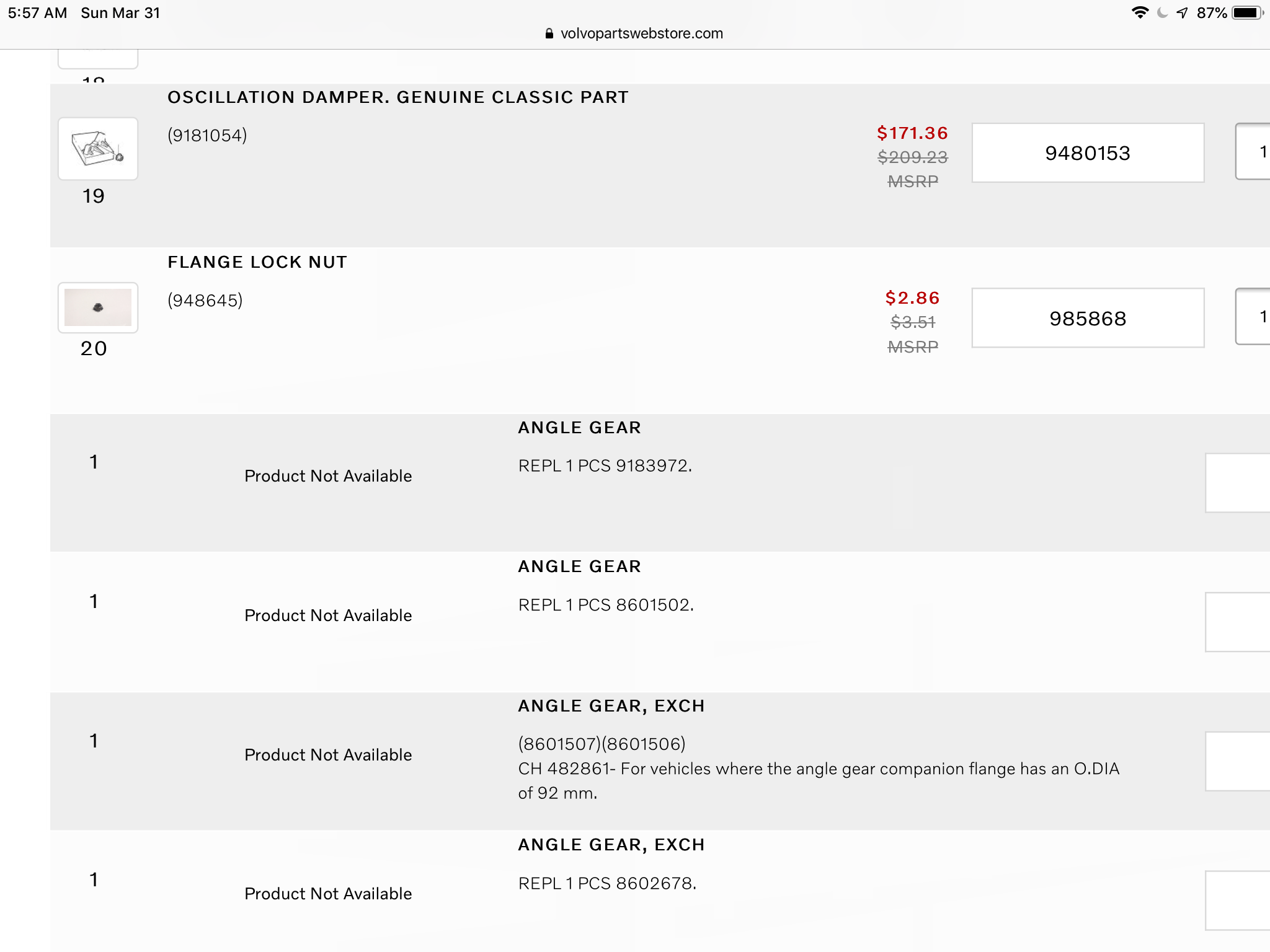

Three bolts part 20
Part 19 is the damper...basically a box full of potted rubber
