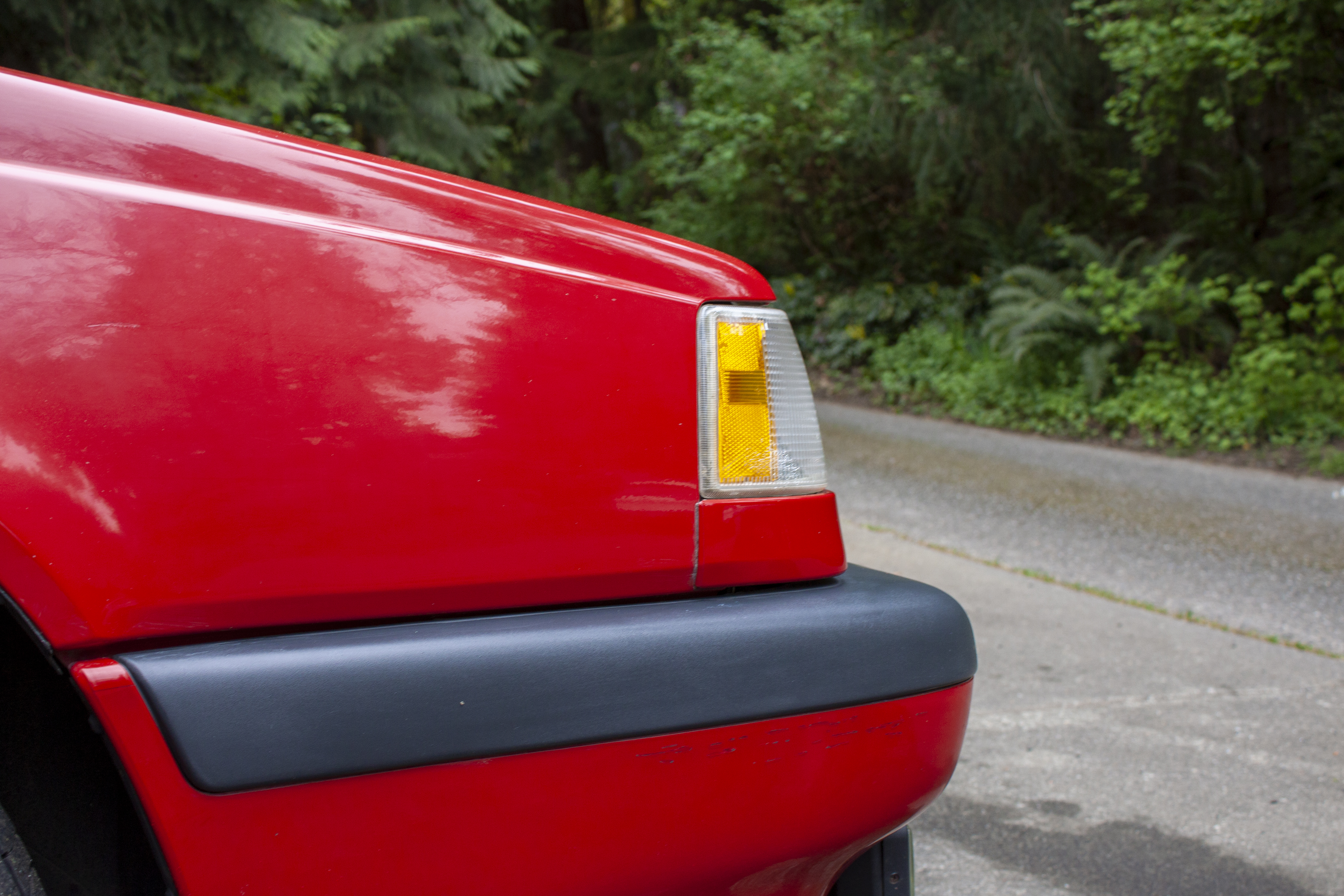

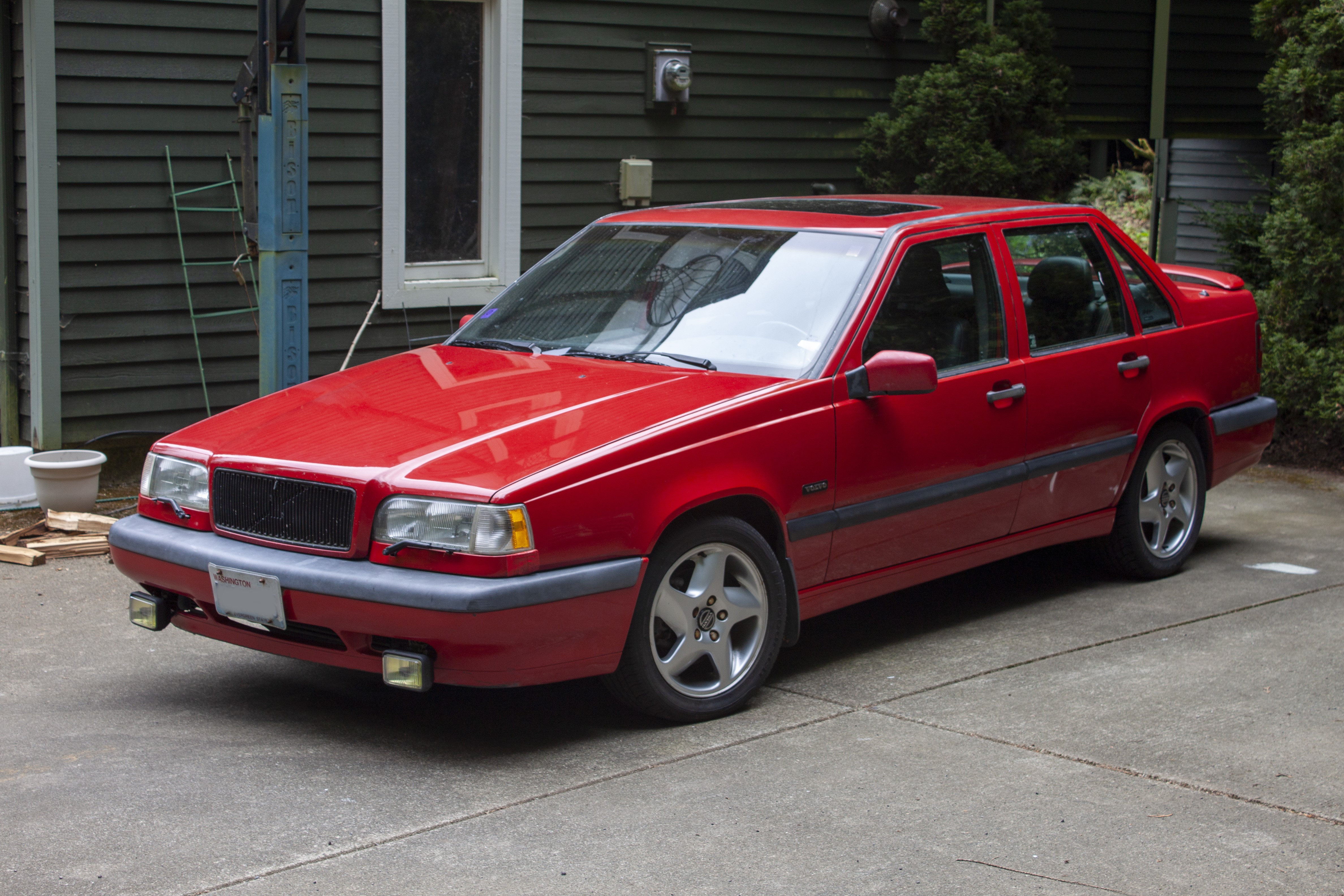

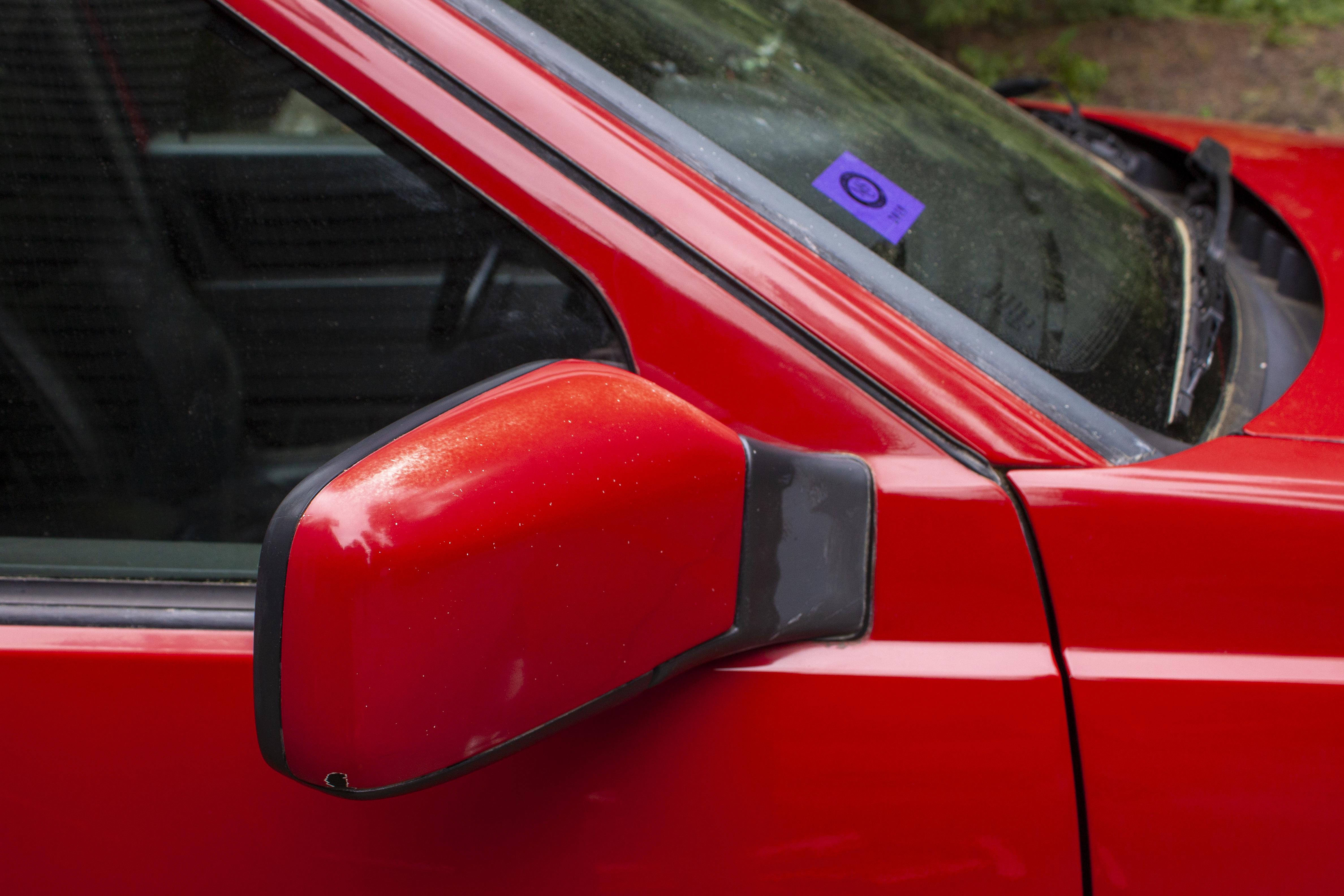

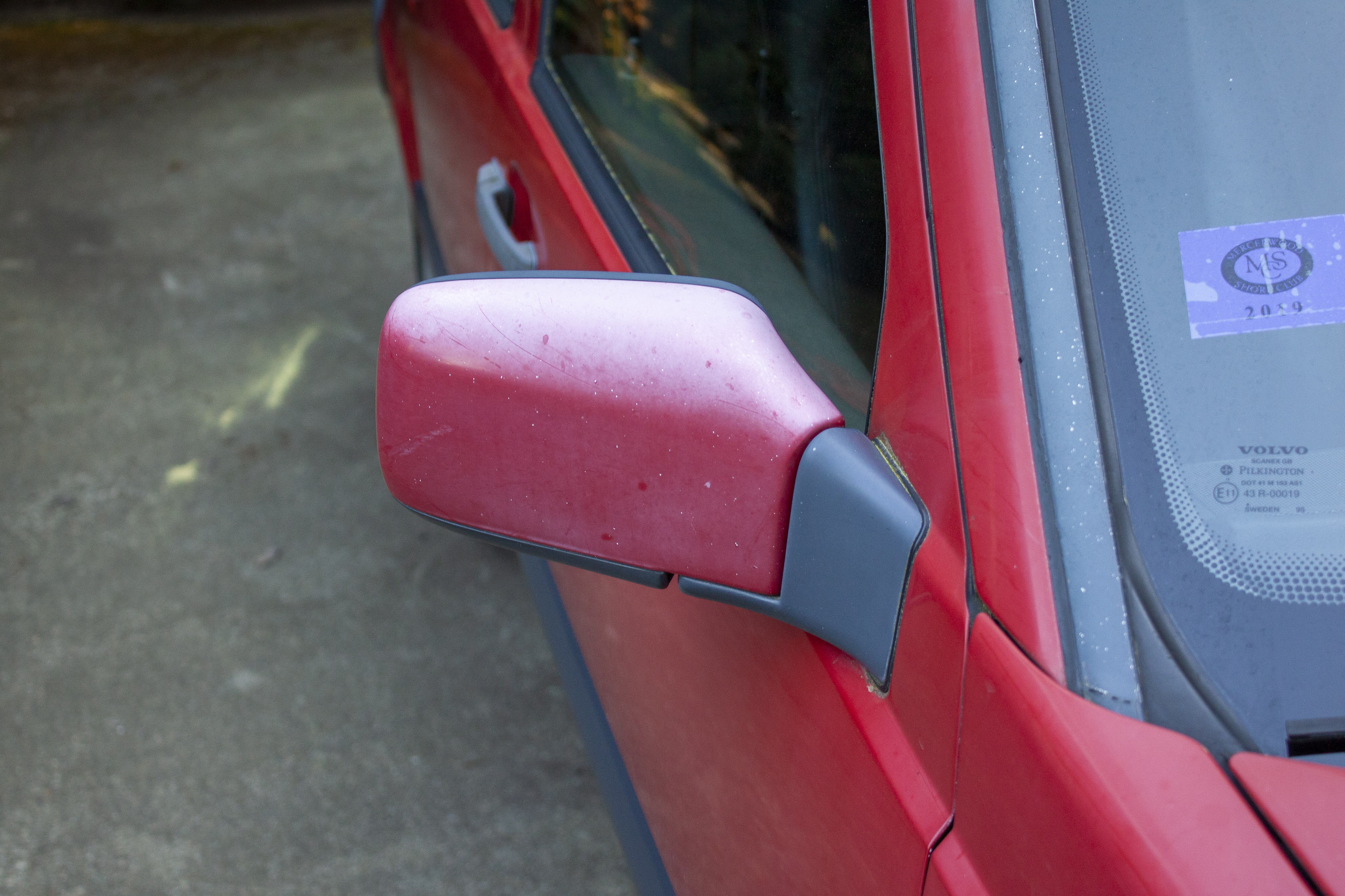

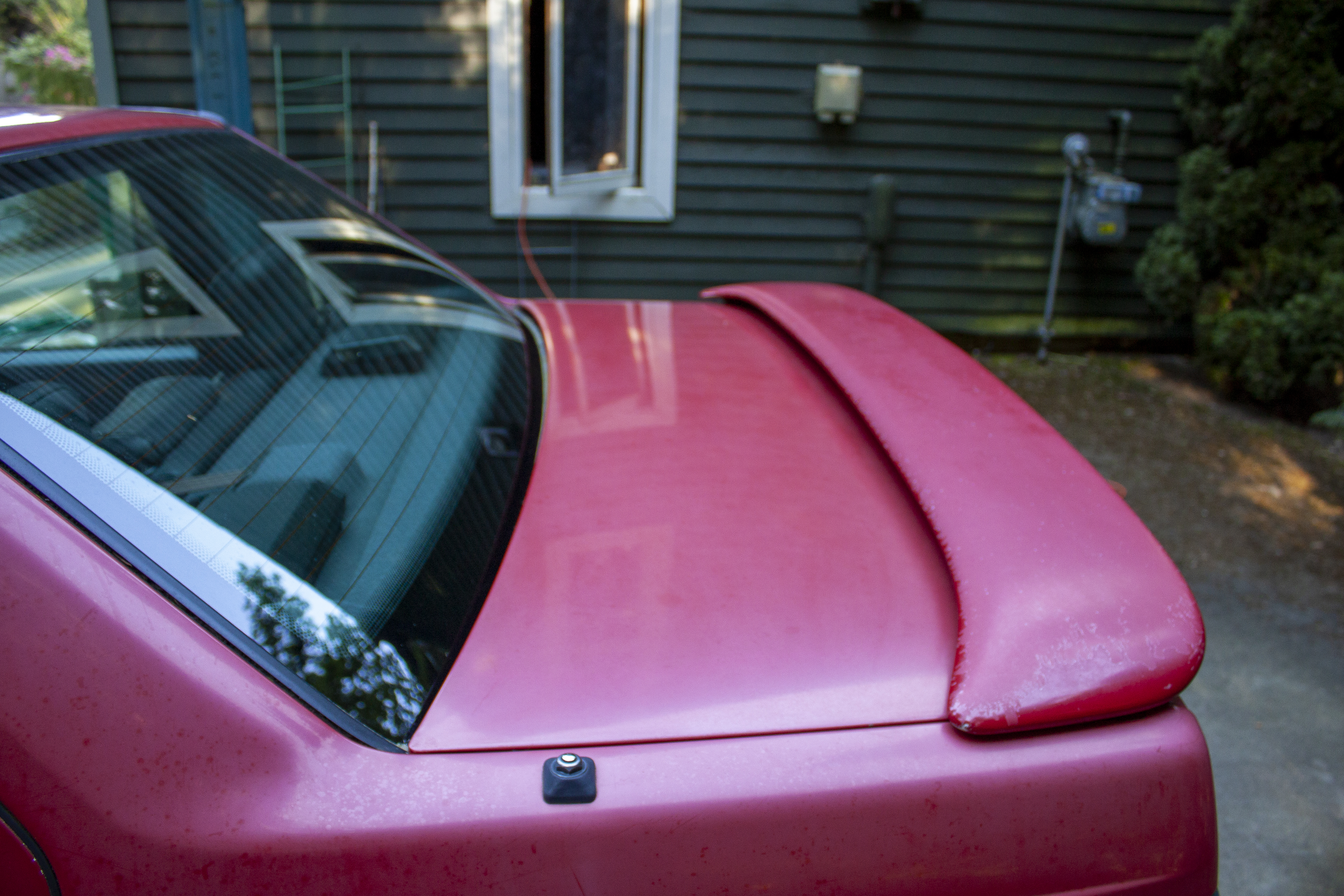

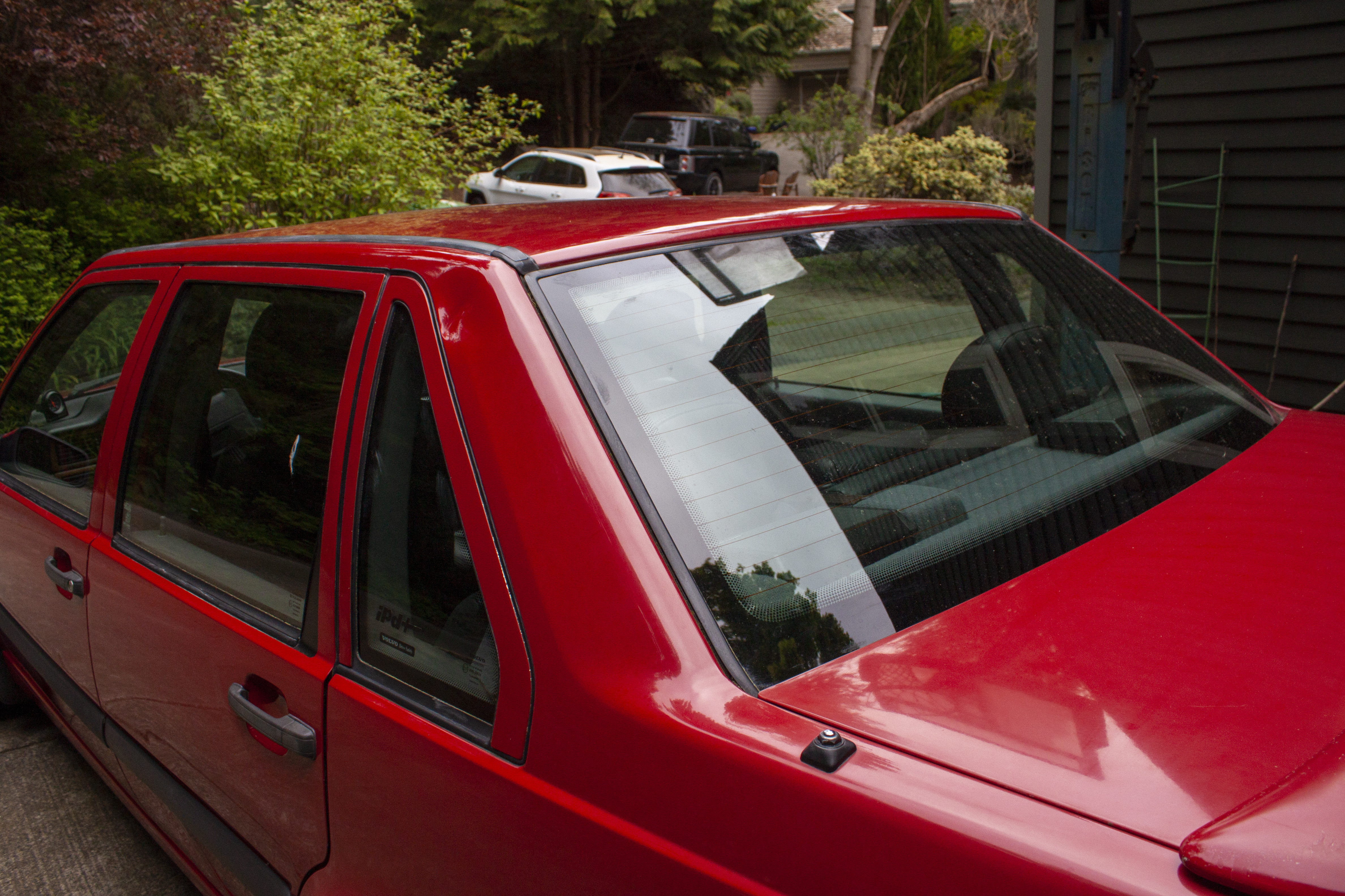

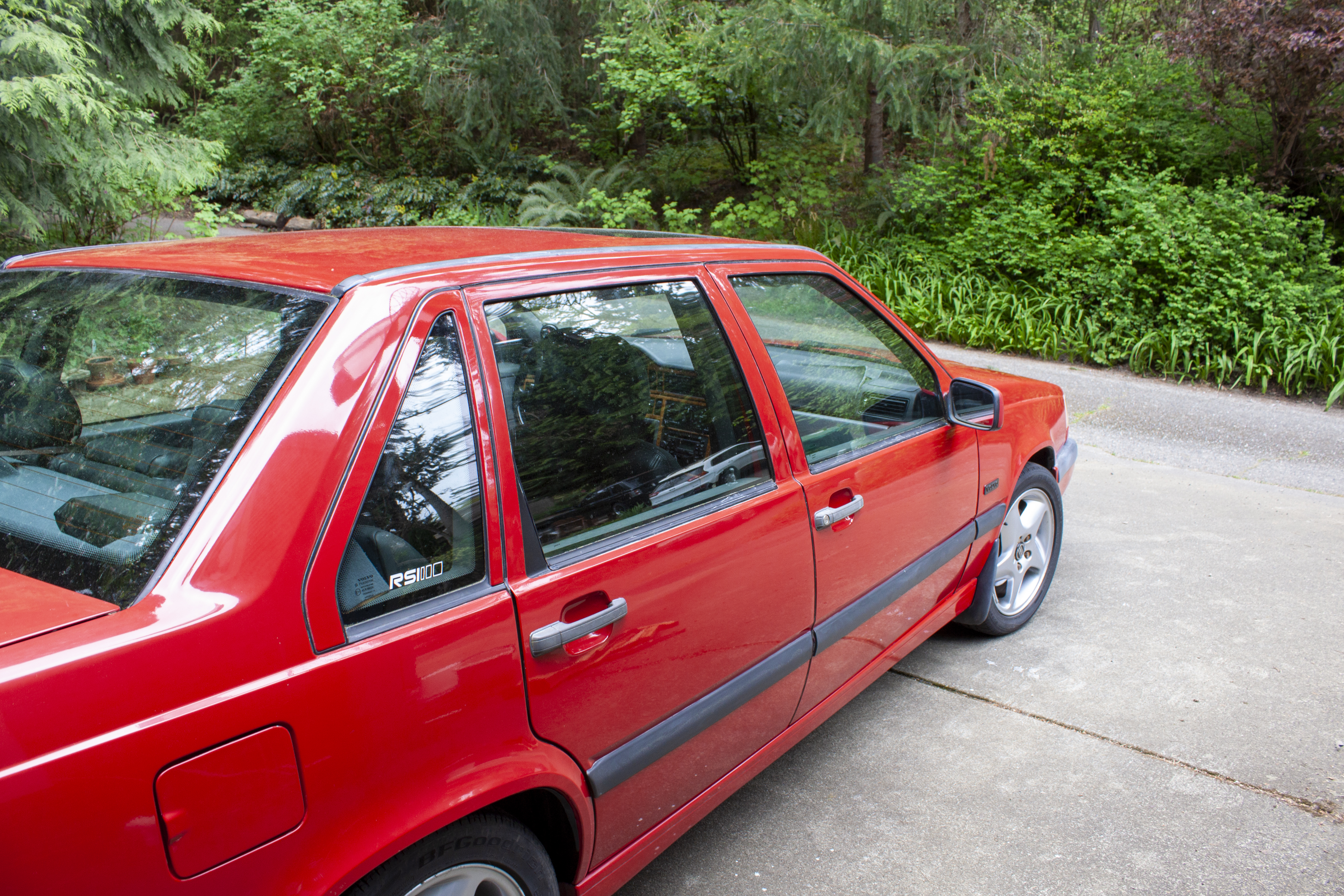

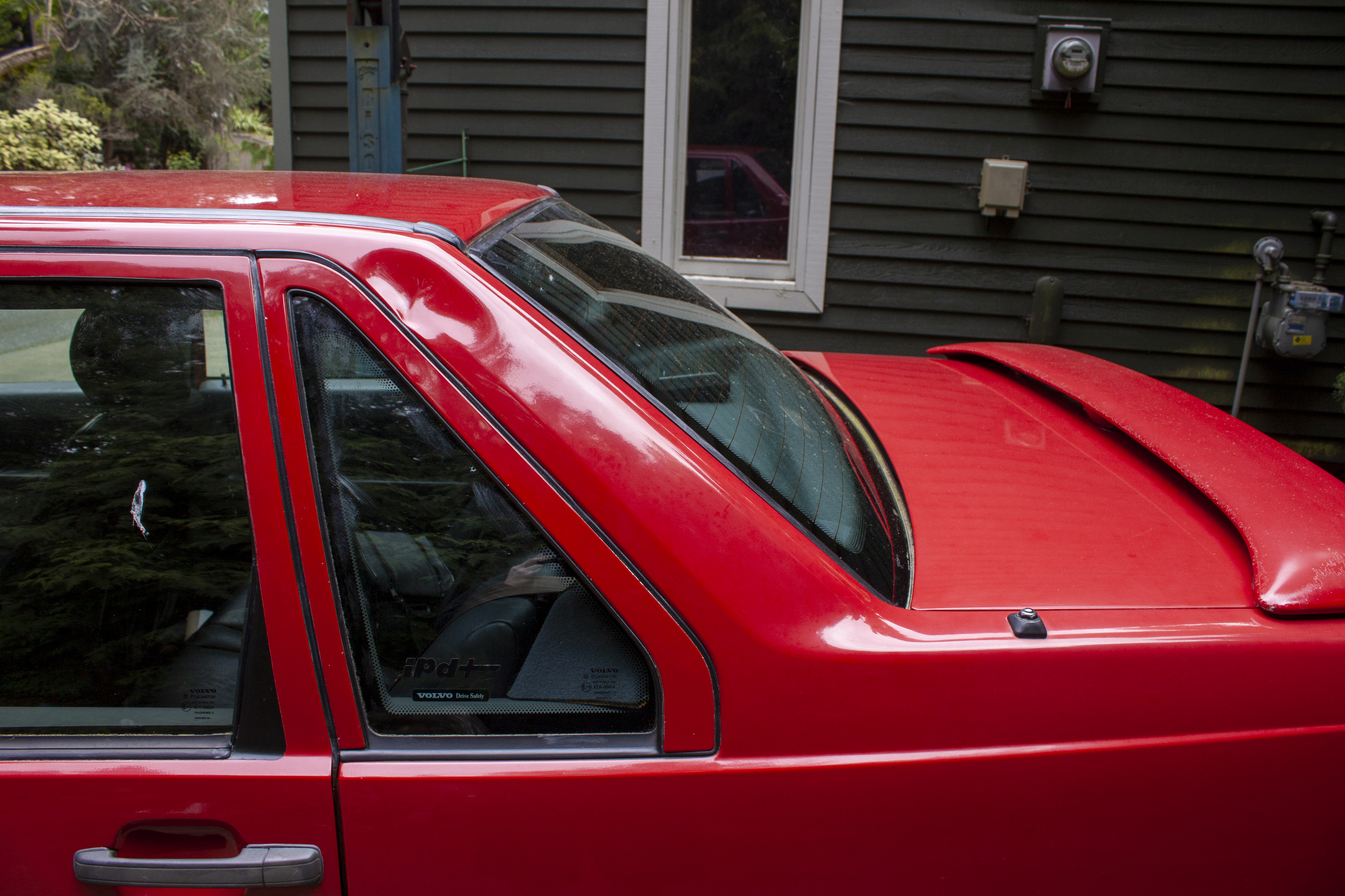

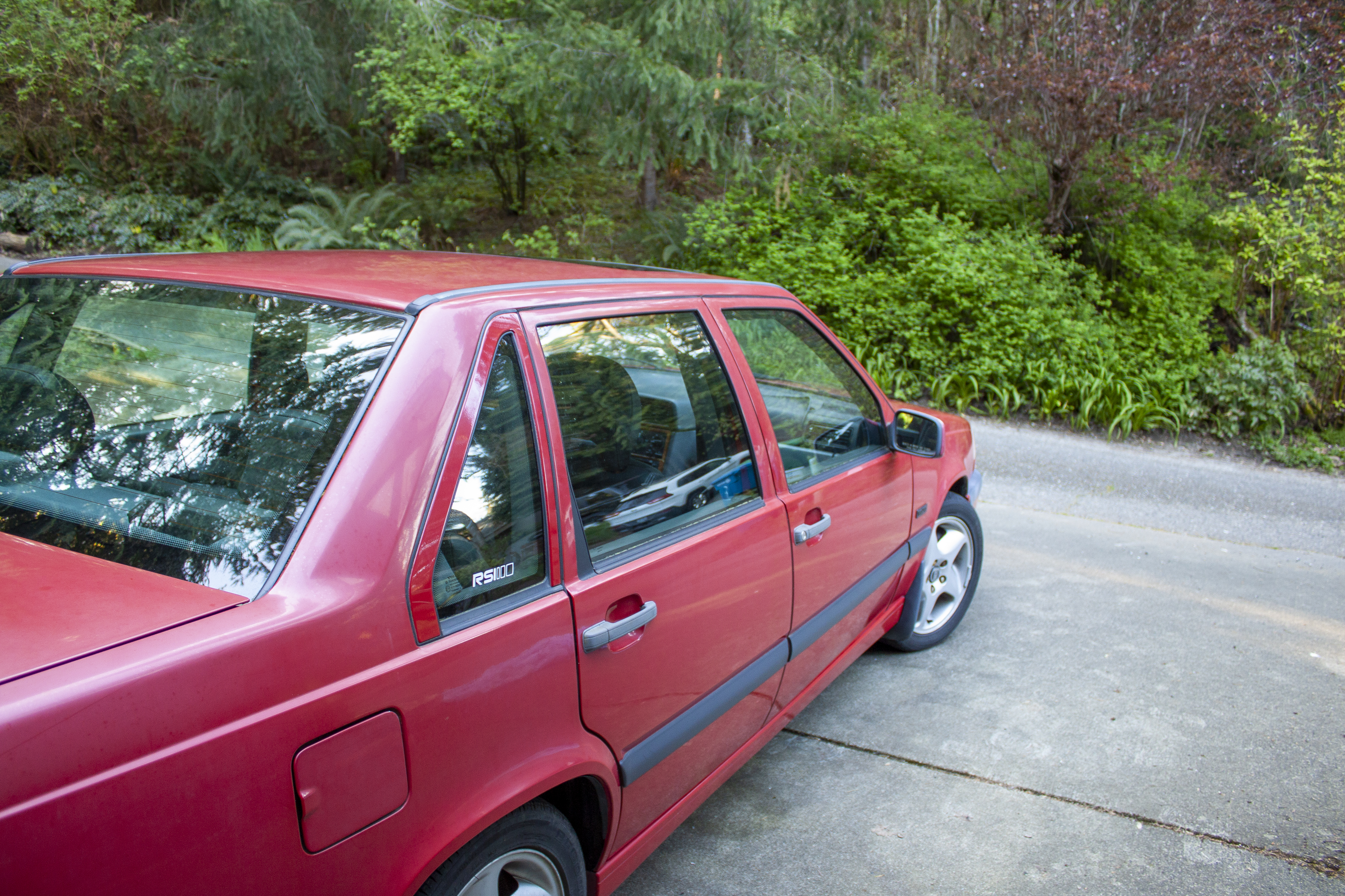

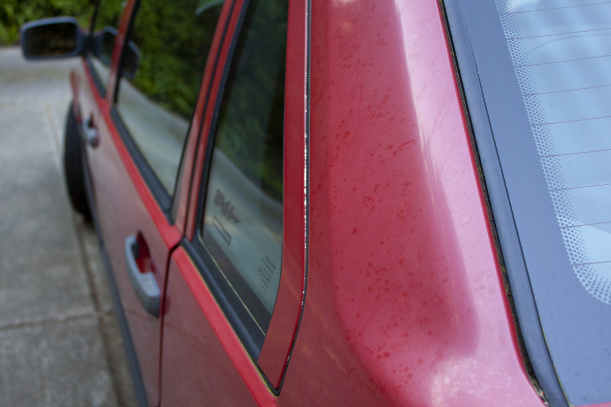

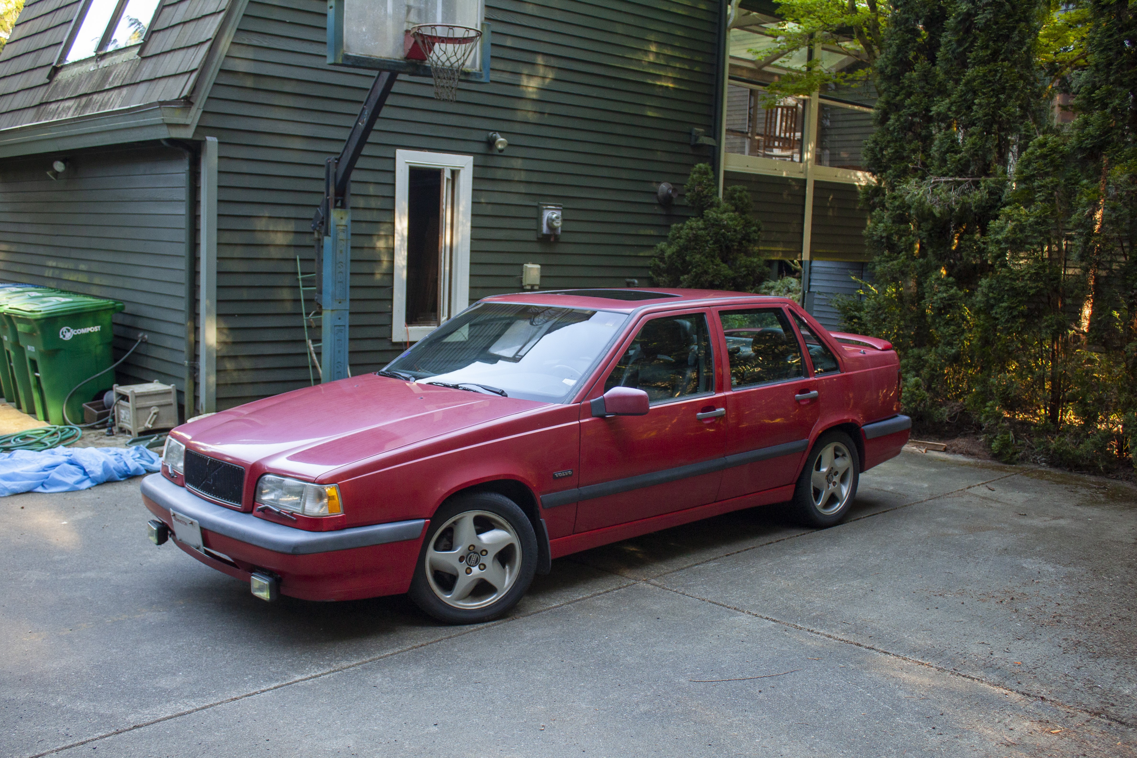

First, some before and after pictures (some of the after shots are before I applied the trim restorer):
As you can see, before the paint is totally oxidized, tons of water spots, just plain ugly. After, the paint has regained its darker red tones, the reflections are crisper, and the water spots are mostly gone. One of the most impressive shots to me is the C-pillar, which before had horrible water spotting and after has none. The paint looks a lot better in real life than it does in the pictures, too, I couldn't quite get the settings dialed in on my camera and was running out of daylight. Anyway, the transformation was incredible overall, and a few neighbors stopped to ask me if it was actually the same car.
Now for what I did. The tutorials linked above all follow the same basic progression of washing the car to remove dirt, using a clay bar to remove more embedded contaminants (brake dust, etc...), polishing to remove oxidation (optional), soaking with Meguiar's #7 Show Car Glaze (this is where the magic happens), then applying paste wax to seal the paint. For each step, just follow the instructions that come with the product. Step 4 deviates from the instructions a bit since you leave the product on the paint for 12-24 hours, but otherwise it's basically the same as what it says to do on the box.
1. Washed with a wash mitt and generic auto soap.
2. Cleaned with Meguiar's Clay Bar Kit. I had read somewhere online that a clay bar removes oxidation, so I was disappointed when the paint looked the same after this step. It will feel smoother, but don't worry if it doesn't look any different. The magic happens a bit later but this step is important to prepare the paint.
3. In the Hemmings tutorial, they recommend skipping the polishing step if you are unsure of the paint's overall condition. I did an experiment, polishing the hood with Turtle Wax Cleaner Compound before soaking with #7 in step 4, and on the roof just skipping the polish and going straight to step 4. In the end, I couldn't tell a difference in the results after step 4, and polishing is a ton of work, so for the rest of the car I just skipped the polishing. For me it wasn't worth all the extra work since I couldn't see any difference.
4. Applied a generous layer of Meguiar's #7 Show Car Glaze. This basically has a bunch of oils that soak back into the paint and return the color. I left it on for about 18 hours and then buffed off with a microfiber cloth. You'll be amazed at the results, it completely erases oxidation and water spotting. Seriously, this stuff is a miracle. I soaked the mirrors two times with very heavy coats because they were so horribly oxidized. They look a bit better but I think their plastic just doesn't age well.
5. Waxed with Turtle Wax Paste Wax. (I know Turtle Wax gets a lot of crap, but it's what I had laying around and it looks fine).
6. (Optional) I used Turtle Wax Trim Restorer on the bumpers, side trim pieces, and door handles.
I can't reiterate how much of a difference this all made to the car's overall appearance. It did take a lot of time, but you absolutely don't need to settle for a faded pink car! Happy to answer any questions about the process if anyone else is trying to take advantage of this downtime to get their paint sorted :D

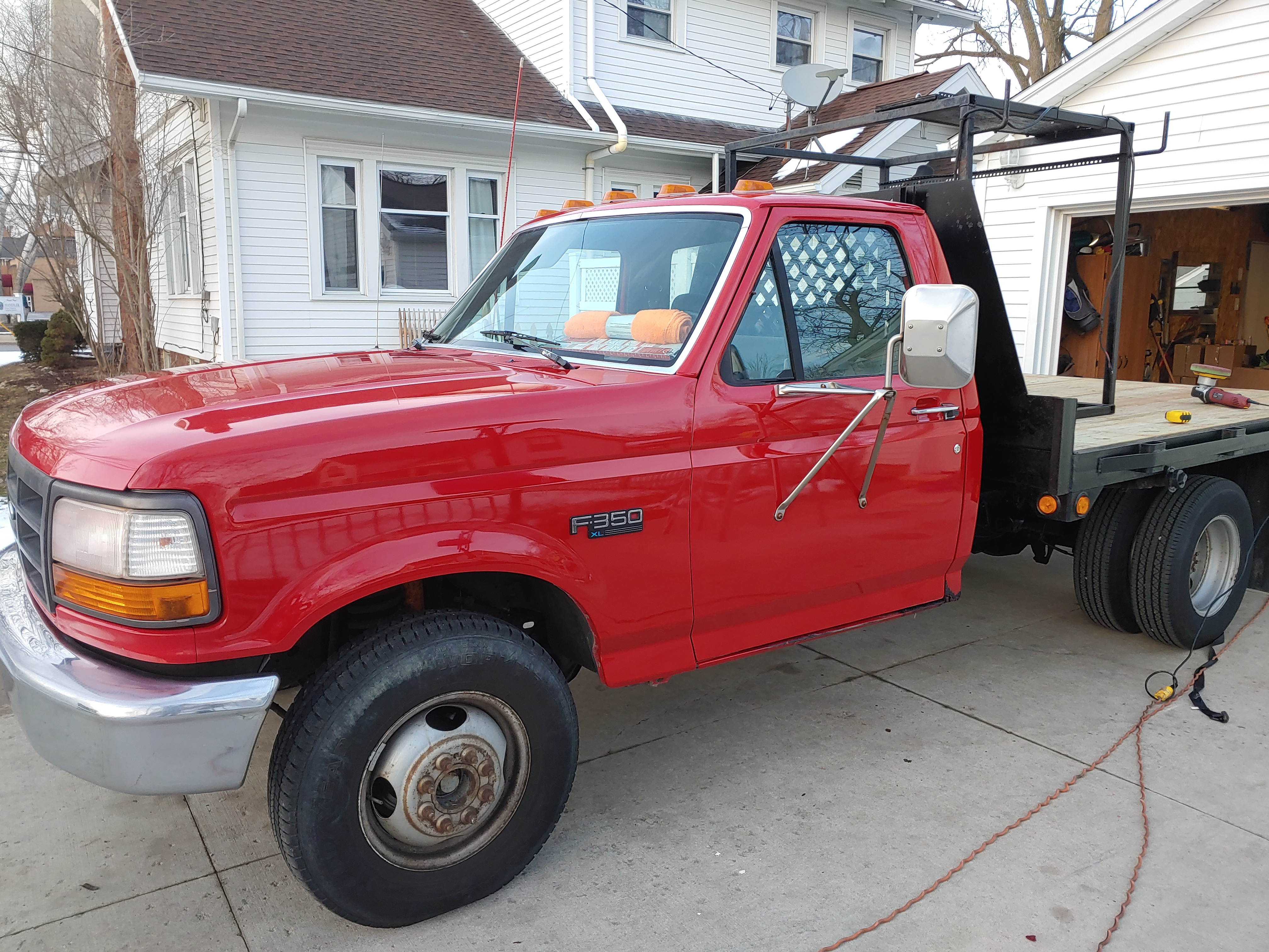

I bought a 93 f-350 last winter that had never seen wax or a car wash, same single stage paint and oxidized. I didn't clay, I only used meguiars ultimate compound, applied with a DA and waxed it. I did it in the beginning of March and only had one warm day to do it . Should have clayed it, but didn't.

Matty Moo wrote: 22 Apr 2020, 17:50 I bought a 93 f-350 last winter that had never seen wax or a car wash, same single stage paint and oxidized. I didn't clay, I only used meguiars ultimate compound, applied with a DA and waxed it. I did it in the beginning of March and only had one warm day to do it . Should have clayed it, but didn't.
The bed looks new also besides the truck. Paint is showroom condition. The interesting thing is single stage shines nicely but late model cars look better with a clear coat as it give depth. Perhaps we have been train over the years so can't mix and match what we are use to in terms of single stage and clear coated paint.

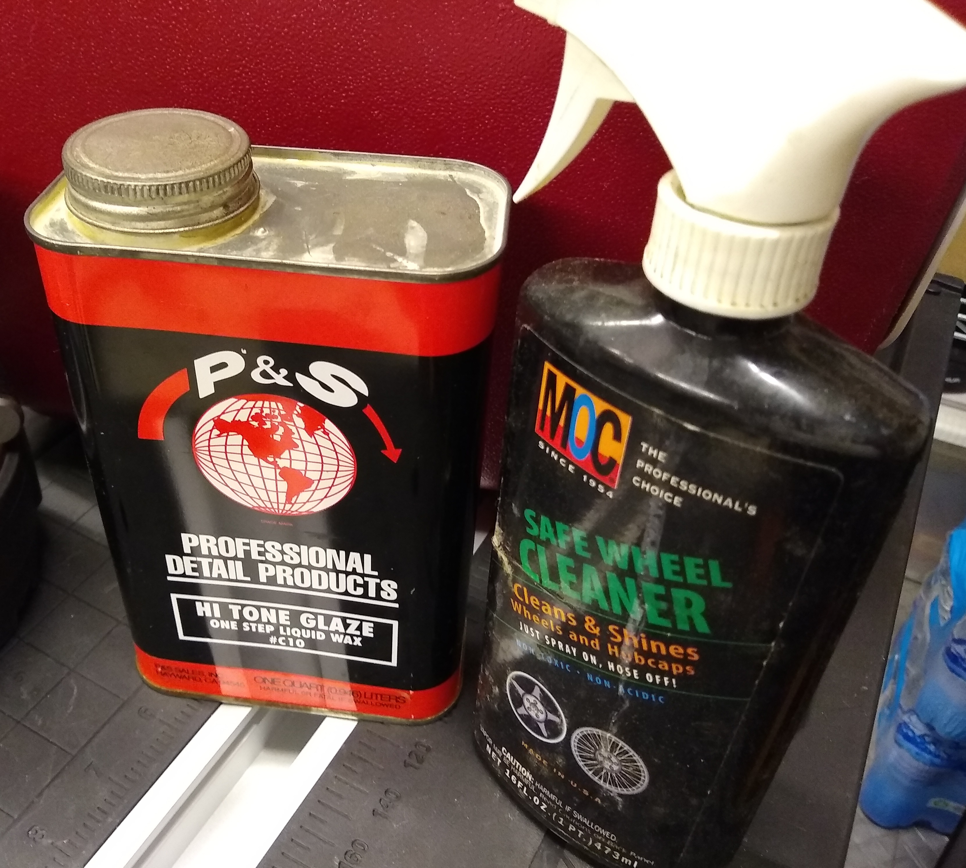

Just found a full tin of Hi-Tone which my brother gave me 4 years ago. He probably had it for over 10 years and barely used it. Will see how it works along with the wheel cleaner on the 08 C30 and a 2010 P71 Interceptor this weekend
The flatbed had no wood on it, no lights and was all rust. The trucks frame was rusty also. I wire wheeled it, sprayed rust converter, painted it then wired it up and installed all new led. Lights. . Putting on new wood was the worst part. I paid 2k for it, it has a 351w, 3 speed auto and 109k on it. With all of my pressure washing equipment bolted on and 200 gallons of water I get 8mpg. But, it's better than pulling a trailer and less likely to get stolen.
A great job making that look new and it'll definitely promote your business. I use to have a 78 Cougar XR7 with the 351 Windsor. CAT delete, dual exhaust with glasspacked turbo mufflers. Exceptional metallic exhaust notes. Not too loud and sounded like it had Cams. Got probably around 13 mpg max but who counted those days.
