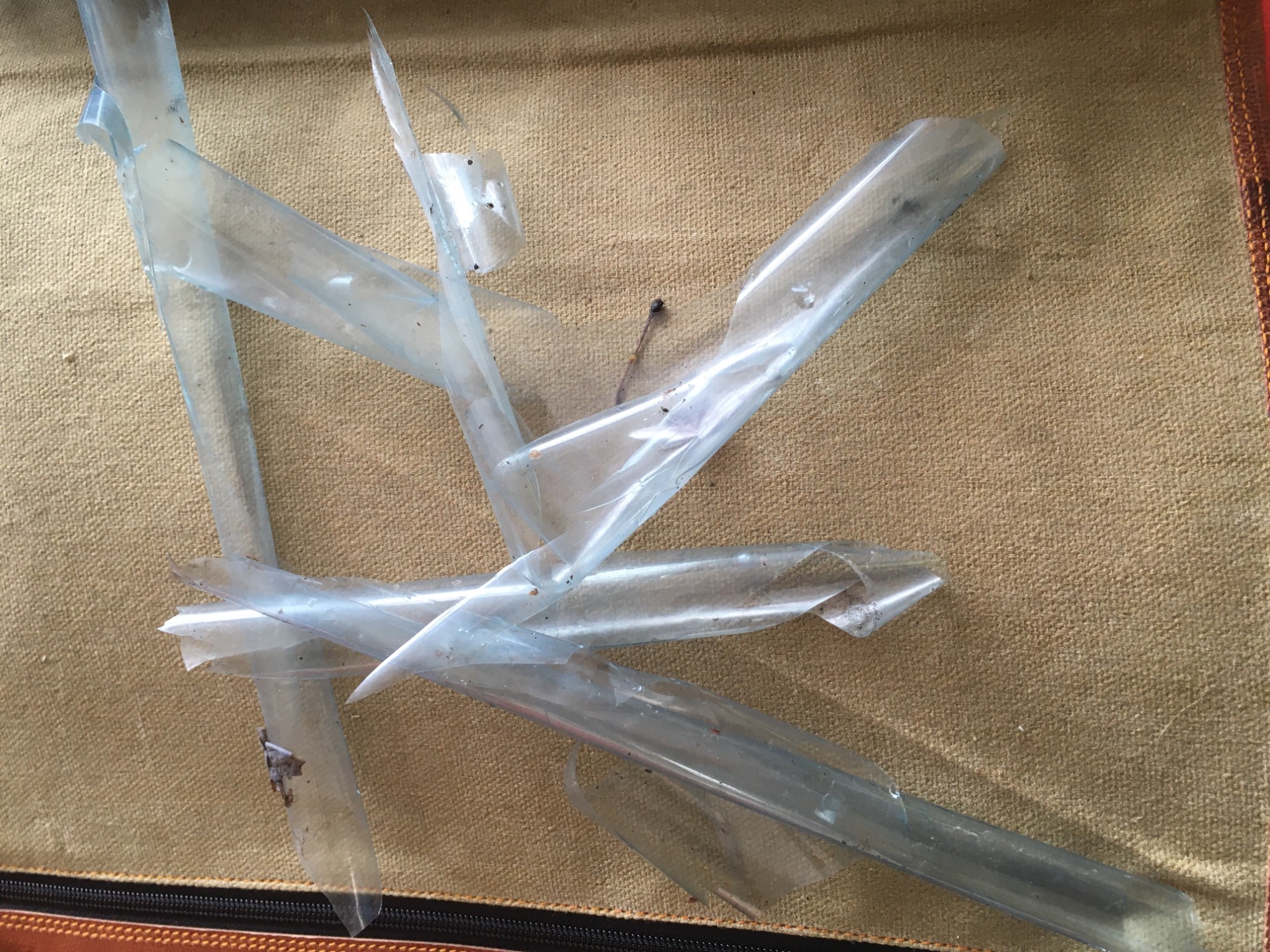

I have a 2001 Audi A4 wagon in a Santorin mica metallic. The clear on the roof started to craze last year and then came off in sheets like wax paper. Discouraging.

That is clear coat? Looks like some kind of 3M pain protector. Wow, I have never seen clear coat on a Volvo fail that way, guess it is due to living up north we don't get the same sun intensity.
Can you replace the clear coat only, or do you have to remove all the clear coat on that panel, re-base coat, then re-clear coat?

That was an Audi, 2001. Failed in a matter of months and the roof did that.scot850 wrote: 16 Jun 2023, 22:27 That is clear coat? Looks like some kind of 3M pain protector. Wow, I have never seen clear coat on a Volvo fail that way...
I was told by several people you can’t just sand it and do clear coat over the existing. It’s as wizechat describes above.

I didn't think so ass any sanding of the base coat shows through the clear. I found that on a car I had repaired after someone (the dealer's courtesy driver) backed into the car in their lot. They painted it and you could clearly see the sanding marks under the clear. I did think that maybe sanding the clear off and repainting over the original base coat and clearing might work. Sounds like not!
