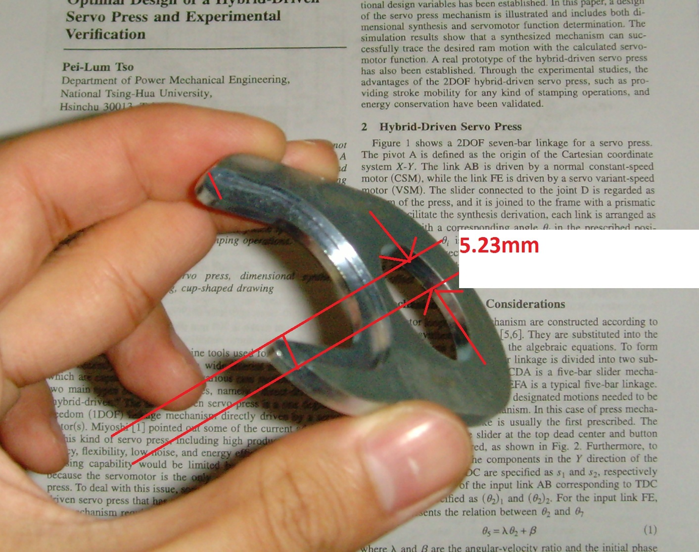

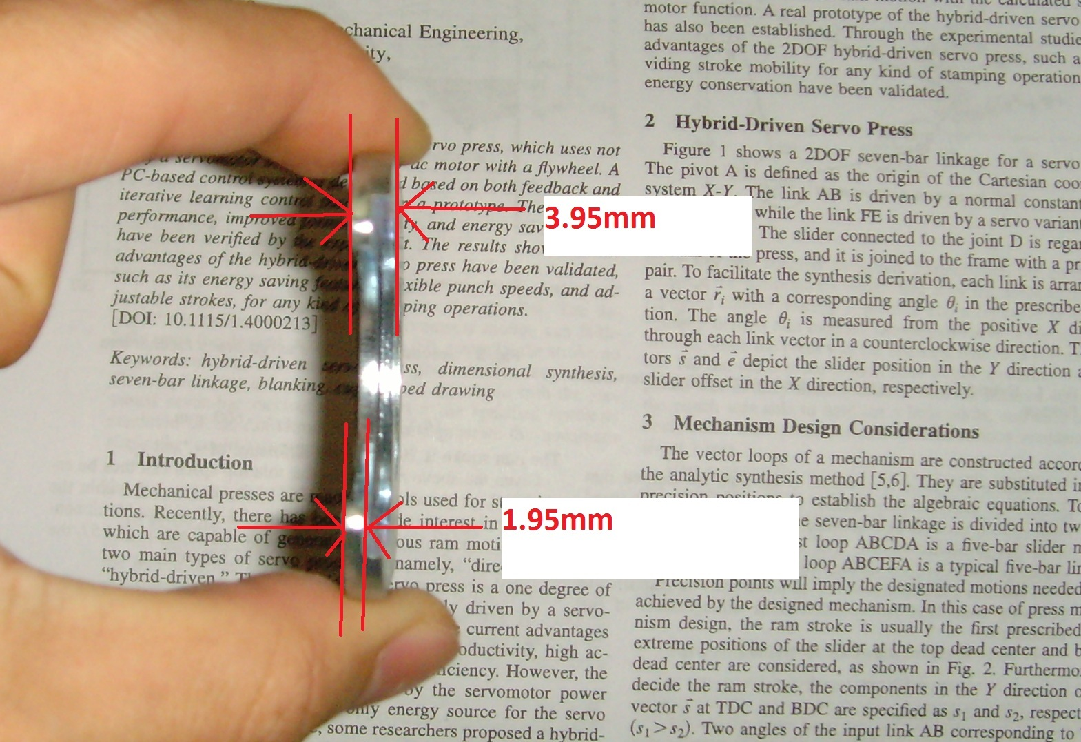

Hello,
Are dimensions for tool 9997248 still available (Roger_850T)?
Roger_850T
Posts: 351
Joined: 31 December 2013
Year and Model: 854T 1995
Location: Frederick MD
Been thanked: 26 times
Post by Roger_850T »
Hi tombras,
The tool is still available to purchase if you prefer. Here is one place that has it for $22.18:
https://www.volvospecialtools.com/index ... E0BBB66715
I think there are also European sources as well.
Here are the dimensions I have for the tool. (Not my photo, but I saved it for reference.)
I hope this is helpful for you!
Roger
