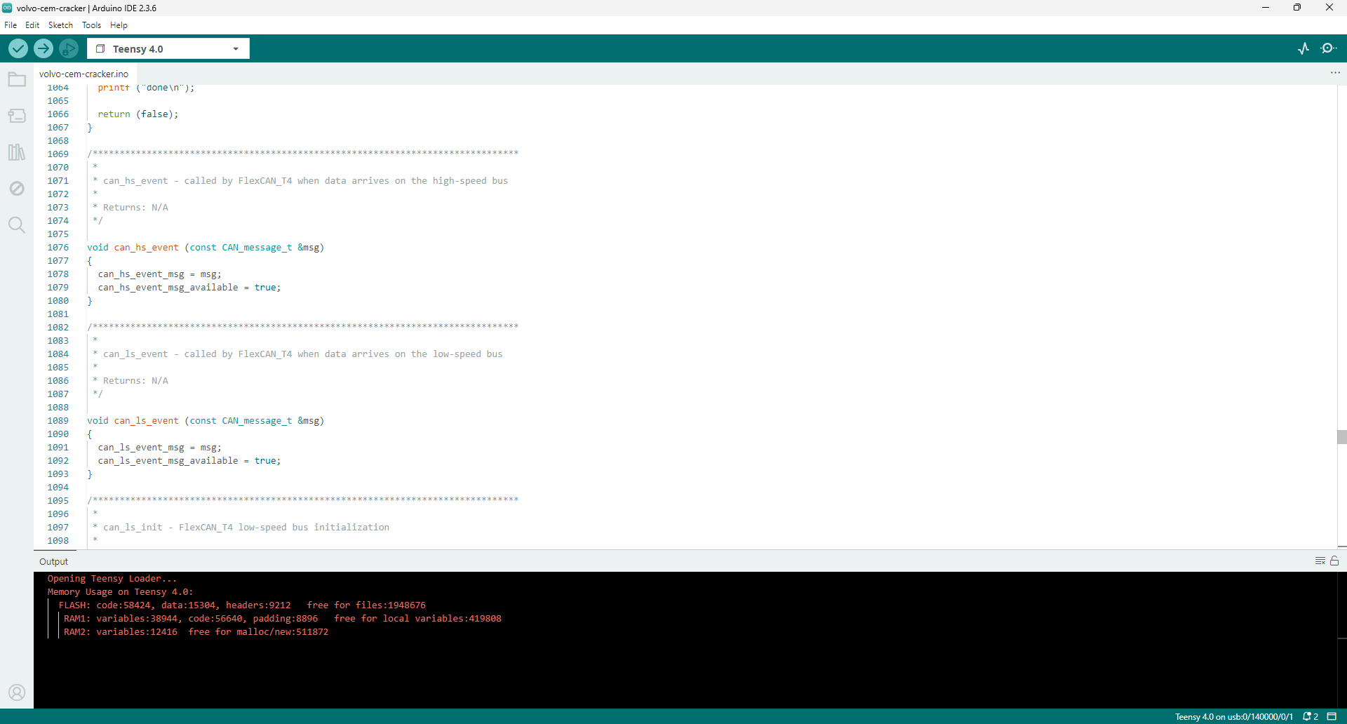

This is the furthest i get to, what could be the problem?

Post by vtl »
You should see a popup window with Teensy's programmer.

Post by Wembe »
vtl wrote: 04 Nov 2025, 08:06 You should see a popup window with Teensy's programmer.
I do as below

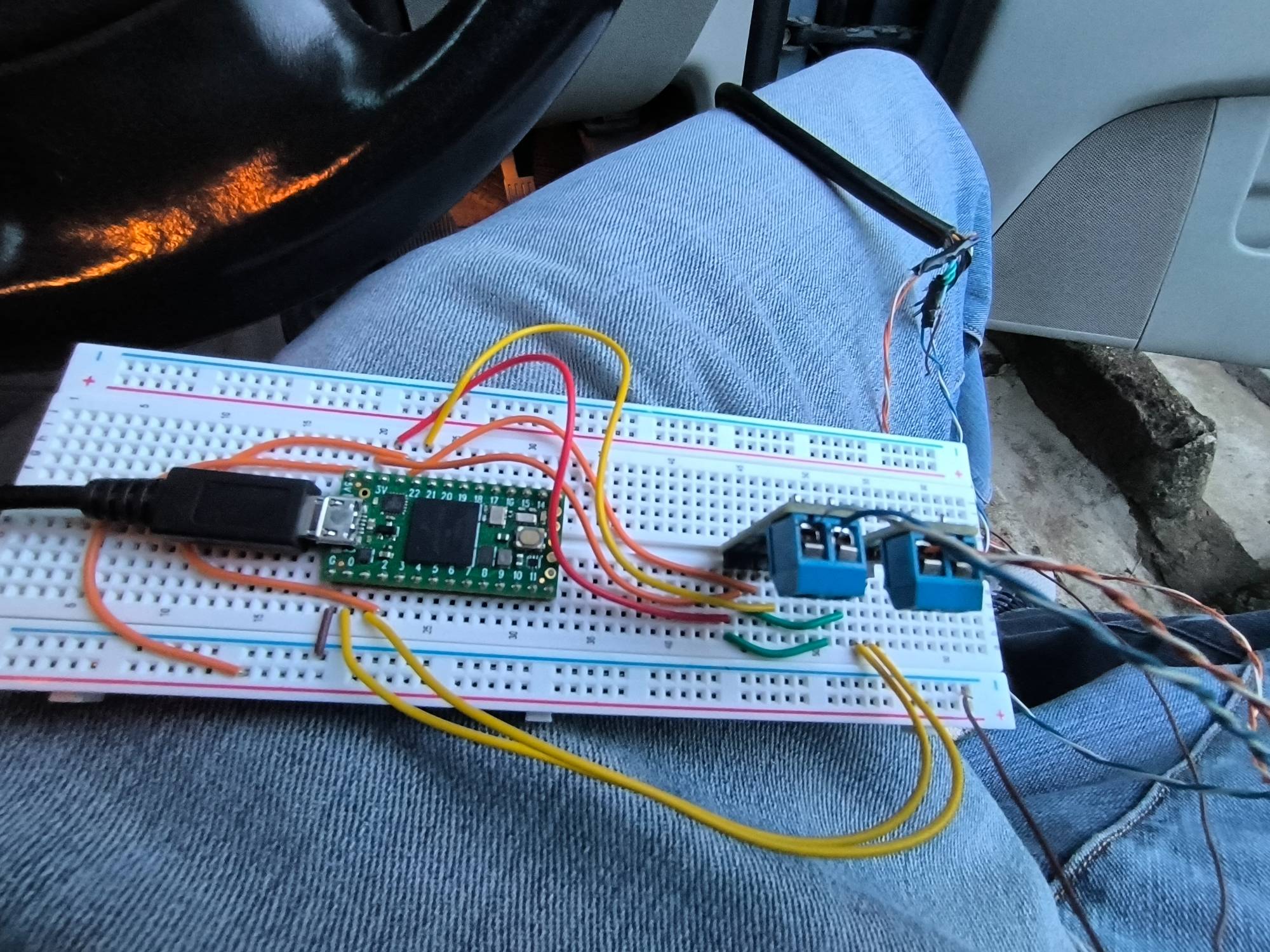

Post by vtl »
Wembe wrote: 04 Nov 2025, 08:13 I do as below
Show a picture of your hardware.

Post by Wembe »
vtl wrote: 04 Nov 2025, 08:19
