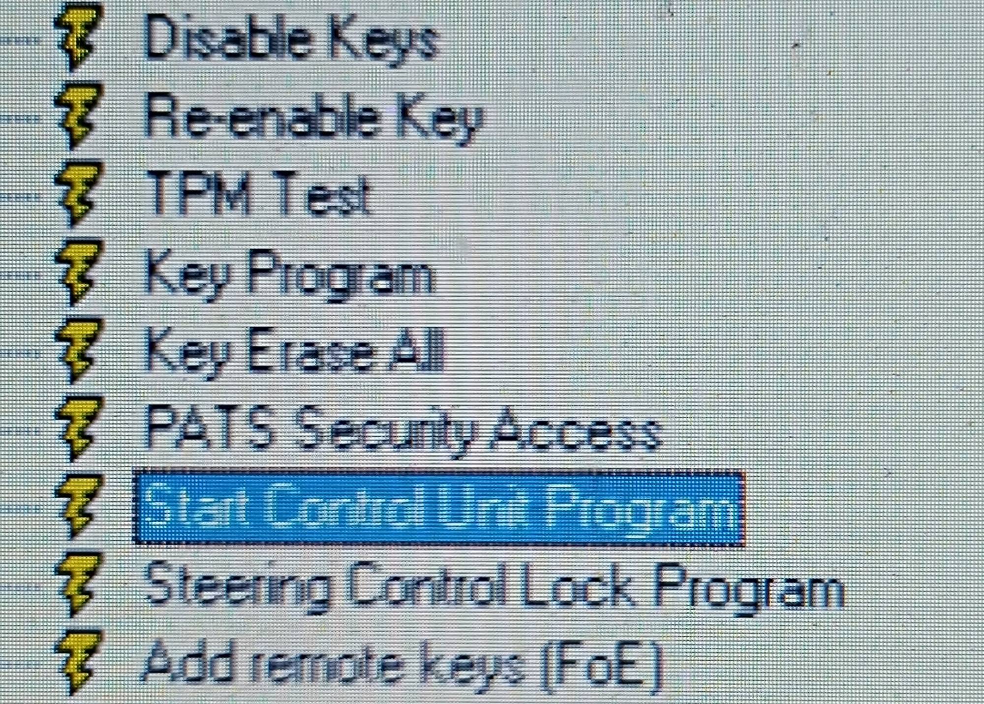

In Vdash I see this one -
Preconditions
IMMO code must present - for P3 cars it is automatically decoded when CEM PIN is present or successfully decoded.
The SCU / SCL unit must be new virgin (blue box), used SCU / SCL from another car can't be used.
Procedure
Ignition must be OFF and car keys out of original SCU.
Plug in new SCU / SCL and insert key.
Plug in J2534 device and start up Vdash.
Connect the car and ignore the warning about the key position.
Start the SCU / SCL pairing.
