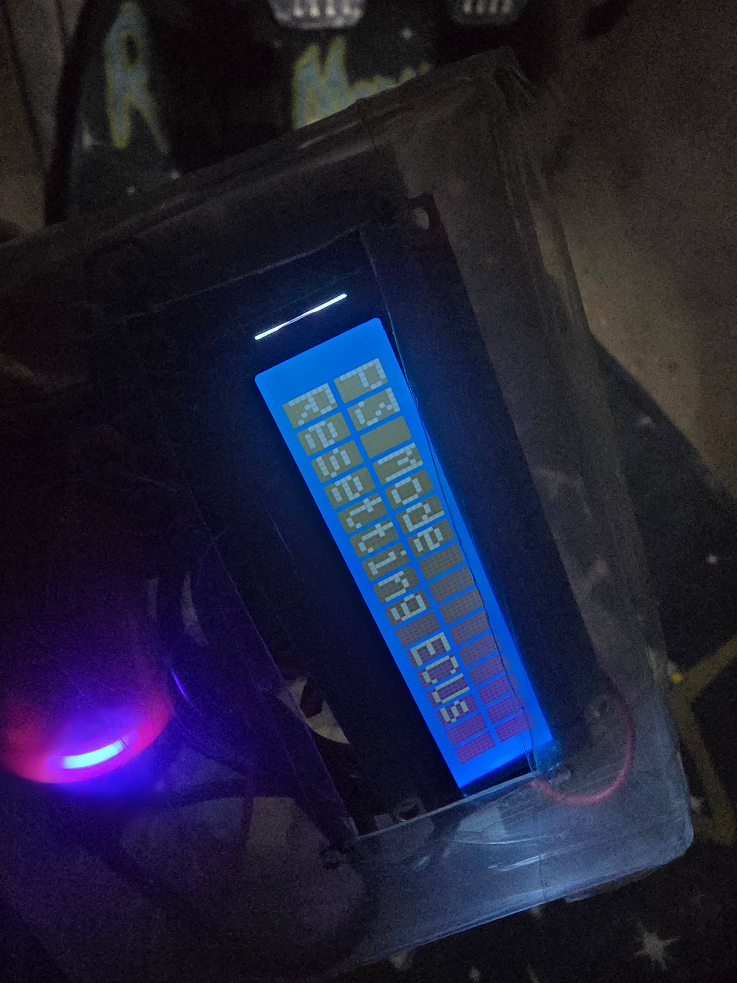

I managed to integrate the lcd display to P3 code and got the device to (hopefully) read the pin in under 7 hours on a car it took 18 hours on p3tool.
Only problem i faced was that the screen was left i "P3 resetting all ecus"
I Will try to solve this issue and share the code for P3 stand-alone operation to the creator 😇
Is there a way to extract the found pin from latest session, so i could verify the found pin was correct?

ghettob wrote: 16 Jan 2026, 23:23 I managed to integrate the lcd display to P3 code and got the device to (hopefully) read the pin in under 7 hours on a car it took 18 hours on p3tool.
This line prints the pin: https://github.com/vtl/volvo-cem-cracke ... .ino#L1169
Perhaps the cracker needs to read address where the real pin is located and print the real pin instead of hash collision.
